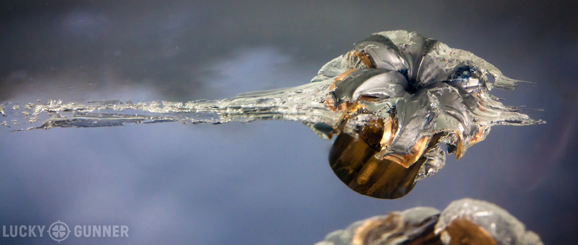

Here's a really cool page by Lucky Gunner that tested and compared various loads. They are presented in a nice interactive chart. Interestingly, it would appear the standard load HST 124-gr is an excellent performer, as is the HST 147-gr. The 124-gr rounds hovered near the >18" over-penetration boundary. The 147-gr rounds were pretty much square in the 12"-18" Goldilocks penetration zone.
It would also appear that the standard loads perform better than the +P loads in the HST rounds, with the +P loads over-penetrating.
To see all the loads tested:
