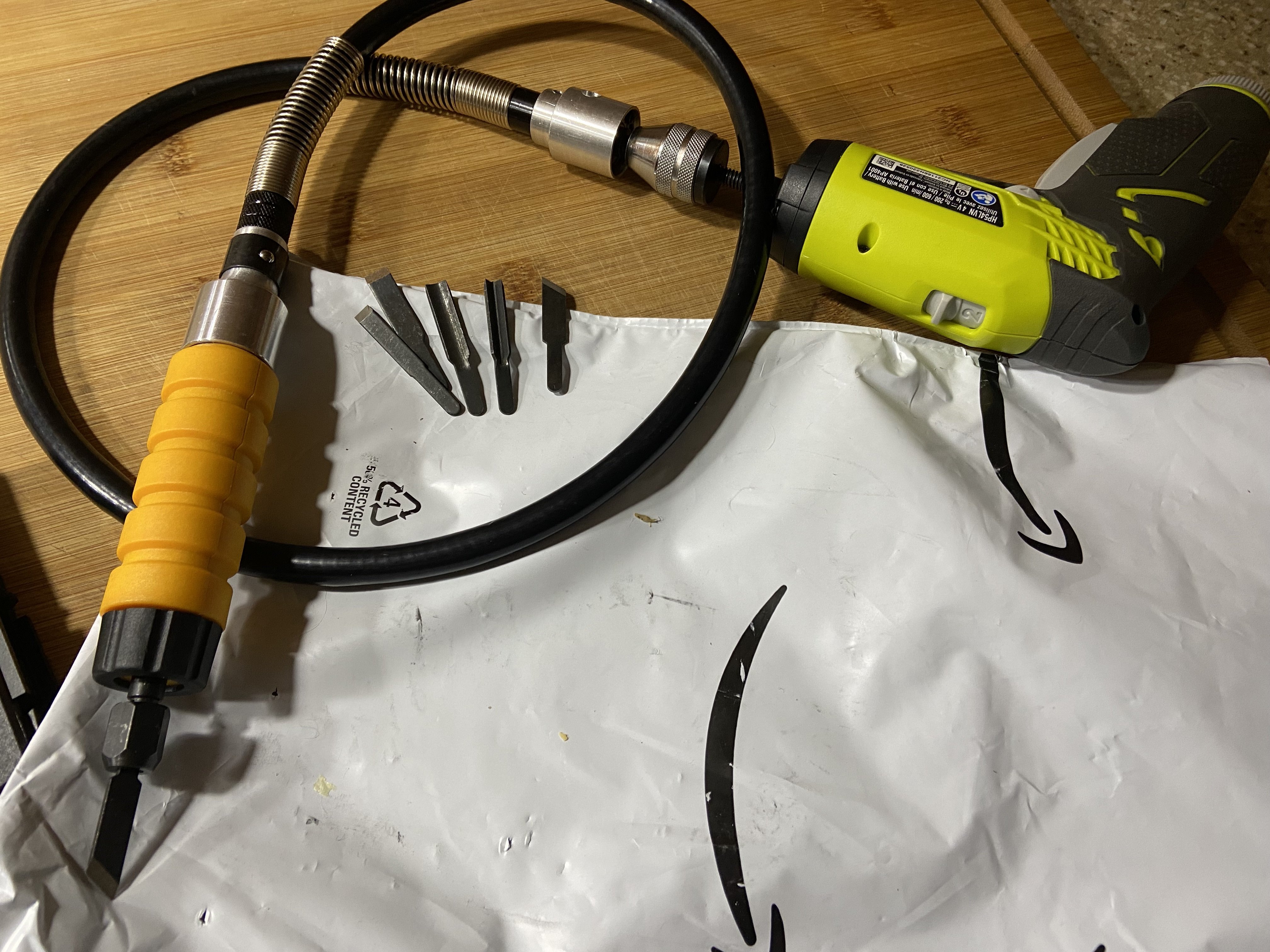

Electric wood carving chisel - another piece of cheap china junk. I returned the 1st one it was bound/frozen and wouldn't work. Getting another today. Only good thing I have to say about this tool is it's a one day ship. Hoping this next one works. Does not work with the Dremel as the fitting is too large. Chuck it up in a drill.
This chisel tool oscillates. Im hoping the vibration will cut through the polymer. There are 2 flat blades the small one fits nicely in the pockets the large at the rear rail area.
Ill post up more as I get on this. 🎉
OK here's the chisel. It didn't work much better than the 1st one. Took em both apart swapped parts and have this one working now. There's a cam inside that converts spinning motion to oscillation.
This drill works ok but will try an electric harbor freight with higher torque to see if it's better. So far.., using this drill to power this chisel, its slow going. Hope the other drill works better.
Edit- don’t recommend this equipment for the frame. Ryobi power carver (scroll down the thread for a link) is better for detailed cutting and ease of use.
At this rate I'll be here for days. Ryobi Carver

Ok the china junk has shown it’s colors. The key that operates the mechanical parts turning them is nearly worn to nothing after about 20 minutes of jack hammering the fins. It quit on me. So… that’s a definite no go. That cheapo $20 tool is on its way back. Can’t expect much for $20 I guess. However, I’m not giving up on this technique. What little bit I have done I’m fairly happy with.

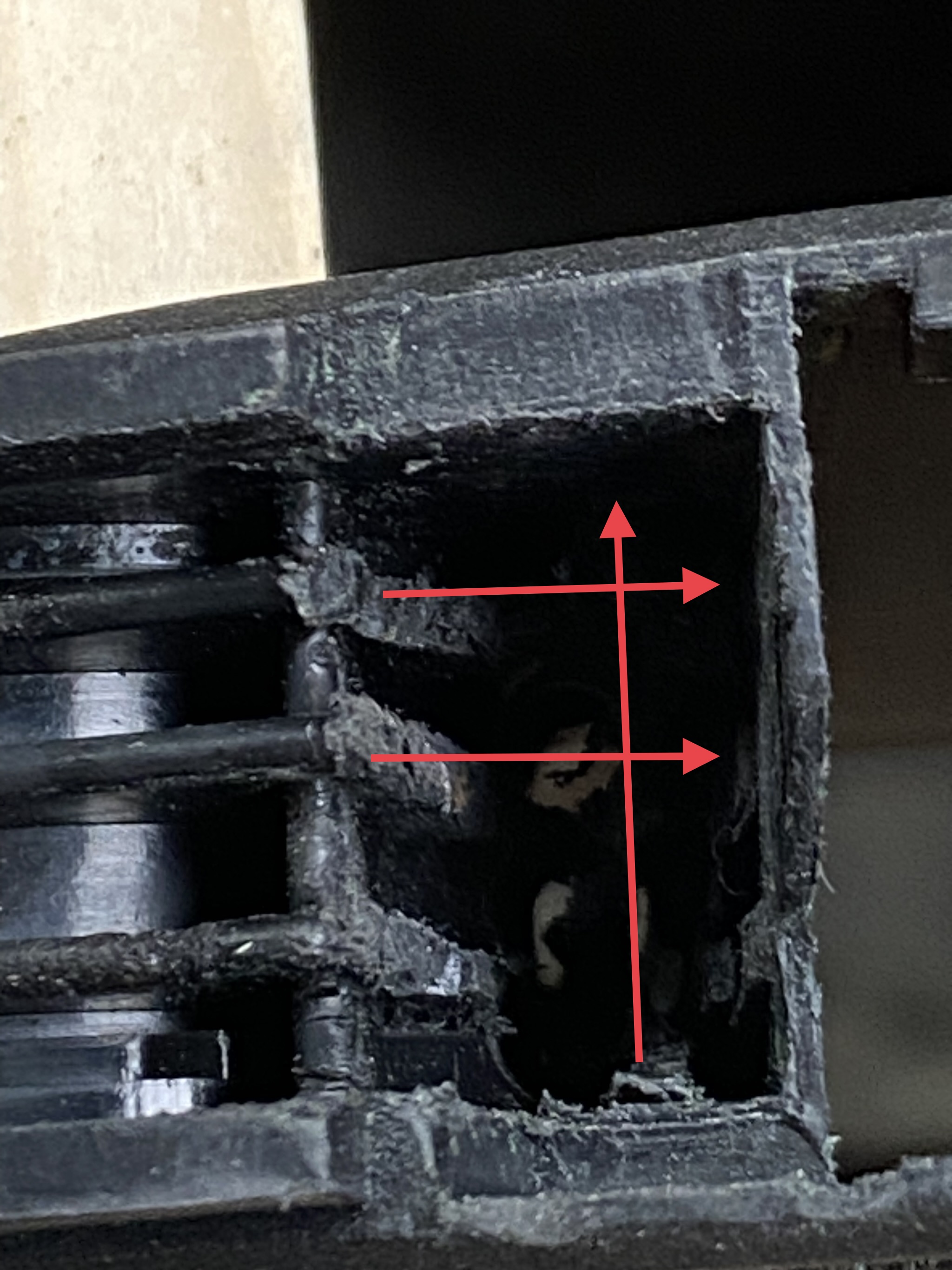

This is a work in progress…it’s still pretty rough looking & can all be polished up. (NOTE: don’t go running over to Reddit to post my unfinished rat eaten work. 😂 You know who you cross poster are 😝) The flat carver did a pretty good job of removing the fins flush at the areas identified by the arrows. The tool heats up a tad due to friction So polymer is easily shaved. This pocket is small with the front wall angled, it’s pretty thin and easily damaged if not cautious.
Think I’ll use the MGBs recommended cutters to get most of the rest of the meat out. Then try out my new Ryobi carving tool👈(amazon link) I just got at Home Depot. I’ll update on this tool

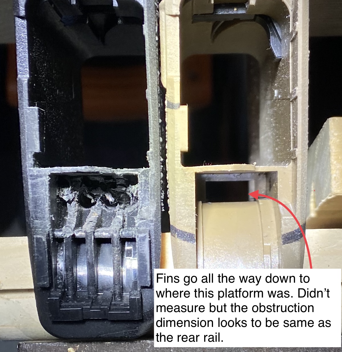

Dang, looks like the "obstructions" go deep. As in all the way down where the 3mm trigger housing hole is located and not just obstructions on the top arch section.
Is that the case?
Hard to tell in the photo due to the blur.
Thanks for sharing the photos.
Is that the case?
Yes they go all the way to the bottom. Sorry about the photo of the trigger housing is crappy.
