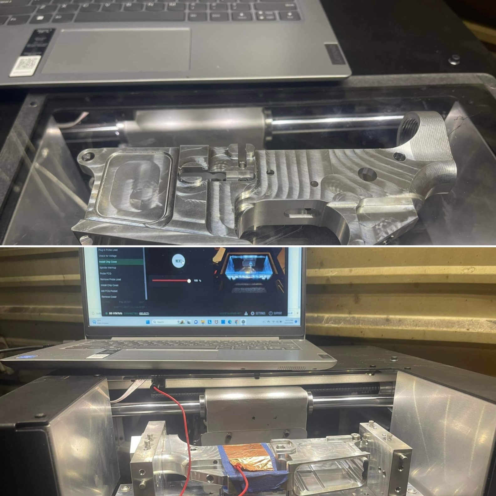

I'm not sure where this conversation originated, or who posted it for that matter. All I remember is a conversation that was based around how cool it would be if the GG3 could mill a solid 1 piece lower.....apparently cool has become reality.
OK, this is cool and all that, but how is it better/faster/easier/cheaper than an 80% lower/jig/router?
Oh, it's slower and much more expensive (to buy the mill). But you don't need an 80% receiver, which may or may not be outlawed. You can go from a 0% billet to a working receiver. That's very cool.

But the notion of being able to mill a receiver from a solid 0% block... very very cool.

They are improving their product. Now they can get the entire lower inside the mill instead of doing it in multiple parts.
While working from a casting or forging of the lower and just doing the finish machining will be cheaper, working directly with the raw stock is nice to have in the tool-box of options. You also could choose another material to work with... like Derlin or Lexan plastic using the same process.

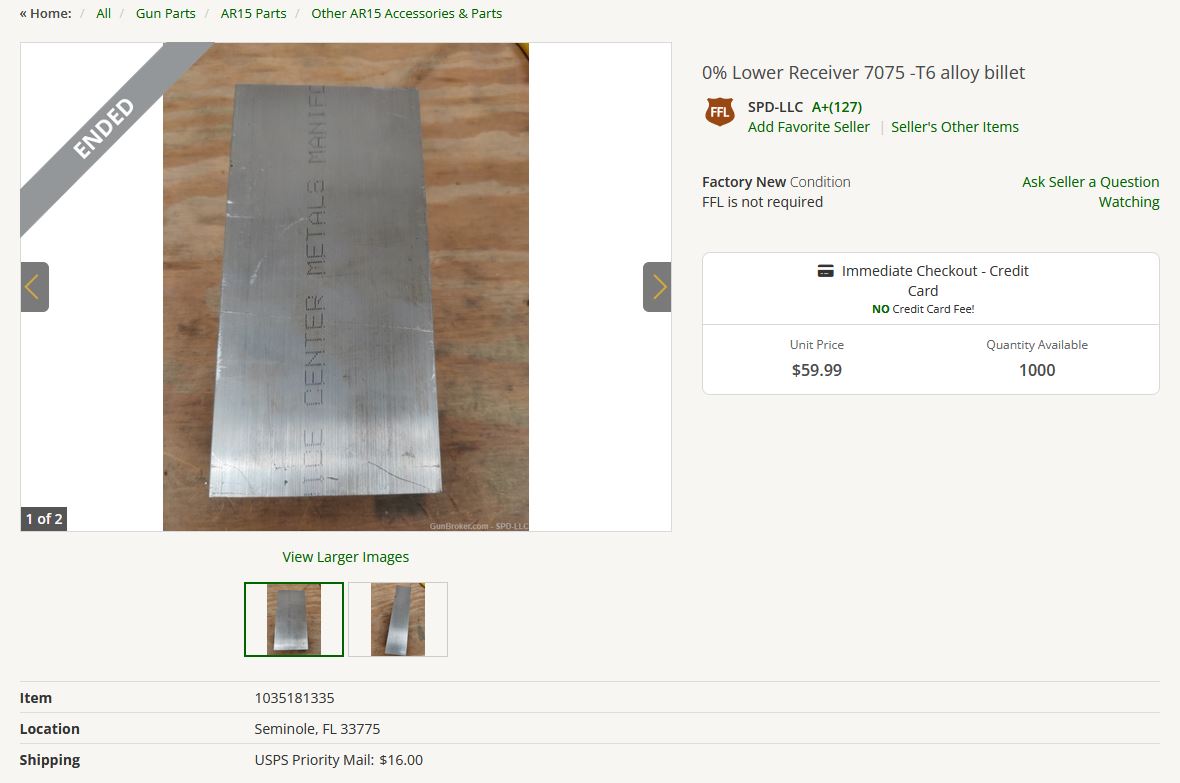

So how much does a piece of billet 7075-T6 big enough to make a receiver cost? Does anyone know?
Are those making a 0% lower from billet using this alloy, or something else? The T6 part of the specification is important. Is the billet they are using been subject to the T6 tempering process?
You can buy an unmachined AR lower forging for $25 ea. here. They are calling it a 20% lower.
It would seem you would be ahead of the game going this route in machine time and added strength of the forging. Engineers, yea, or nay?

Just doing some quick pricing (using Online Metals)... for a block of rectangular aluminum bar stock, 1.75" x 6" x 12" of 6061-T6511 Extruded comes in at $119. A similar sized bar of 7075-T651 is $347. So, it is not cost effective to machine the lower out of stock. You have to order enough raw stock to drive the price down to something a little more reasonable, or obtain the aluminum as cut-off scraps from some other project. It only makes sense if you are just making a few of them and you cannot start from a existing casting or forging of the part. Or, you are just bloody-minded enough to want to do it regardless of what it costs (Ok, I've done that, guilty as charged ;) )
edit: The prices are off their online quote sheet. You could probably find the material from some other vendor for less. I just went to them because I have purchased from them in the past, they are reputable, and they give you a copy of the ASTM cert for the chunk of metal you bought.... it may still be chinesium, but it is at least up to the expected mechanical properties of the material you are paying for.

This ad was from GB. I'm not sure how old it is or was. I've got a 2024 date on the pic but I think it is older than that...
