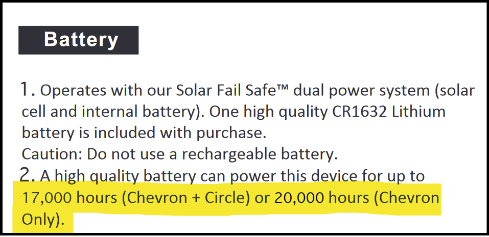

I believe the rating for the vulcan reticle is 20,000 hours, and that's just for the Chevron. With the circle, it's even less, at 17,000 hours:
The traditional dot reticles are much more battery efficient. Those are the ones rated at 50,000 hours.

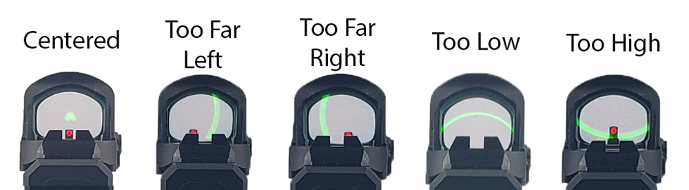

No doubt the outer circle was helpful as I trained and practiced draws and presentations. It helped increase my speed, as it made corrections in my presentation obvious.
It's worth noting that the outer circle of the ACSS Vulcan can be turned off, leaving only the chevron. I really REALLY like the chevron over the dot for defensive type shooting. It's much quicker to pick up visually, because it's larger. The arrowhead shape is intuitive.
Once your presentations are consistent, you won't even see the outer circle. And at this point, most times I don't see the circle. I leave it on anyway... just in case! :)
