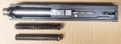

Received the slide within a week. As is necessary, I inspected the slide to see if it was good to go and it was NOT. First issue I noticed is the slide wouldn't go on the frame easily and when I finally got it on, it would bind. The RSA pocket in the frame had been opened up adequately and I noticed the Patmos RSA spring was not straight but curvy and was hitting the inside of the frame. The RSA shown below is from slide #2 and is shown next to a Dagger RSA (bottom). The first RSA was even worse than that. (I lost the pics in a hard drive crash)
Note the paint/coating that has been rubbed off it from contact with the barrel and frame--this is after less than 50rds... More on slide #2 below. That is a Swenson (Midway) 40>9mm conversion barrel shown.
