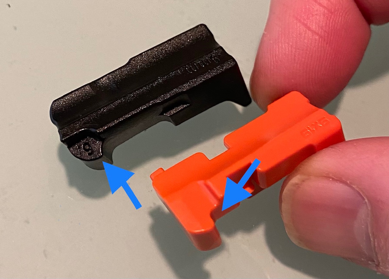

The Magpul magazines I used that worked fine had the GLO 1812-6 follower (I forgot I had done this a couple of years ago). My new Magpul GL9 magazines and some of the Glock Gen 3 and 4 magazines would leave the last round, not feeding into battery. I used my trusty Dremel on the GL9 orange follower to make the notch like the GLO 1812-6. Worked like a charm. I have attached pics to show the modification.
