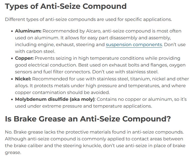

That stuff caused a rust looking discoloring on the insides of my revolvers. I googled and found that plenty of guys had the same thing happen.
Edit:
Here's a result I got from a quick search. I didn't read it, but it's seems to be the same complaints I've read about, and have experienced myself.

We use C5A at work to prevent galling when using stainless fasteners and stainless pipe. That is it's claim to fame...anti galling.
The stamped parts in a Glock are stainless. The edges of these parts that are in contact with the slide and other parts are quite rough from the factory.
For the builder, we can file/stone/polish these contact areas to make the action smoother. For the factory, an anti galling lube is the cheap way out. There is no magic in C5A in itself. If you polish your parts when you do a build, Moly is a better choice. It is designed to be used on parts in sliding contact.
The copper grease is used to help break in the gun. That's what I was told in the armorers class. The copper solids in the grease accelerate the process. Modestly abrasive. Helps smooth any rough edges between mating parts.
Different AS for different metals... :unsure:
