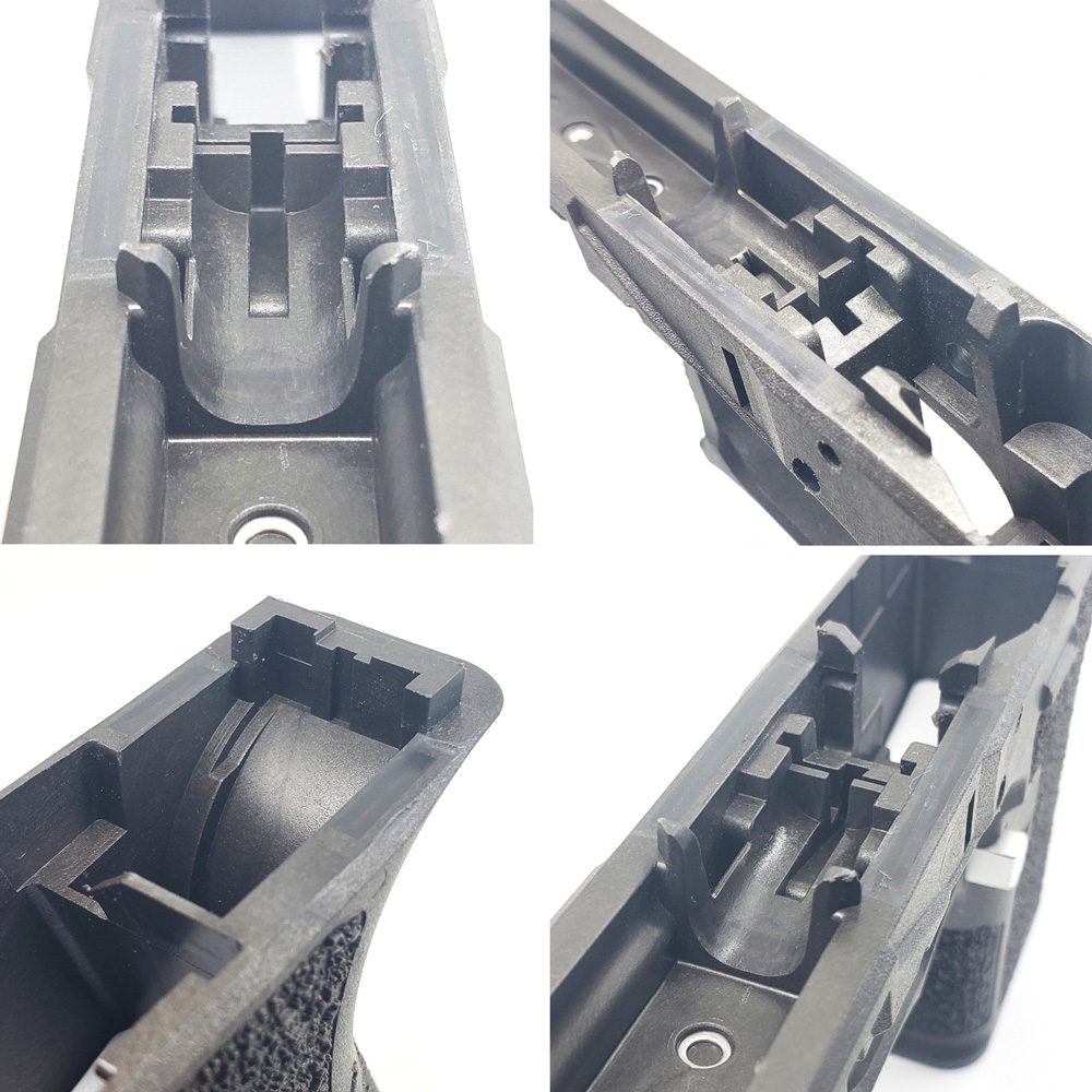

I have the plastic work down to under 5 minutes using a 4.5" grinder and sandpaper.I drill from each side and then straight through to avoid coming through the other side crooked. Awesome accurizing tips as well. I deposit a tiny layer of hard face metal to the lugs and lap with a diamond hone to fit the slide rails if I'm trying to get better than Duty Grade accuracy which always makes things less reliable. I've found that using actual Glock parts makes for a reliable and adequately accurate gun. I've had a few really rough examples using some of the cheap kits that needed work. I should be getting my Dagger in the next few days so I'll see how that works out. I've always had excellent results from my Palmetto AR's.
Wow. It takes me a couple of hours just do do the RSA channel. But then they look like this...
It takes me probably at least an hour to work on the rail tabs, too.
