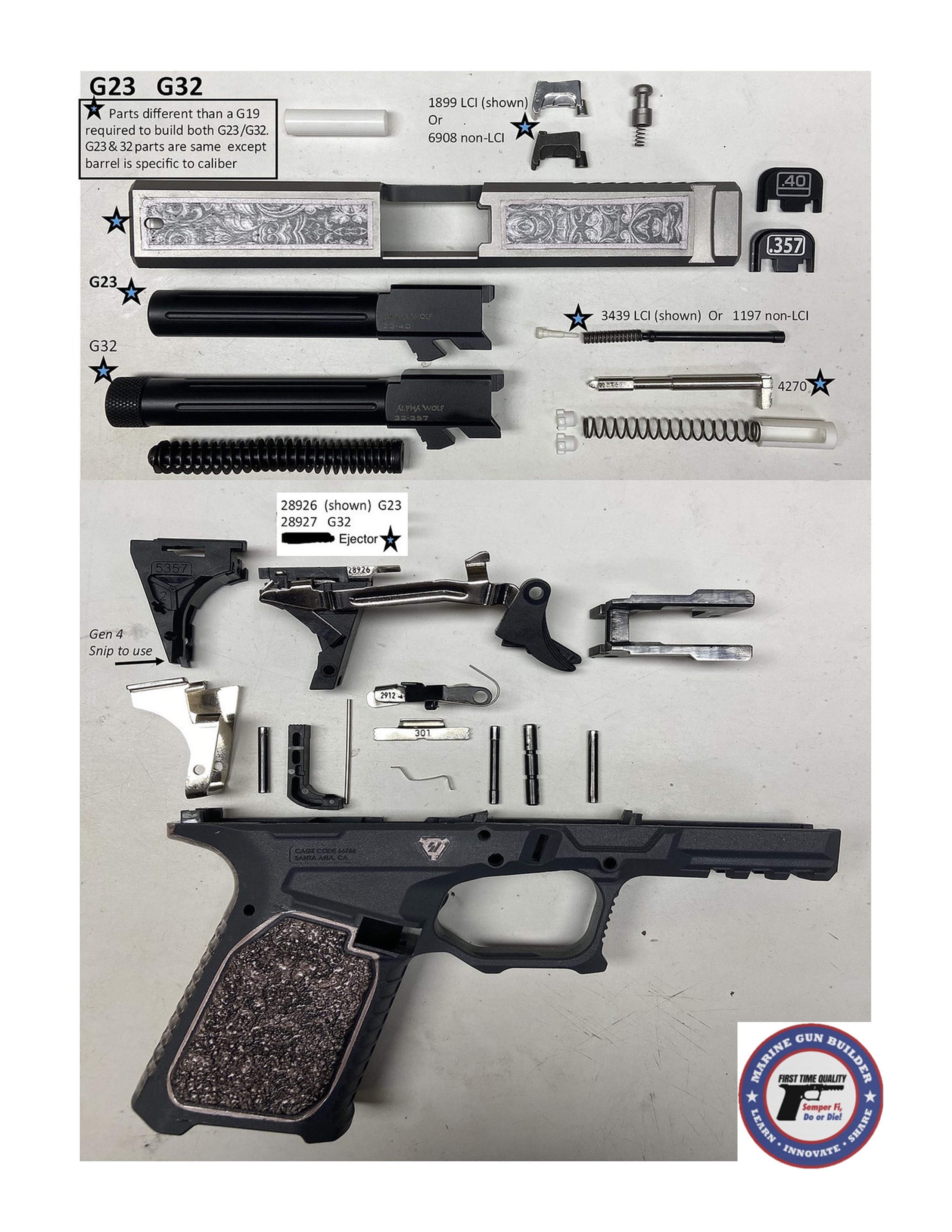

Yes can use a g32 barrel with the 40SW slide. Can also get a 9mm conversion barrel and have a 3-n 1 fire arm that can run 9mm, 40SW & 357 freedom seeds.
Be sure to build the 23/32 with the correct parts they are listed in the resource center. Here’s the photo of parts that differ from 9, marked w/ star.

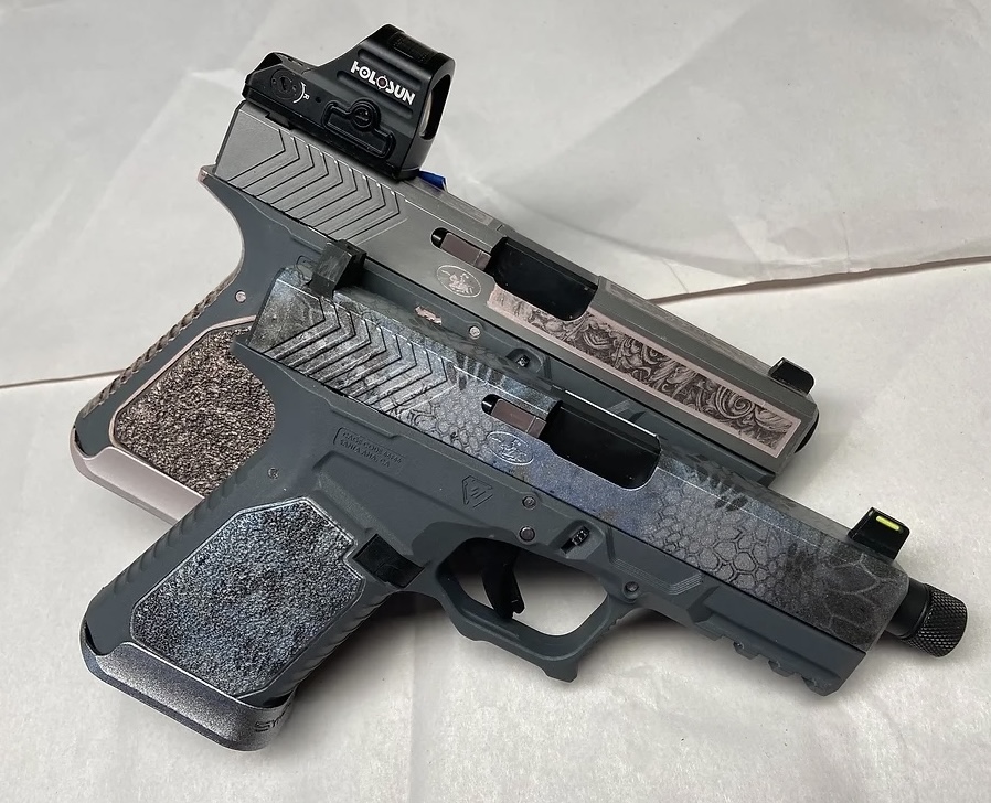

My 23 & 32

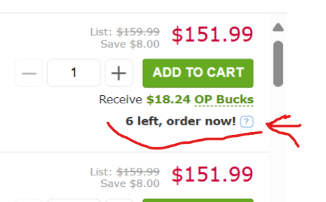

I've ordered thousands and maybe tens of thousands of dollars in parts from them and they have always been responsive. Took me a bit to learn to always check and make sure the part is in stock. If you check and it says it is in stock but isn't, I would do a charge back if needed. When I checked before ordering, I've never had an issue but, if you are not used to that, I can certainly see where it is a pain point. There are other cheaper options including their Dvor.com site so I rarely buy parts from optics planet, but it wasn't due to poor service.
Check, how? On any other site, it will say "in stock" or not. Fuck that shit where I have to contact them to see if it's REALLY in stock. That's just nuts.
Can you not see the image with my post, that's how.
You said that even though it SAYS it's in stock that you have to verify it (presumably by contacting them).
You have to check if the product is in-stock before you purchase.
They are FAMOUS for FALSELY claiming "in stock." It's THE reason I've never ordered from them. I've never heard anything good about them. And since I can order from other REPUTABLE companies that don't PLAY GAMES for the same or better prices, why on Earth would I gamble with this company?
I've never had to check. If it says in stock, it is in stock. My experiences do not reflect yours, but I also won't invalidate what you or others are saying just that it's not my experience. I have a lot of hands-on actual experience with them, and it has been smooth. I share the good bad and ugly. No tie ins or false loyalty with any company. I'm a dealer at many of the sites but that would not affect my opinion.

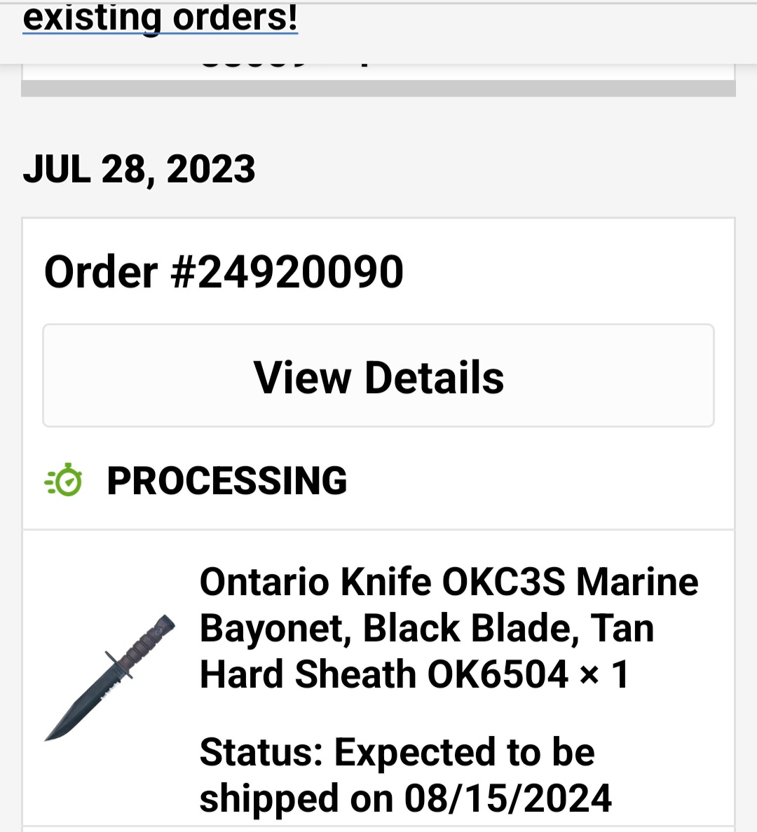

I've never understood how they get so much bad press. Like @FrankenGlock , I've never had a bad experience with them and I've spent several thousand dollars with them.
My only real disappointment was this,
As you can see, I ordered this on July 28th 2023. It did show as back ordered when I ordered it, so I knew I'd have to wait. Well, August 1st 2023, Ontario Knife Company sold out and from what I can gather, no longer produce the OKC3S. Optics Planet continued to update the expected ship date every week for a year and finally gave up lol.
The thing I like about Optics Planet is that they don't take your money until it ships. So, while frustrating waiting for my bayonet, I wasn't out any money. Every couple months, I still get an email telling me that they'll notify me when it ships, even though it now says "product no longer available" on their website.

are there similar fitment and build illustrations for G20/21s, I need a G21 slide to run both barrels?
Aside from slight dimensional differences, large frame (ie: 45ACP and 10mm) guns are near identical in assembly as small frame. So a small frame illustration should be the same as large frame.
Yes, 45ACP slide (G21, G30) can use a conversion barrel for 10mm (G20, G29) but not the other way around.
I have photos of frame & lower parts for the 45. Don’t have upper cuz a 50 cal was built with that frame assembly. Would you like me to put the 45 lower photos up ? @Bobster explained it all for ya. Not sure the pix will be helpful
