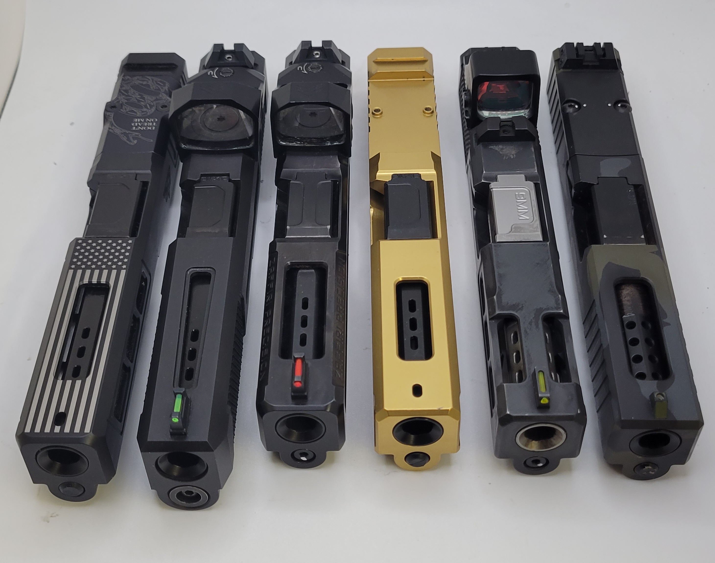

Enough so that I port my own slides, and even a barrel...;)

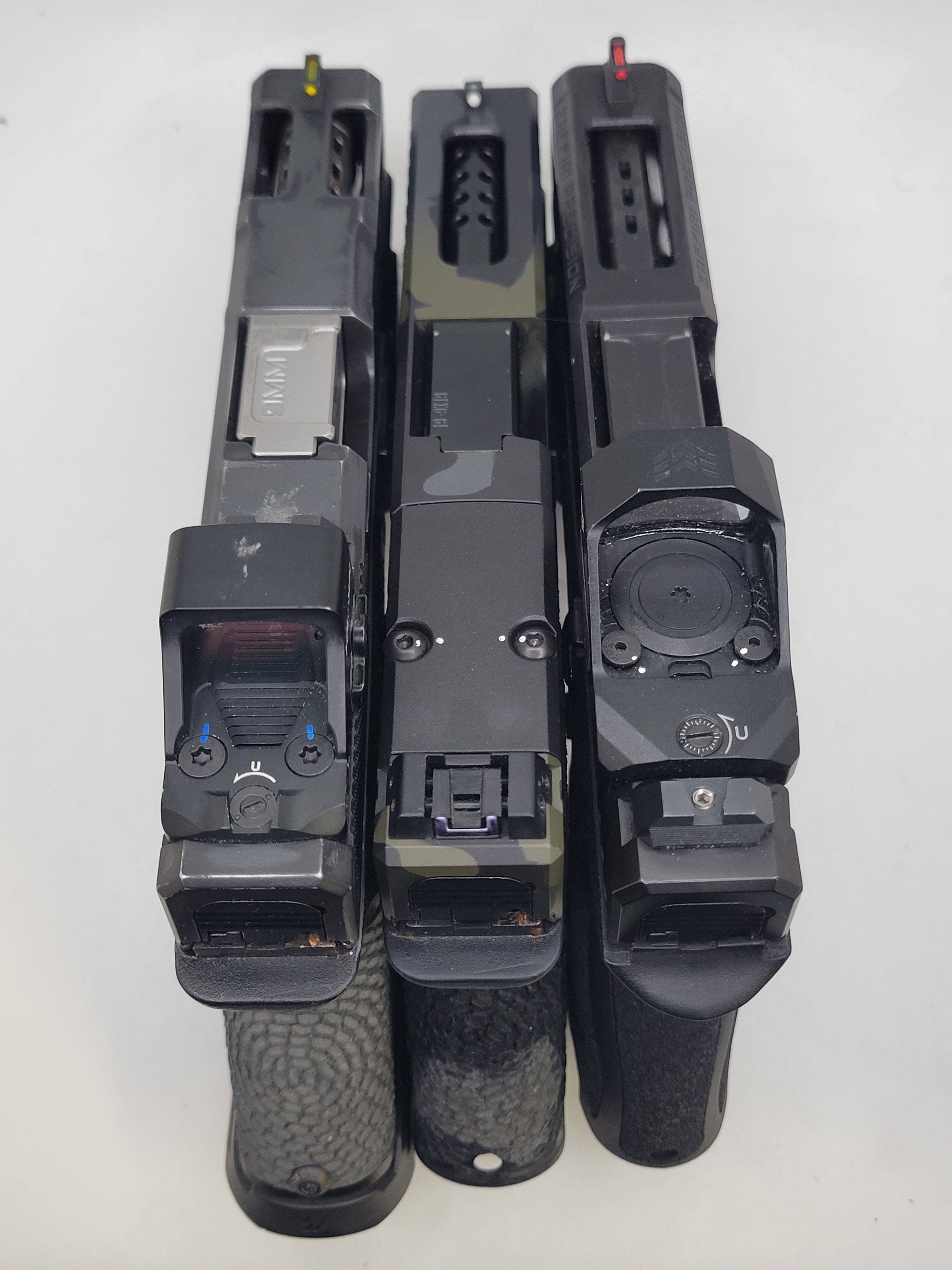

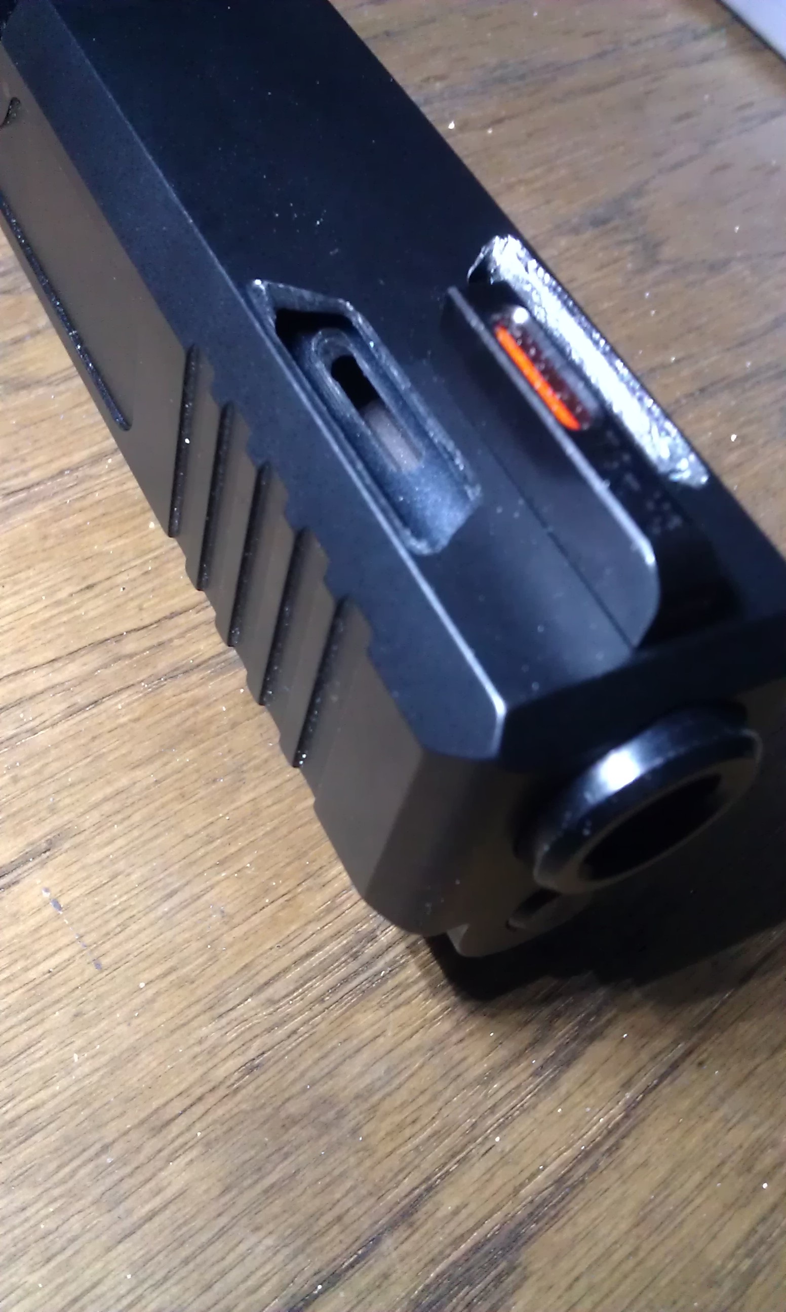

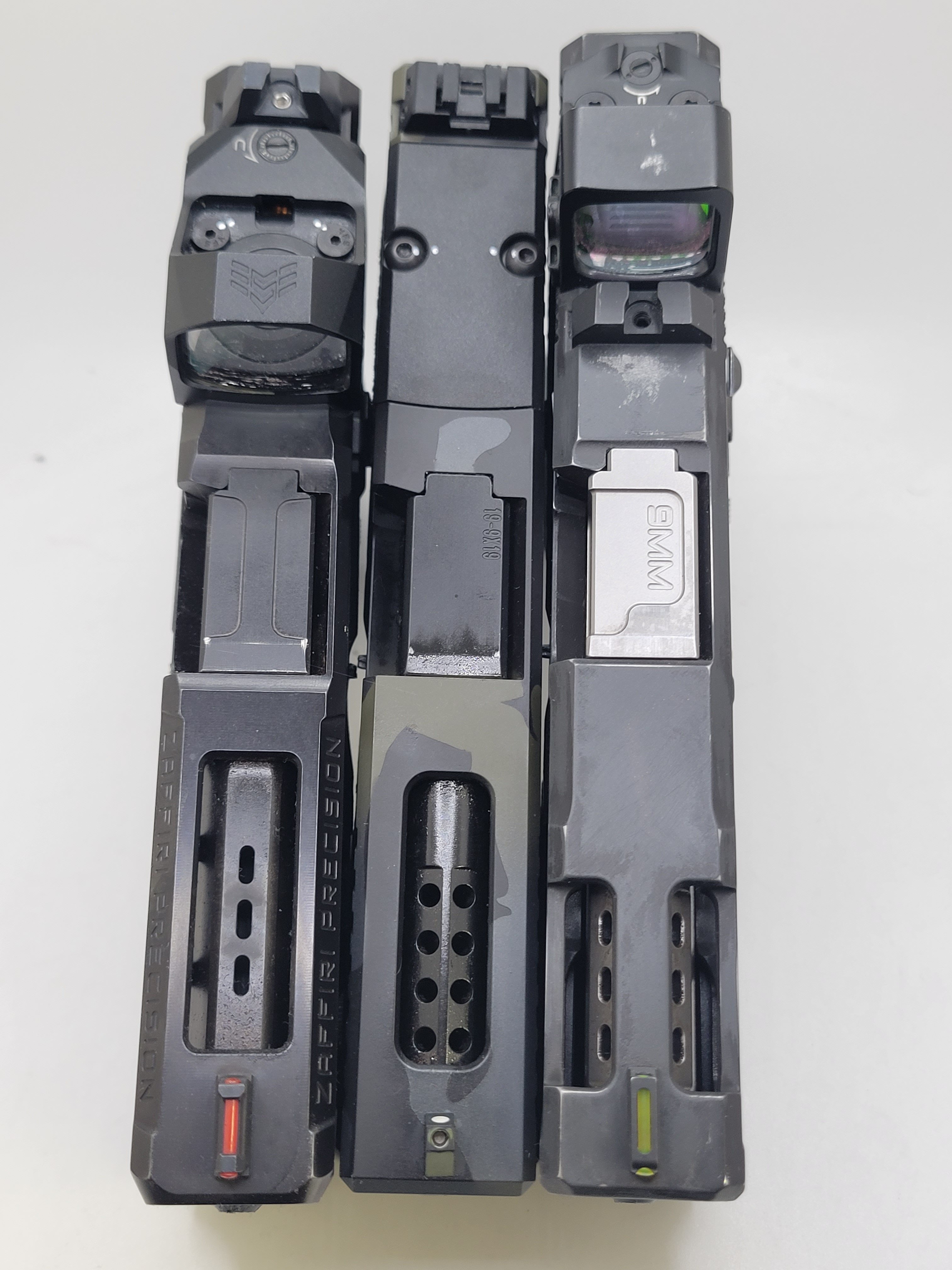

The 10mm I made into a wide-port, based on Glock's updated G20C slide style. This was before I bull-nosed the slide and re-Cerakoted it. It shoots almost identically to the G40 long-slide I have, way smoother than a G20.
The G19 is in a USPA slide I picked up during Black Friday sales for ~$100. This one is a narrow-port slide, which is fine with the lower power 9mm offers, and relies on specific port placement, angle, and shape to help extract the gasses upwards and away from the inside of the slide. It actually works pretty well for a Compact 9mm, neither aspect lending itself to decent port effect. I copied Glock's G19C port size and placement for this one.
It made a heck of a mess.

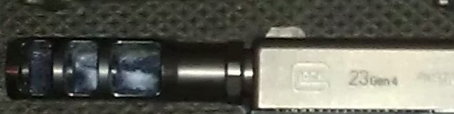

Then there are the externally-ported barrels and muzzle-brake/comped barrels...

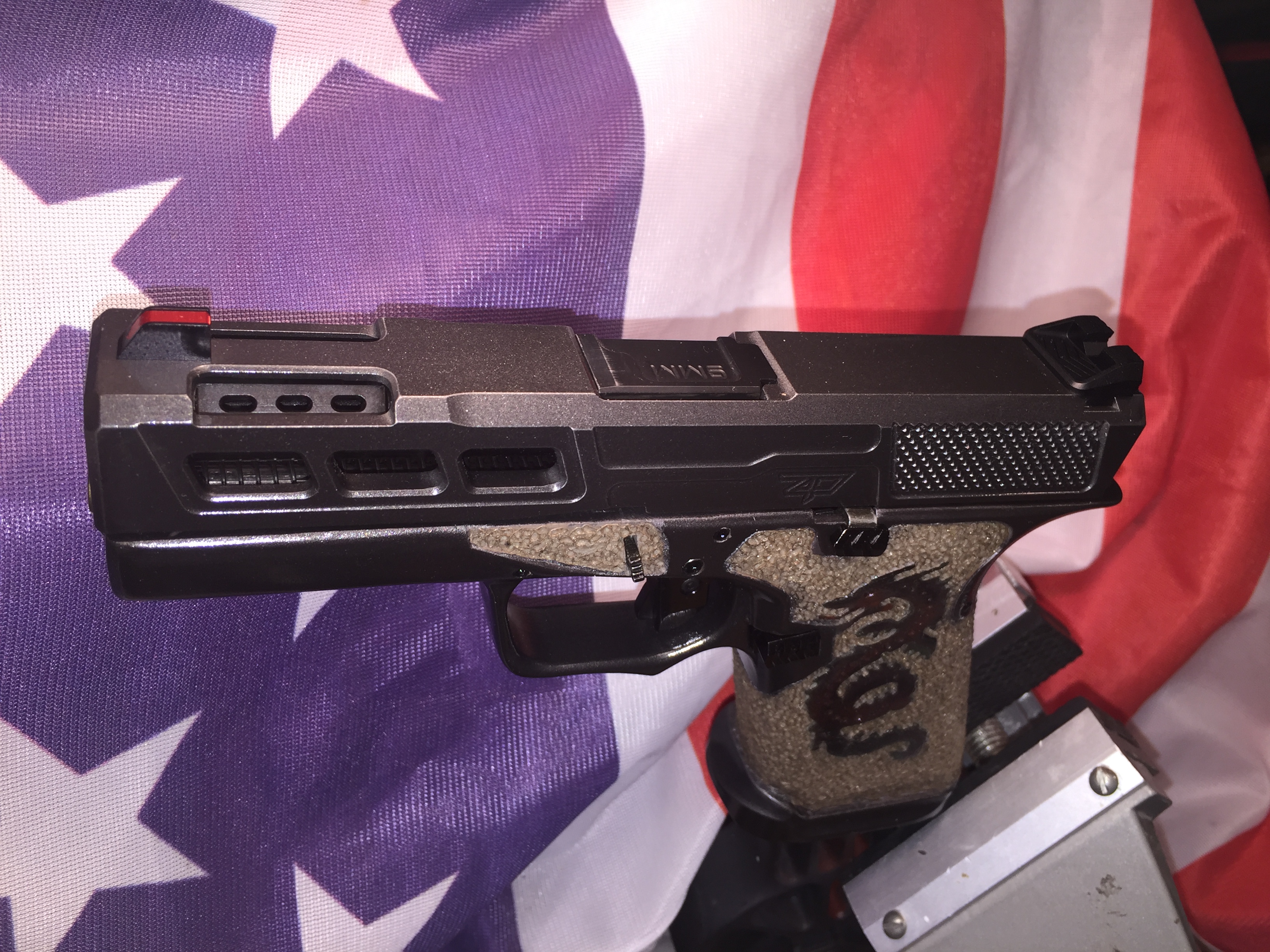

Here is my first ported build. I have another one planed for a future build.
Mooner you have some really nice builds. Thumbs-UP
