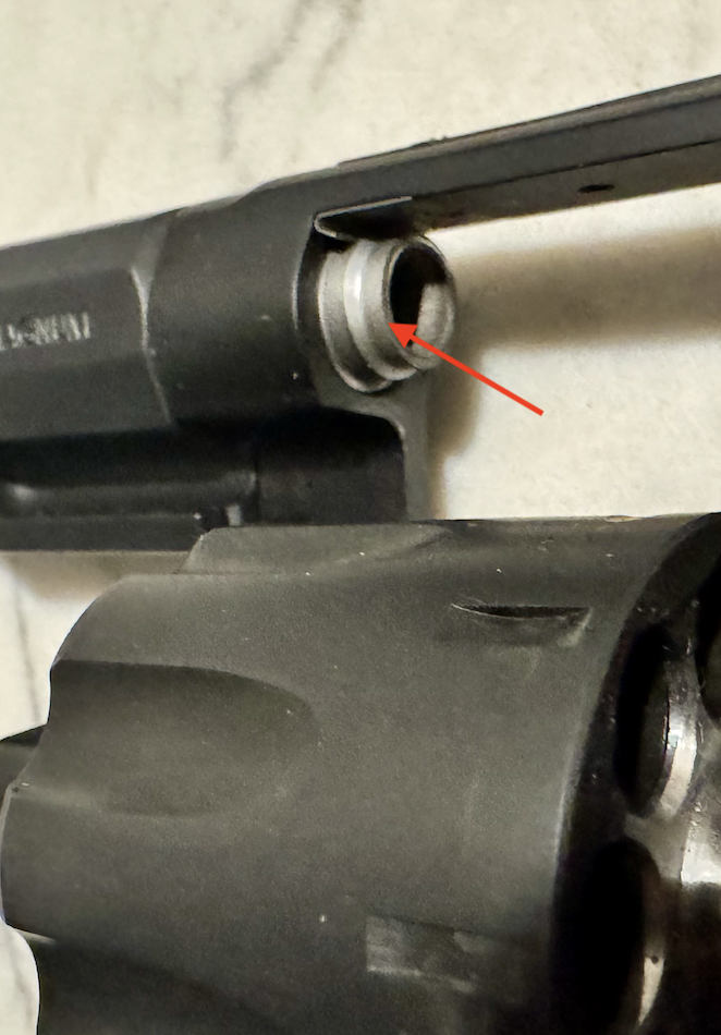

Take a look at that doofus in the video. If he's a hand loader I'm a monkey's uncle. His form suggests he's an amateur. I'm sticking with the cylinder/barrel alignment was skewed. It doesn't take much. If the cylinder is off by even a millimeter, this can happen. The primer is 3-4mm wide and could still be struck. If any part of a magnum projectile catches the rearward edge of the barrel on a revolver on it's way out, the gun is going to come apart. See pic.
I think @bkbrno detailed the likely cause. This was my assessment as well. I agree that timidly cocking the hammer and his purchase on the gun interfering with the rotation the cylinder.
