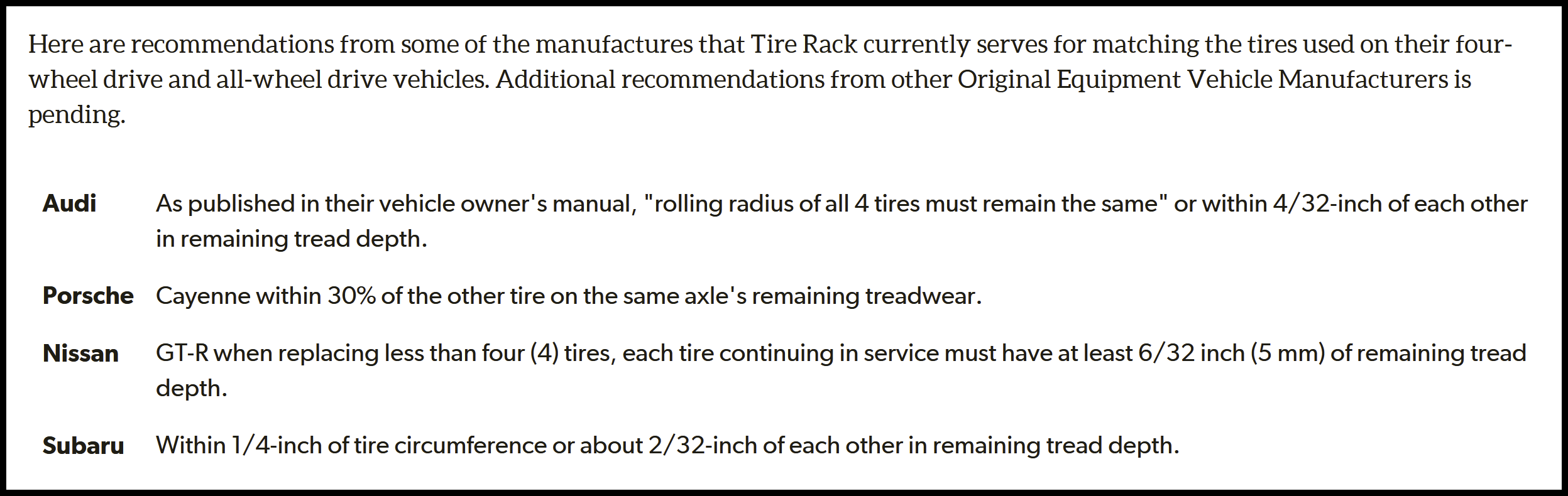

If your car is AWD (all wheel drive), it's even more important to rotate them on schedule. I can't exactly explain why or how (above my pay grade), but if the tire circumference varies too much from front to back, it can screw up your transmission / differentials. So, even wear on all the tires is more important with AWD.

The part about AWD cars is grossly overstated. It depends on the AWD system. Some cars have an open differential so as long as the tires on each axle are close in diameter it's fine. True 4WD cars with locking differentials it does matter and can damage the differential.
That's because most "AWD" cars are not actually AWD. Subaru and Audi "Quattro" are actually full-time AWD. Honda, Toyota, and most others that are LABELED "AWD" are actually "part time" AWD that activate only when wheel slippage is detected.

"If your car is AWD (all wheel drive), it's even more important to rotate them on schedule. I can't exactly explain why or how (above my pay grade), but if the tire circumference varies too much from front to back, it can screw up your transmission / differentials. So, even wear on all the tires is more important with AWD."
This subject is HUGE for those who own Jeep Grand Cherokee's. The size disparity between front and rear tires have caused MANY transfer case failures in that model....esp with those who swap out two tires on the cheap (pair of new fronts ONLY, for example.) It's pretty well documented.
