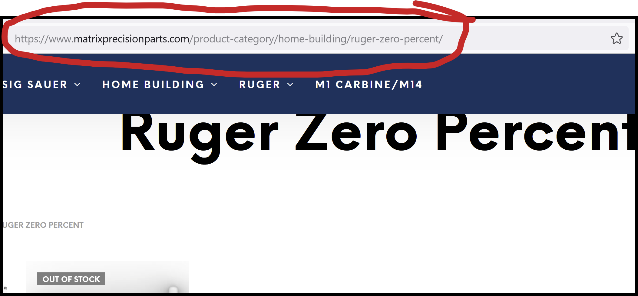

Just copy-paste the link into the message.
Copy the url / address (circled below) of the website you want to link. Then paste it into your message. The forum will automagically convert it into a link.
Okay I will try to remember that.
