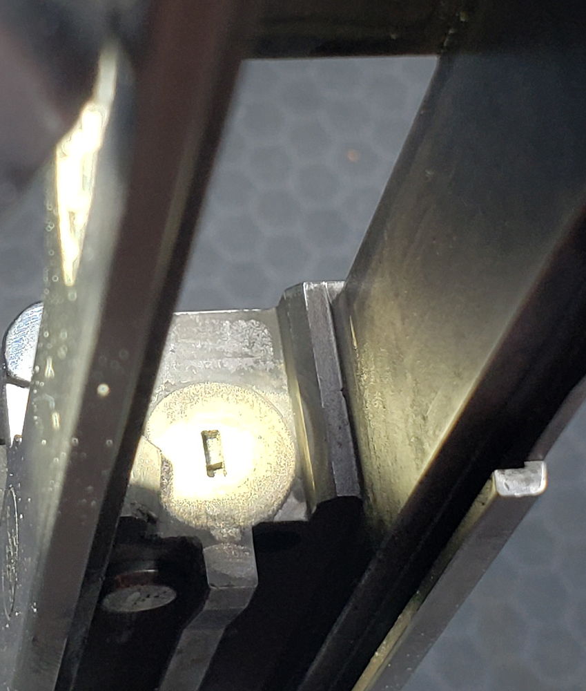

I took the slide off and depressed the firing pin safety while moving the firing pin lug forward. No pin showing through the breech! And I can't push the firing pin lug all the way forward. I think the firing pin tip must be broken and lodged in the striker channel. So, I switched to my PFC9 "EDC" and finished my range session.
Back home I took the slide off again to inspect the firing pin through the breech. It looks like the firing pin tip is in there sideways, eh?

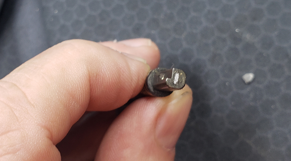

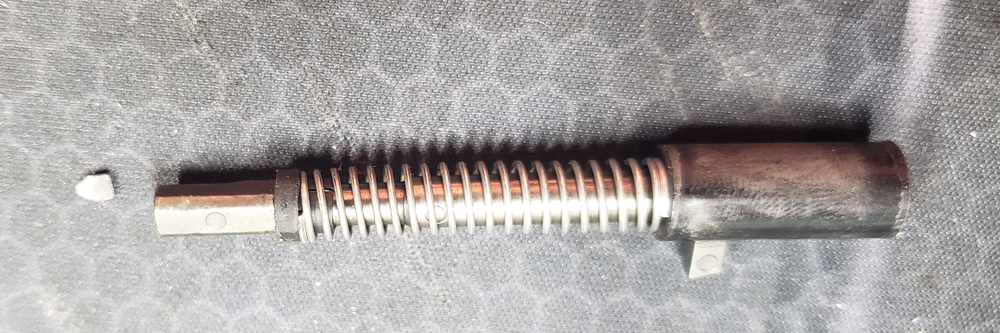

So, I took the slide cover plate off and pulled out the firing pin assembly. Yep... tip is missing on the end of the firing pin.

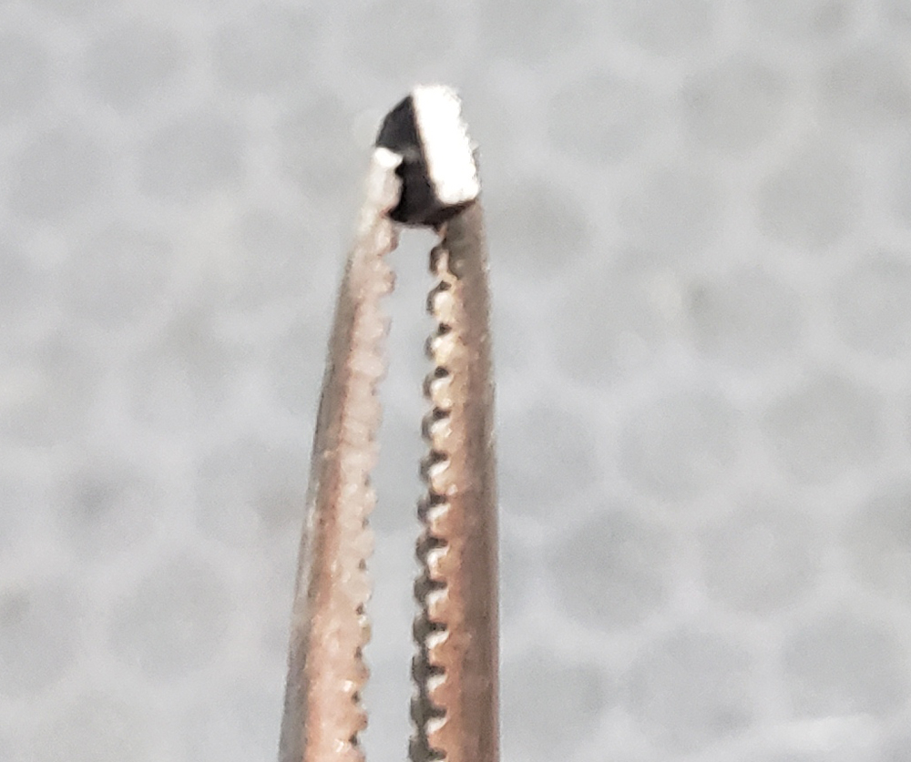

I tilted the slide so anything inside the striker channel would fall out. Sure enough... the tip tumbled out.
This was an aftermarket UPK that came with the slide (generously donated by @Michele).
The gun has 800 rounds through it. I guess I'll just replace the whole thing with an OEM Glock firing pin assembly. Though, as some may recall, I had an OEM firing pin break, too!

But given the amount of "latitude" or "play" around the firing pin (space all the way around it in the hole), I don't think that small degree of hole offset is a factor in your case.

By this photo of yours, I'm inclined to suspect the hole is fine. It's the firing pin assembly not being centered. Maybe aftermarket firing pin spacer sleeve or the spring cups?
