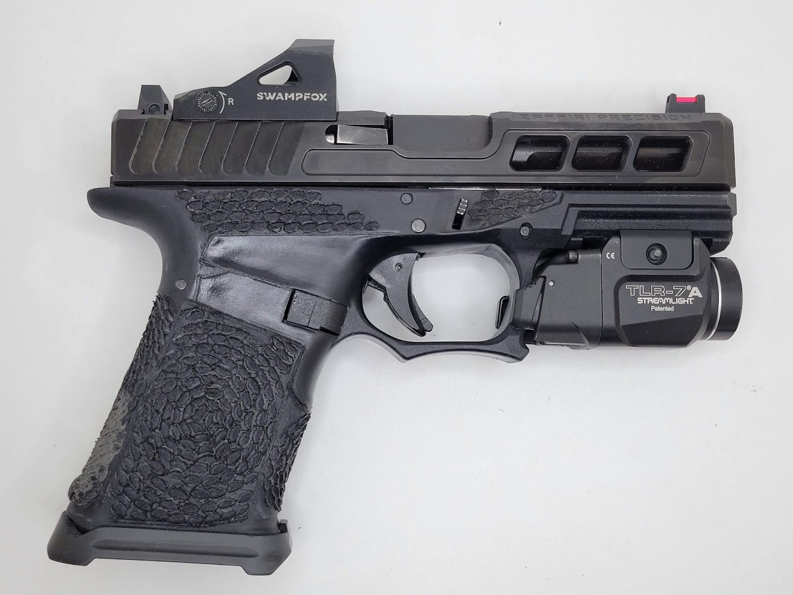

After trying to polish the frame by hand, I realized I need better tools.
I found a Drill Master micro rotary toolset on eBay for $15 shipped.
Drill Master Light-Duty Light-Weight Rotary Tool Set 80-Piece 69451 | eBay
NYPDfFfrzwiCkwi4yb0nlwSwJKMLz1UgTUQtmMO1pByt5Lrefx8zrOy3Any1oyBxeOtHW6BLxG51zZ-MlaWq8YPDbEcMBGjGneEKiNmDDX6ZQcq5RU4feGp_rn8BggO3TjjUweCk
I got a say, I use this more than my Dremel flex shaft now.
From cutting to sanding to polishing, I was pleasantly surprised.
Very light and portable and easy to change bits.
Mirror finish…
Use the lowest grit 180 to highest grit 600 sanding drum set.
Will from Shoguncustoms said don't skip on grits and to spend more time on lower grit.
Counterintuitive, I spend more time on higher grit for the finer finish but that was his feedback
Amazon product ASIN B074NNY7L1
View: https://www.amazon.com/dp/B074NNY7L1?psc=1&ref=ppx_yo2_dt_b_product_details
jXCvzb8MBc0xnefWLb_qyjCY90WpOzYUnGSOcmY6BTtLobNg8RKh_J-lRseIuVN3X__tEHmL8BPoYjp40OJdZoKsfOJq3ejvvJh0F3bpmoQ5Jf2PtXUS8FoNYIj7NK2Tr8WHYbPz
Apply WD-40 during sanding. Apply to the drum and frame.
Tip from Brad from Gledhill Custom.
It softens the polymer and will have a smoother finish with no white ashy.
Higher than 600 grit, I used sandpaper by hand. Obviously, it took me forever.
Will from Shoguncustoms gave me a tip about wrapping sandpaper on a mandrel.
uxcell a16010600ux0647 Abrasive Sanding Disc Sandpaper 1/8 inch Shank Dia Split Mandrel 5pcs (Pack of 5): Amazon.com: Industrial & Scientific
E6nGZDTNdwSBdmn1JiWtWwxXNa05fMQ213bJ0XuxKUFDWDDTg4sg8qKOW4RLH47TzmPTDOEpyA2RbpH86KRPba9vLWw9_uZv9gesXDRs3rvv7JrE_keAdrg2eZmEJoz5qRidW7FD
I have 1000, 2000, 3000 grit sanding papers.
Cut them into a few inch long sections.
Roll each on a mandrel and secure them with a rubber band.
(rubber band was another great tip, had the hardest time securing papers to mandrel)
I would have two sets of each bit.
Applying WD-40, get to polishing until the mirror finishes you desire.
tM8SkBzYn_7Nin5cYs16G0OnJGO3OuQ27rE_inOCGyS1K_ka9MmYg3gtMWt8oM-Tz7yY_y--O58QI-eNtgxfvamekg7Jdw1lj0i1YLHRXAs7bNVph9f44J-GYHLwedRIKqiIYpVJ
Apply some Nu Finish, Ultimate Black, and Pledge to bring back some oil and shine.
Update: Found a sanding drum on Amazon
Chiloskit 10pcs 180-2500 Grit Sandpaper Grinding Head Sandpaper Bar Stick Abrasive Grinding Mounted Points Woodworking Polishing Tool 1/8 Shank fit Most Rotary Accessories Bit (180-2500 Grit(10PICS))
Example before sanding drum set and mandrel tools
LsK4VZHPDLgnxYaQQ1zwPUbY8oJxK9D-Xwke7Q-f7AF3PjnHsnGoOMaW9I4tBwRgK_u5sRVcA7OYldoxLKPxfV42Wb3TUySUyAOkQ8gxB_bne1dlwLexgaXnIJIhPB3Edw9pTLSQ
bi9pXOtpeuYrIxHTuYH0n6CJnXit1NxO8mm1KqPAJ3Vh_1sgfaXA4BSj5HZYWHH5Zk1RWUgI2H9UWbRN5Qvq11uGXxbPLlda5I_HqOnbnM6-TMVCigUOoJc-bIXSQbfrAJJwEHaC
zJqWO3LViEi9-kthUQIPf1x2zn-I3Hdtg-vhLGErjUb_rJMMPnSxwg6vgLwLQJ3mGQ7zu3Flki9o_XcWhmu14ejyFStOm7lfvGxp9qD_1brEMbUE-dZUTAE9iKlGcMaGqHIZnvO_
After sanding drum set and mandrel tools
ZgA9bu-MRmUHvcueYFSaeTF-TWFEt35SV2G6W30WaQChU7U0Y8iSPGLR9L9MVhs-iOMjSILnoqrO3QnjTGvUcRu3EcGRmRuEMqQDTgwzdpgbOdi7zsiv-4DZIFGulBBzDZ3IF8bZ
FDTfSjKyKmi6Yr5yycIeTyGo93V7EC1DixQBV3_NUr8SL5Dr7zJd5Mw6z9T9XvFBv487cEX1nysiETe8w64Qy3kZlXLEcmEEMRl_M0QlRYaQS89dTkr_MJcNPeES4Gjdx7iEjH1f
Xlf8AJcItn_WiFNTZm8CRFrU-O_neJOJIvlkmLecj-chj2GVb3emSS7mTS1q5lW_Sc-8hedQ0wqR5tqYnKxlLVsmFpX7yn1G0Ce1qeHtrCKbFuVw25jUlSh0cbxViIt4PZGDPsJs
Quick and dirty polishing…
I got a new PSA Dagger lower and I wanna do quick and fast polishing. Only in the beavertail and under the trigger guard. Started with 600 grit drum with WD-40, then went straight to 1000 and 2000 mandrel sets. Apply some finishes, let it dry and hit it with dry polishing wheels.
66t_HZXYEnooik2AKbZRN4NH4HqgYChE8WJW72yD6aY0nV4endVhwNH8Etqh2Cx5W5XztEflytubvo5I2EGAJnYH65-67MZL3zjf4M5bV3yFhNwGcLhWh5Wz8_fGRpDYf6u07kBF
XX422EwTE_LUYaCScHZL38ByEDR4VFu4se8-poSXSzDh9osCqsFhPLWh44zlwt84EeRibWFa2k13VTmqWuLQhM57jlTlbPVfB3YkA_axhN3mJxdqctAYhv7JKRv9KSlkOwsj7Zyl
Only had a dagger lower for a few days and it's a love hate relationship… 😆
