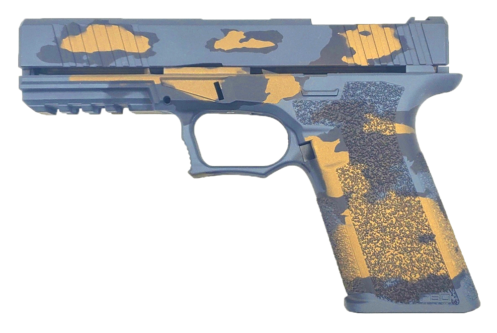

I'm liking the gray and yellow/orange camo pf940v2 second on left from bottom.

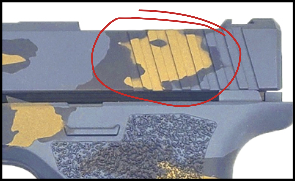

That's going to be a G20 (10-mm) build. I'm calling it "Rebel Yell." See if you can figure out why.... :)
I'm hoping to find a copper barrel for it. Tall order, so far, as I haven't found one.
My only guess would be, because the yellow/orange matches Billy Idol's hair? :ROFLMAO:
If you can't find one, you could cerakote or gunkote one.
Is that an old man with no teeth and a long pointy nose?
You might have to tell, man.
Yeah... I spotted it immediately... looks like a dude yelling.
So..... "Rebel Yell," with a nod to Billy Idol. ;)
I see something different.
Looks like a toothless, old stoner coughing smoke clouds out of his mouth after a huge bong hit. The first smoke cloud is massive, then the second one not so much like he's clearing his lungs.
Maybe you should name it:
Chong,
Willy,
Bongmeister
or simply Ganj.

You may have to send one to a coating shop who can do the copper coating or use Cerakote.
Yeah... may have to send it off to be anodized. I'd prefer that over cerakote on a barrel.
