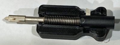

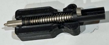

So I started with swapping the PSA spring that came in the slide with the "mid-weight" spring. Since I was using the armorer's plate to check striker engagement I determined it could be useful to get the spring cups back in as shown. :) Yes, they make special tools for this you can get for as little as $10. 3D print from dbay shown.

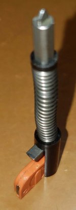

You can also use the slide to get the cups out, I flip the SA in its slide hole as shown. With this method it helps to have a vise handy. The back plate on this slide (from the TWC3) was SUPER tight and required a gentle tap of a spudger wedge made out of an old toothbrush handle to get it to pop out while holding the striker sleeve down with a Glock tool.

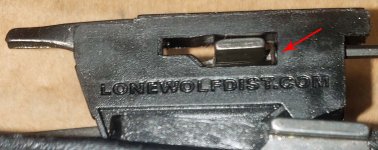

UPDATE 2: Got the LW parts in a few days--they ship rather quickly in most cases. :) I figured some might like to see the "trigger" stop screw that comes in some Lone Wolfs.

Some Lone Wolfs come with a "trigger stop" screw which actually limits the rear travel of the cruciform. I "borrowed" the screw from the TWC3 to use with my TWC1 which did not come with one. It is fairly easy to install/adjust them as long as you have the tiny allen wrench (one comes with the screw). Remove the slide, pop the rear pin out, lift up on the trigger block and the screw is right there and the hole is already threaded.
With the TWC1 (DaggerWolf), after some trial and error I ended up with only about 2 threads showing. Any more than that and it tended to tweak the block when the trigger was pulled but the 2 threads DID make a noticeable difference in trigger travel. That gun has LW trigger parts.
With the TWC3 (shown), the screw doesn't seem to be touching the Glock cruciform at all. :unsure: I adjusted it at 2 threads showing and it is not even close. Perhaps the Glock cruciform is a different dimension in that location? :unsure: I may try putting the original LW trigger bar, shoe and connector in and seeing why the LW trigger didn't work in the first place. The orange armorer's back plate is already on the PSA DLC slide shown.
