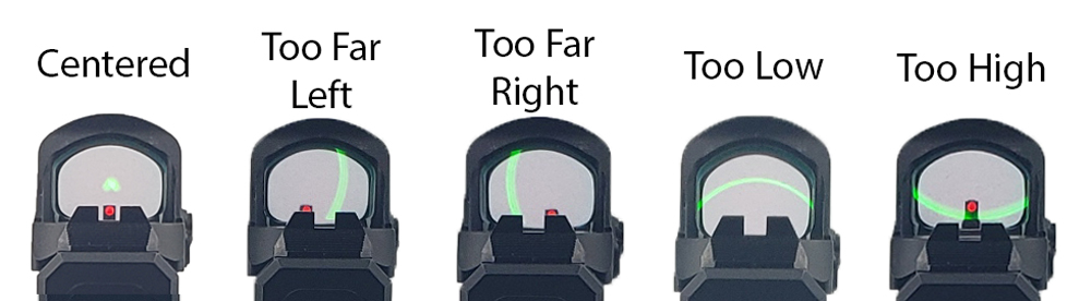

That said... Holosun has come out with a new reticle callled "Vulcan ACSS." It's pretty slick. It projects a LARGE outer ring that isn't there if the "dot" is in the center of the field of view. But, if you're "off," the edge of the circle shows up in the sight window and tells you which way you need to correct the orientation.
I've got one of these new Holosun sights (with green reticle) on the way for my new P80 "EDC" build. You'll notice that it has a chevron rather than a dot. We'll see how I like that!
