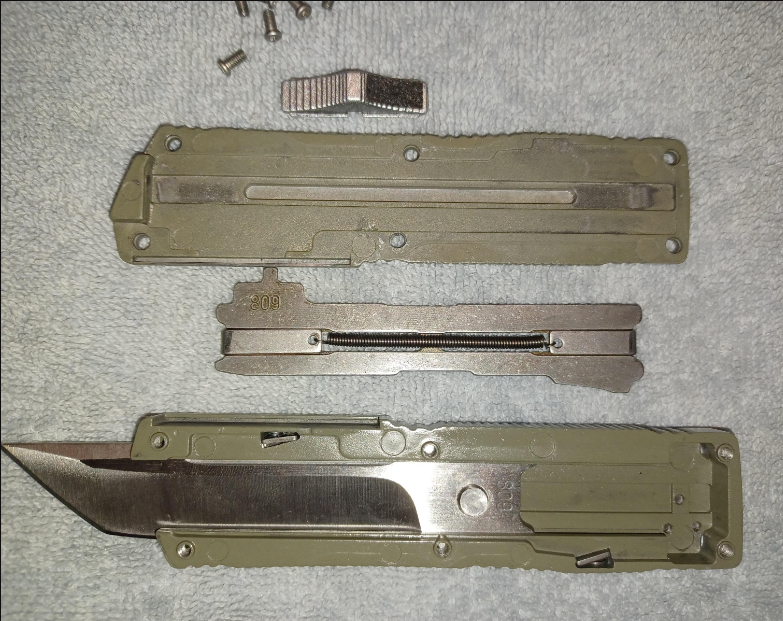

Didn't try very hard to find replacement springs.
Opened up the budget otf, took the little itty bitty springs out and gave them a little stretch.
I am surprised I didn't lose them.
Action has been 100% since.
Also added small pieces of 3M SAFTY-WALK grip tape to the switches of the elite and fireball (slipped in my wet hand) like paint or other adhesives prep. is key to getting the tape to stay.
