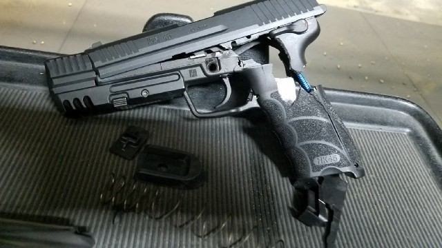

I am compelled to tell this story because the information could save you from serious injury or save, yes, save your life! I work for an indoor public gun range. The story is true. It tells how a handgun exploded in a shooters’ hand, the damage caused, and how to avoid it from happening to you.
In the spring of 2019, a young soldier and his friend entered the range ready to shoot the soldier’s new .45 caliber H&K handgun. He was in the military and recently returned home from a 14-month deployment. They both were excited to shoot the soldier’s new handgun. He was carrying two bulk packs of .45 caliber ammunition. We spoke for a short time about his deployment and reviewed the safety protocols for the range. With the proper safety equipment, they entered the shooting line and took lane number four.
I casually watched the soldier as he loaded his gun and prepared to fire. The first shot sounded too loud for a .45 caliber gun, even using more powerful “plus P” ammunition. It sparked my attention. The second shot sounded like an explosion. I rushed to their lane, and both were standing frozen in place. Their eyes were wide open, skin tone pale, and breathing rapidly.
The gun was lying on the shooting platform and had suffered a catastrophic failure. The magazine had blown out the bottom of the gun. Both chamber and barrel had split. The frame and grip panels split in several places blowing the gun’s working parts down range and around the shooting area. There was an unidentifiable odor present. The gun was destroyed.
I sat both young men on the bench behind the lane and noticed the soldier who fired the gun had cut marks on his face and his safety glasses were cracked. The cracks in his eye protection was evidence that shrapnel was deflected saving his eyes and his sight. His hands were beginning to tremble and swell. His friend had no visible injuries but appeared to be in shock.
I collected the remains of the gun, ammunition and guided the two young men to the range office. I asked for details about where he purchased the ammunition. He purchased the ammunition from an internet site before his deployment. The site claimed all ammunition was new manufactured, not reloaded. The company was developed by ex-military personnel. He said the price was inexpensive, and he wanted to help a fellow soldier and save a few dollars. The ammunition appeared to be new.
A closer examination of the ammunition revealed multiple extraction marks on the cases, which indicates this ammunition was not new and the shell cases had been reloaded numerous times. I was informed by the soldier he did not obtain verification on the company, and we did not find the website with a new internet search. The ammunition was the cause for the failure.
