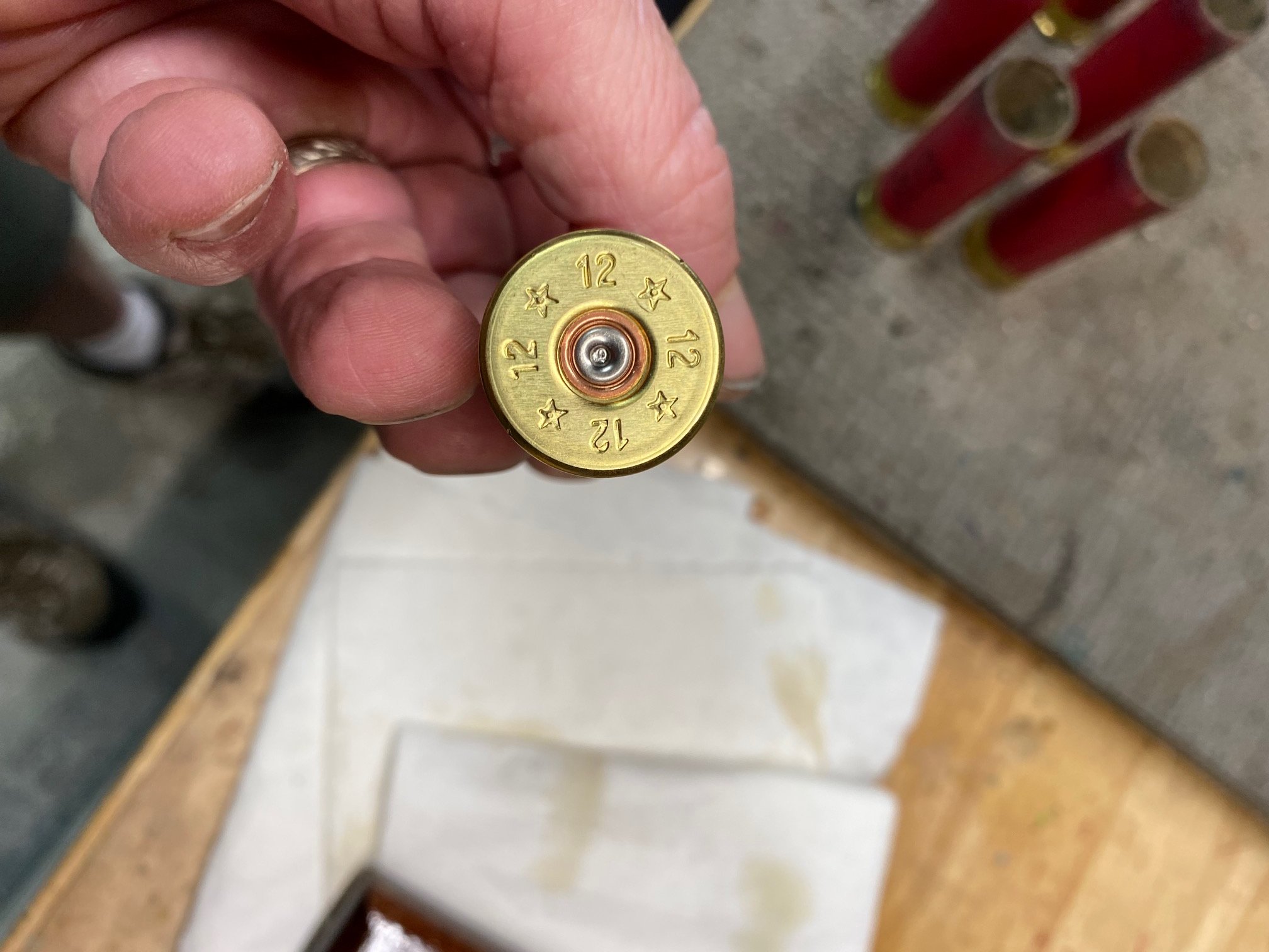

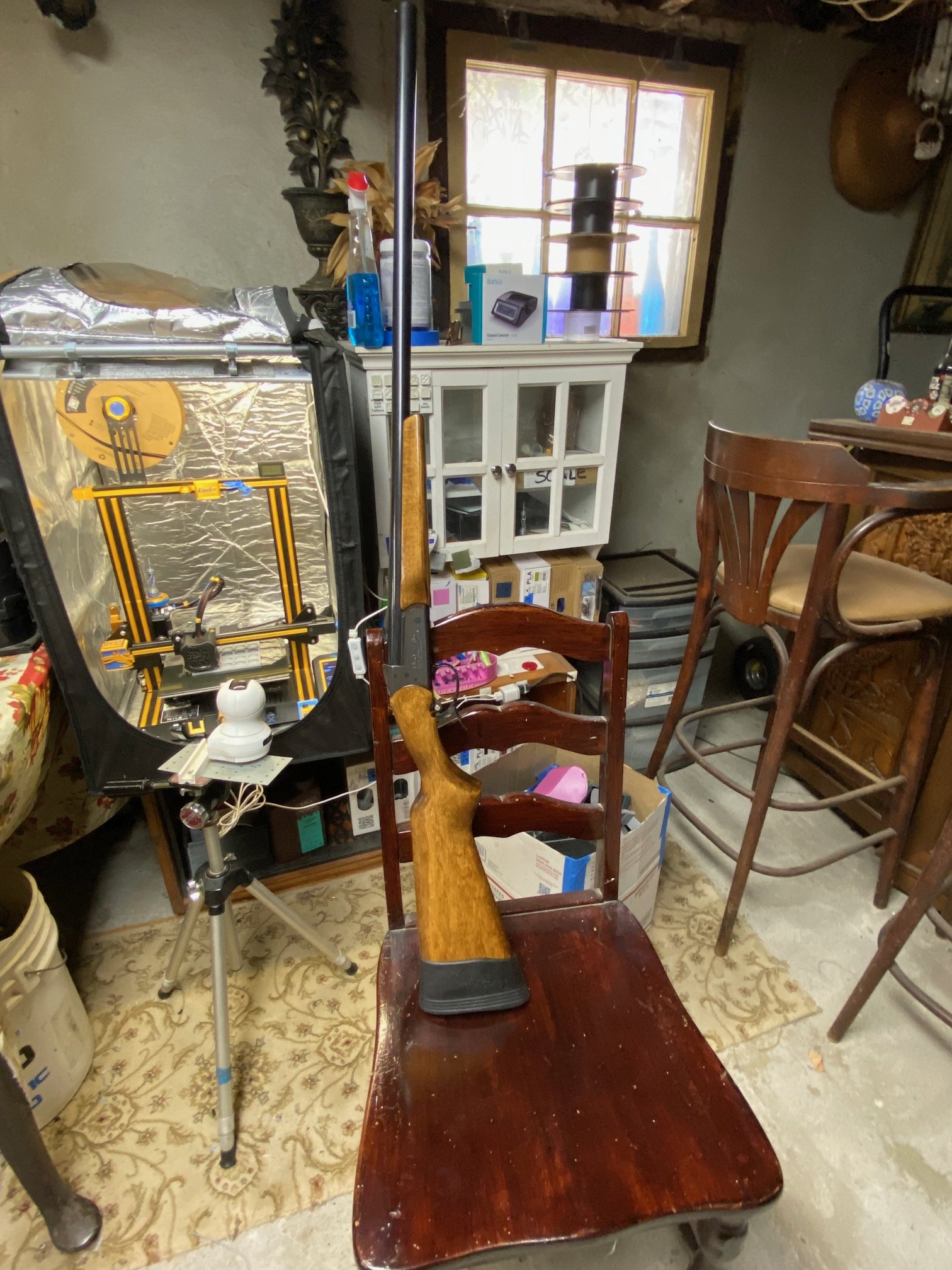

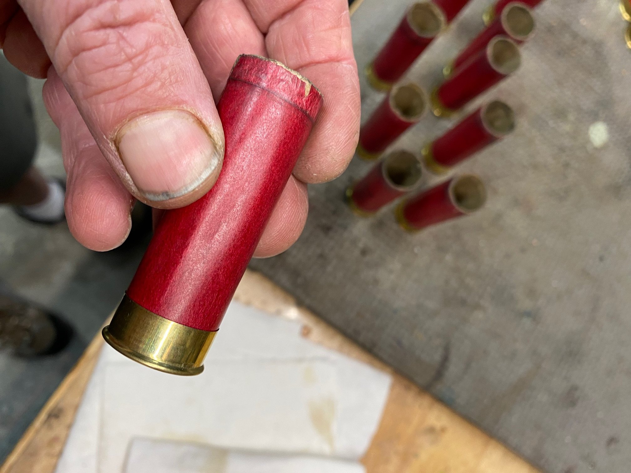

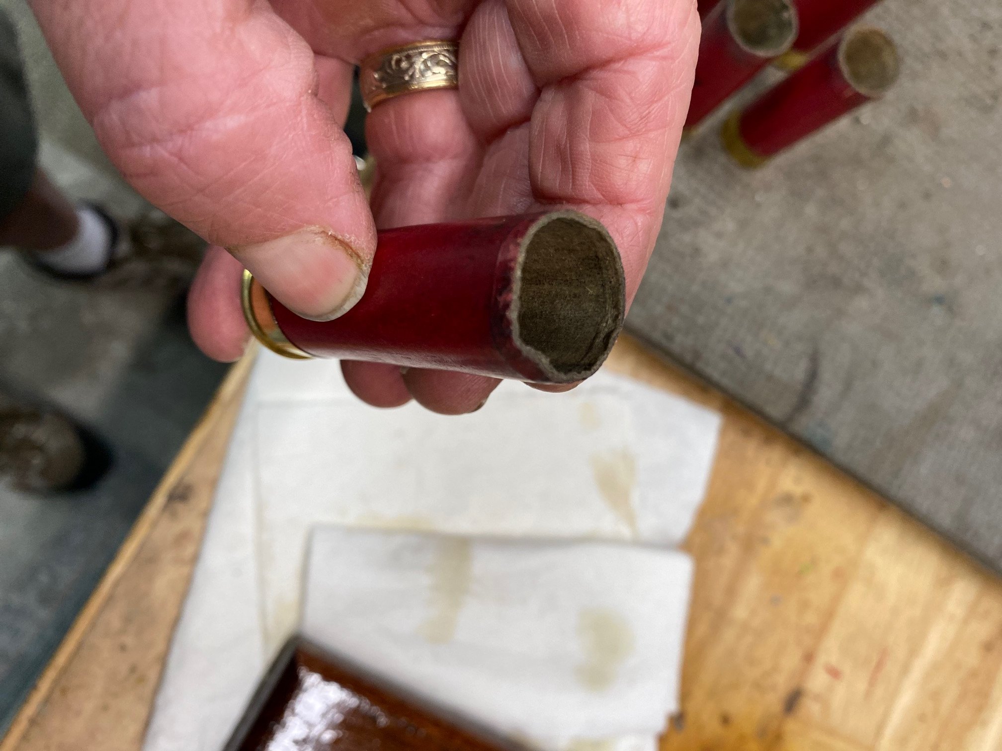

Well it's been two weeks since getting my cast off from breaking my right wrist, so I decided I wanted to op test my Baikal. She shot perfectly, with no issues, both the ejection (modes if you will) worked. I shot it with and without a Limbsaver Recoil Pad. I will in the future be always using the limbsaver. The plastic butt stock was rough on the shoulder with even 7/8 & one ounce loads. I tested my 2 1/2 cheddite paper and 2 3/4 Win AAHS hulls. I use a Athlon Rangecraft Crono.
