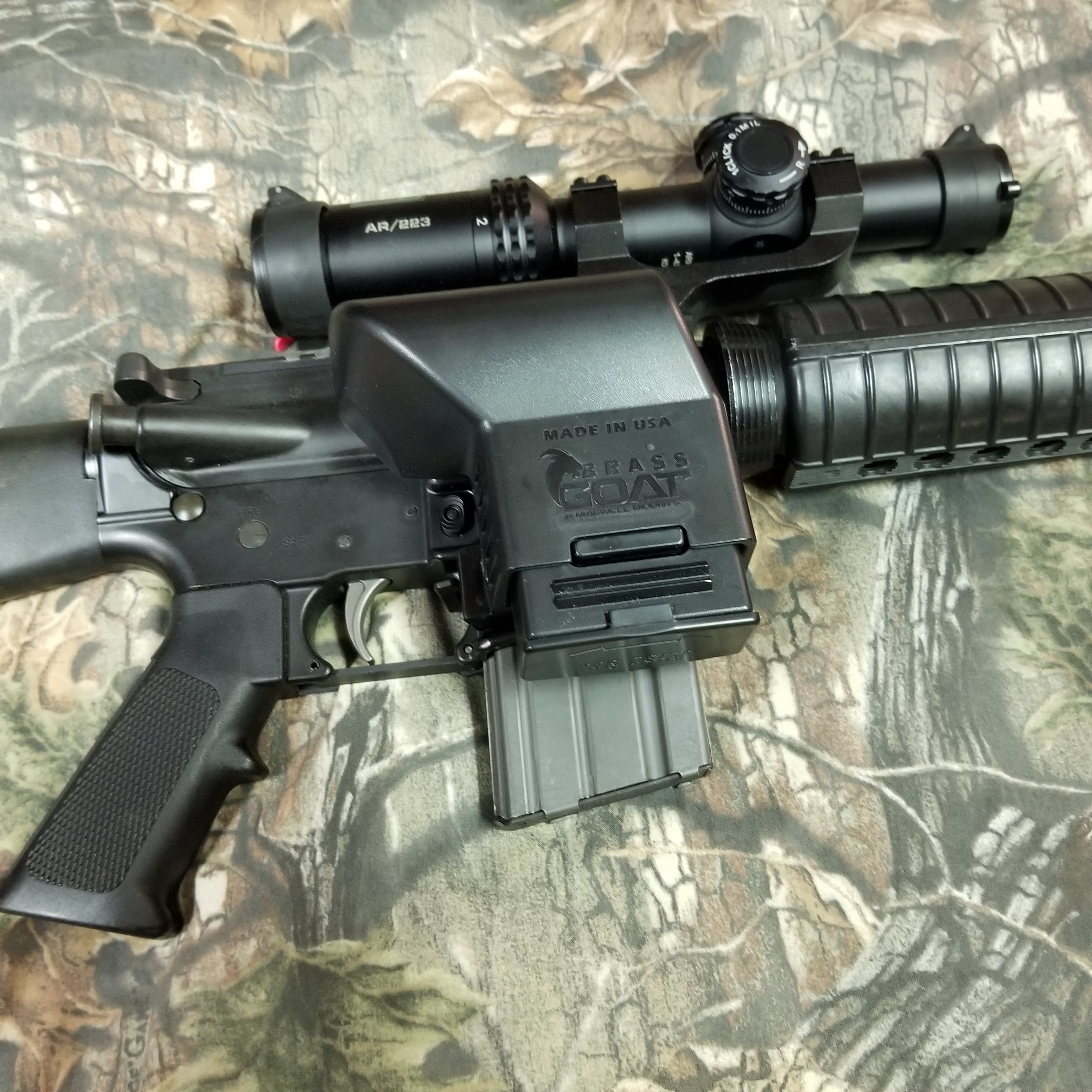

So, ads for this have been popping up on my feed for the last couple months. I decided to try one and it took until now for it to rise to the top on the priority list. It arrived yesterday.

The Brass Goat attaches to the lower and alleviates all issues surrounding optics, handguards, and upper type etc.
The only downside to the design is that it will only work on mil-spec lowers that meet mil-spec dimensions for magwell length and width. (see pics) And if you roll the rifle 90 degrees to port, gravity can cause the cases to roll back into the ejection port.

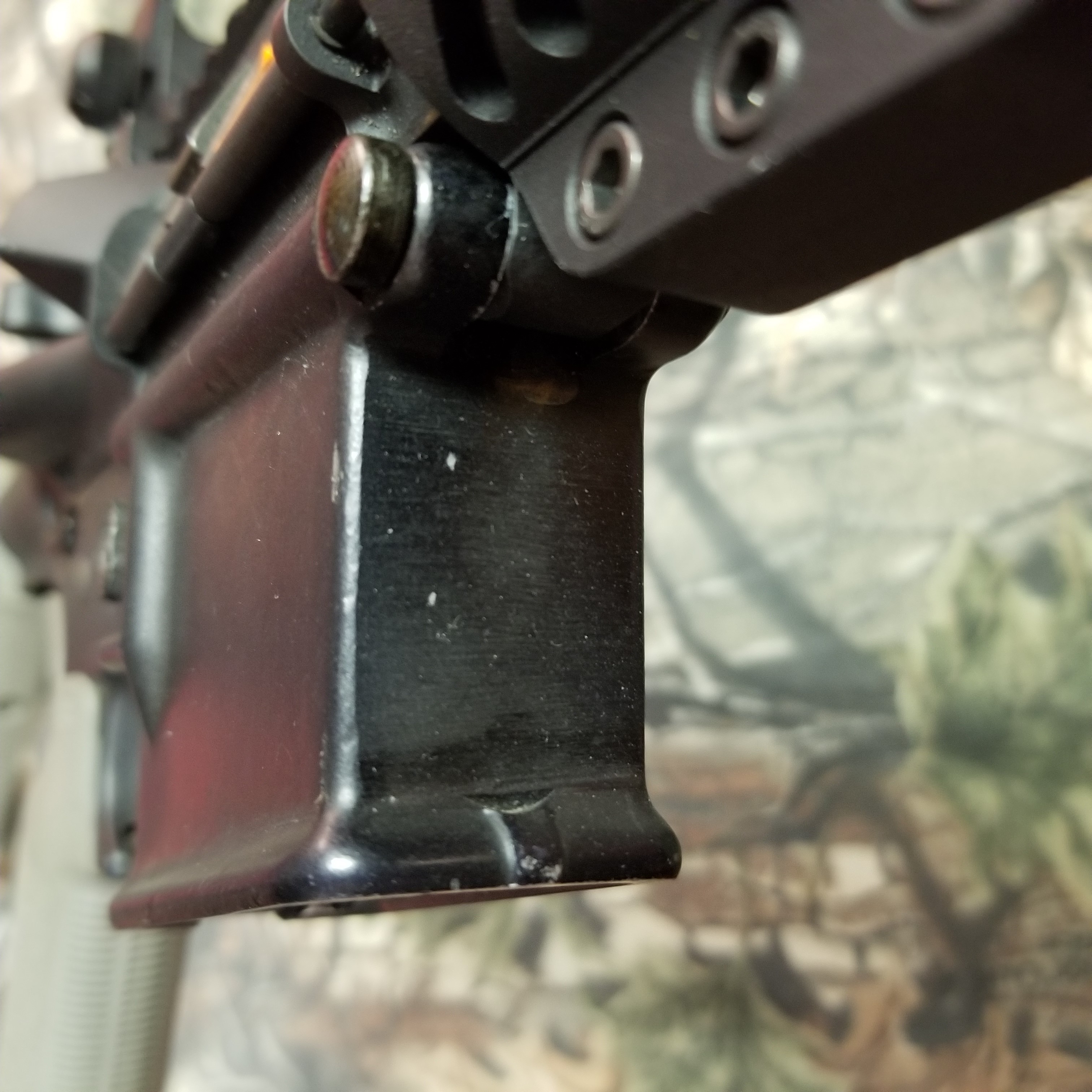

Here's the fit issue with the PWA receiver. You can see it doesn't fully click into place.
The removal of the forging seam appears to have been done by hand with a belt sander. There is a slight rounded shape instead of being flat. This could be fixed with a file if desired. They also left a remnant of the seam on the magwell lip.

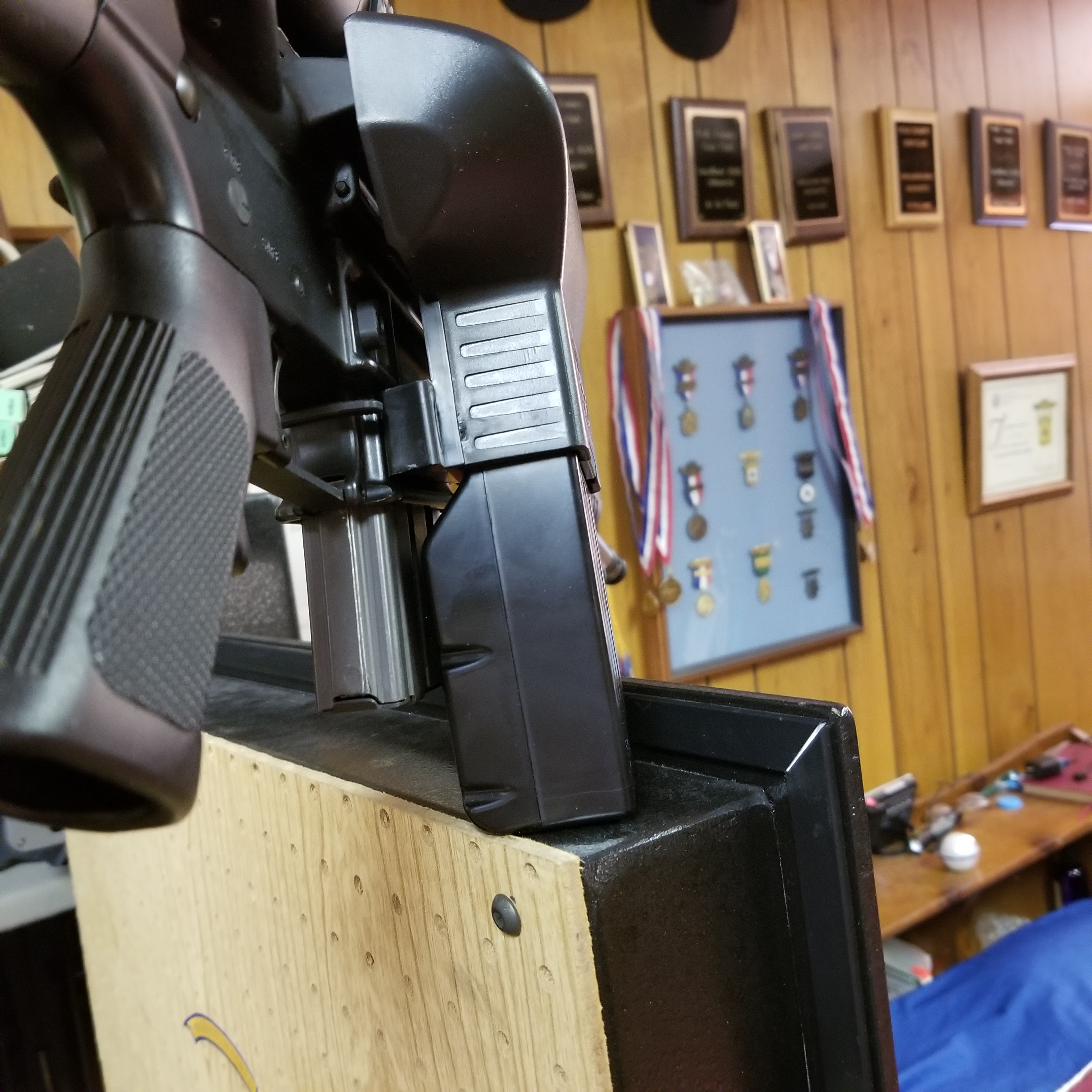

The catcher is supplied with a hopper rated to hold 30 5.56 cases. It is about 1" shorter than a standard USGI 30 rd. mag.
Rear view.
Rear view with 20 rd. mag.

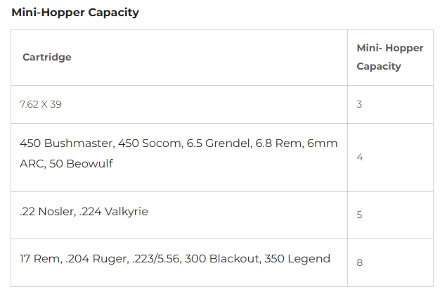

There is also a mini hopper that can be purchased separately or together with the chute and no large hopper. This would be useful for bench shooting or when shooting prone.
You can also remove the hopper altogether and the cases will be directed down next to the rifle.
Case capacities for the mini hopper.
