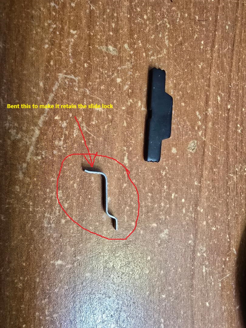

I ended up taking the slide bar spring (on mine it's a little bent bar) put a bigger bend on it and retried,, after a couple of tries I FINALLY got it to rack all the way back, fire, rack back, fire, etc, etc,,,
It was definitely the slide lock spring NOT seated enough and also not having "enough bend" in it to make the slide lock stay in the frame.
Thank you to everyone, MikeDaddyH, Racer88 and Bongo Lewi.
