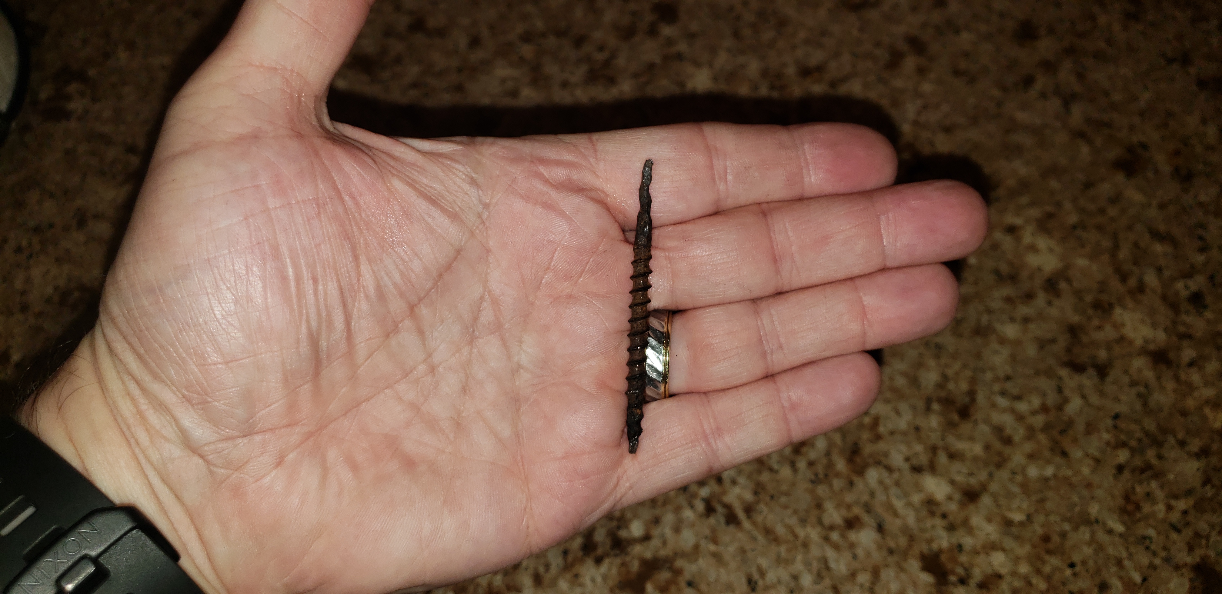

I just got done plugging my daughter's tire. Another amazing foreign object. It was a screw and it was LONG. I couldn't just pull it straight out. I had to unscrew it! This thing was ALL the way in... buried!
The plugging part went pretty easy. Reamed it. Put some adhesive on the plug and shoved it in. Trim off the excess plug. And test with soapy water. Done!

The Dynaplug makes the smallest possible hole in the tire. Not a big fan of making a small hole in a pressure vessel bigger. I have used them probably 10 times so far. This tire was the first one that it didn't work on.
It was probably meant to be. The screw was an RCH from the edge limit for repair. These are V rated tires low profile tires so not a good idea to have a repair there.
