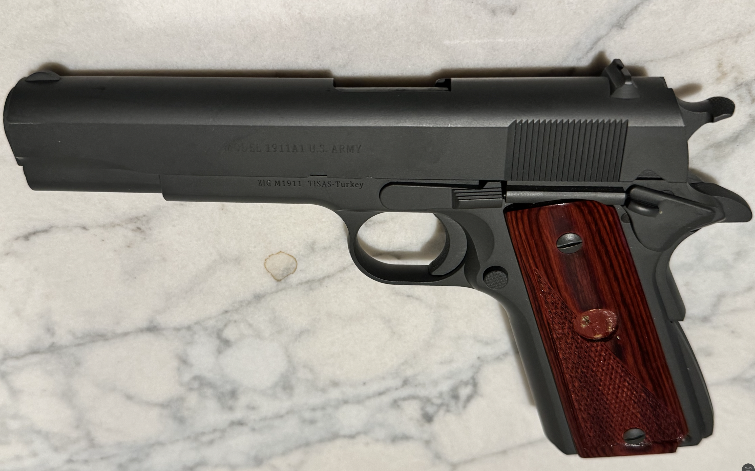

Same gun here. There's nothing bad to report about this Tisas 1911. Except the emblem on the grip panel fell out. It's a very good replica of the 1911A1. No frills. Parkerized. The only thing changed on this gun is I use Wilson Combat mags.

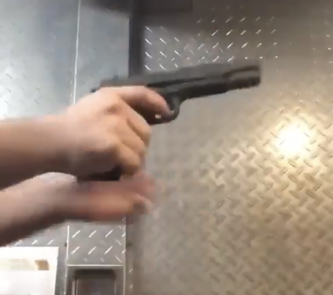

If installed this way, the slide won’t move rearward enough to chamber a round. I’m leaning more towards squib. The slide is definitely bulged under the ejection port. That and crap falling out of the magwell.
The slide looks canted to me. Hard to tell for sure because the video resolution sucks.
Agree that a view of the disassembled gun is in order. I'm sticking with mechanical failure caused by pilot error vs. squib.
I don't think that's coming from the muzzle, as crazy as it sounds. The shape of the fireball is not consistent with a muzzle blast... to me.
I slowed it down to .25X. And these are the two consecutive frame grabs. What's weird is the very flat side of the fireball in the consecutive frames.
Muzzle blast is usually observable when the barrel is flat. In the 2nd frame the gun is already in recoil / muzzle flip.
If there was a squib, none of the hot gas would be moving left to right as indicated in the right pic. Notice the muzzle flip. The pic on the left appears to be is gas escaping aft after the projectile left the barrel. Right to left.
It looks to me there's flame coming out both ends of the gun. At the time of ignition, if the gun were functioning correctly the slide would have moved rearward. A squib would have violently sent that slide rearward. It doesnt appear to move at all.

Another thing that may be a problem here for us observing a low-res video and trying to guess at the cause(s) might be optical illusion issues with digital photography:
View: https://youtu.be/wUXl56fqCrI
I can't go through it frame by frame with proper video software. I think the squared off flash is due to the weird way the camera records each frame. Video works similar to film but not the same. Could be AI generated?
Sliding back and forth, trying to see as much as possible, I can only see about 4 frames from trigger pull to dropping it. In one frame there is a bright streak going down and right.
Just not enough frames captured to determine what happened. The slide never moved is all I can tell. That doesn't make sense. Out of battery, it would move. Squib, it would move. Double charge, it would move.

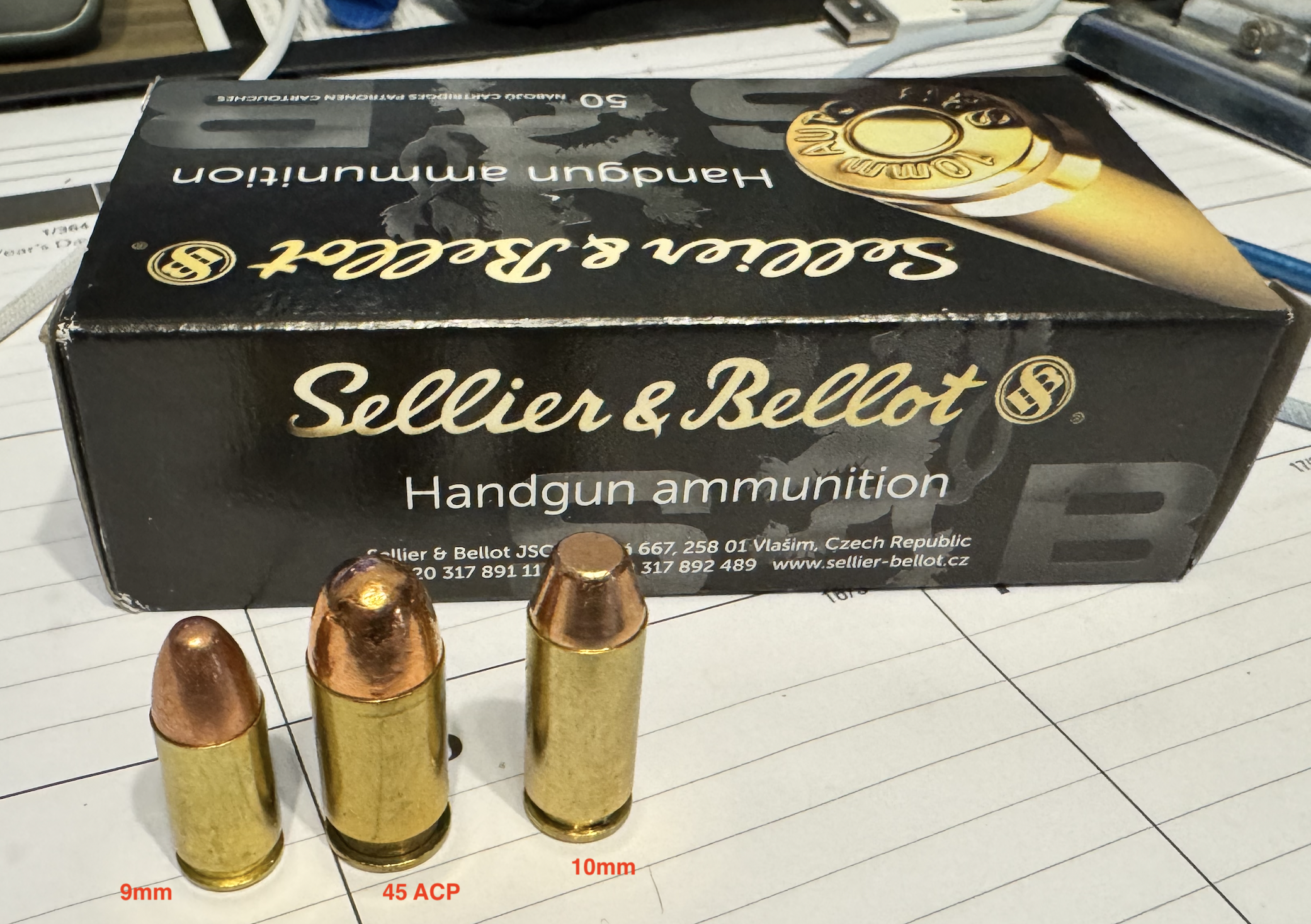

I watched this yet again and will posit another theory:
a. The S&B Ammo in the background could be 10mm, not 45ACP.
b. He was shooting two guns that day.
c. He inadvertently feeds a 10mm round into that Tisas 1911 (45ACP).
Hard to be certain, but the S&B ammo appears slightly taller and thinner than the squatty 45ACP.
