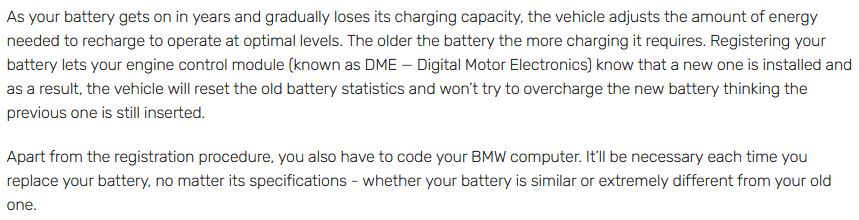

I think what they are talking about is to "register" (code) the battery in the PCM which requires the special tools and extra time which costs extra money...

So what's the bullshit about "registering" the battery?
While I've not been in the industry for quite awhile now (I left around 2000), and not at this level of modern tech, it seems there is some sort of "registration" that is done into the PCM through a programmer tool or laptop with the program to do so. It's not "hokum", but I cannot tell you how much it makes a difference or not. It's a given that the vehicle will indeed function with or without the input. But yes, it's real.
Is it a BMW thing? The quoted text seems to indicate that. Or is it other marques? All cars? I've never ever heard of such a thing.
ETA: I've been researching my own '24 Subaru. No such procedure / "registration" is mentioned anywhere.
I don't think every marque uses it, and I'm assuming it may be the upscale brands. but I cannot be sure. like I said, its been 24 years since I left that industry. Our 2003 530i I THINK had that in the programming, but I'd never been faced with swapping-out the battery while we had it. I did a number of maintenance projects on it- plugs, etc (and others I farmed-out), but that wasn't one of them. It does sound familiar, and perhaps my Foxwell scanner for BMW/MINI has that capability, But I never looked.

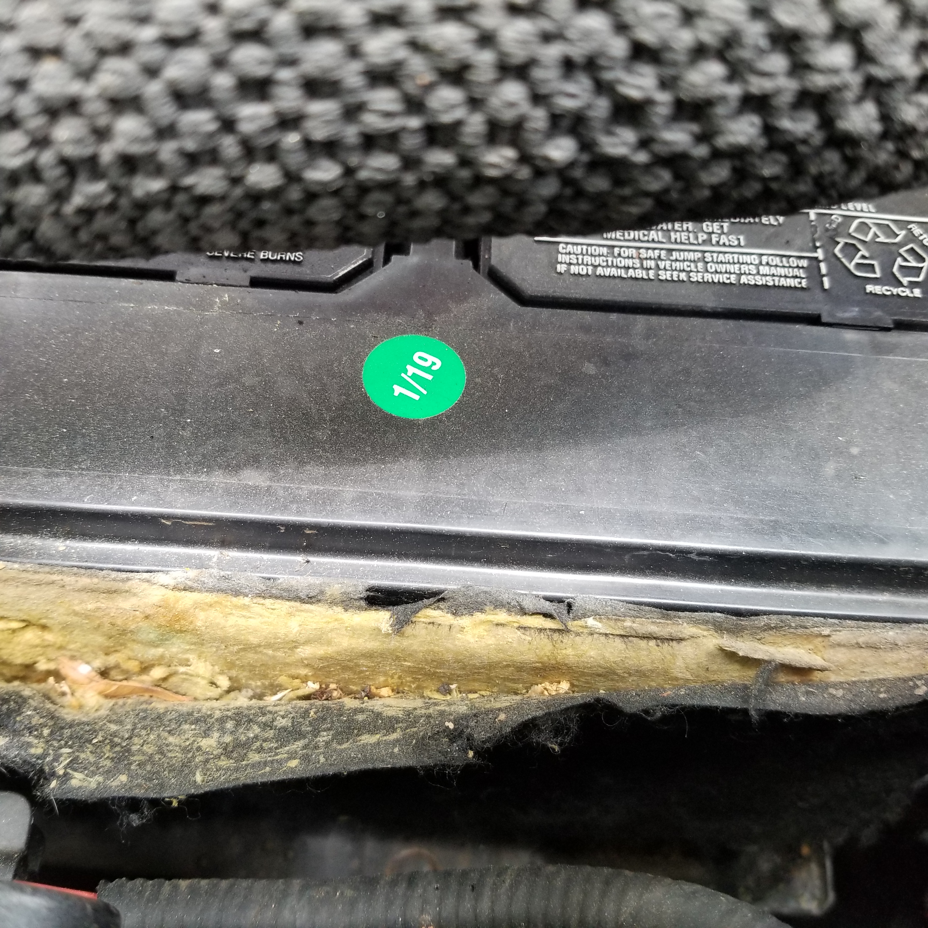

In the course of doing my periodic charging, I took note of the age of the two oldest batteries at the house.
The first one is in a G20 Chevrolet Van. Sits more than driven, so it needs the bi-weekly charging.
This battery was installed in Feb 2017. 9 years and still kicking. Not saying it won't crap out tomorrow, but right now it's not showing any signs of slow cranking that typically signals the end.

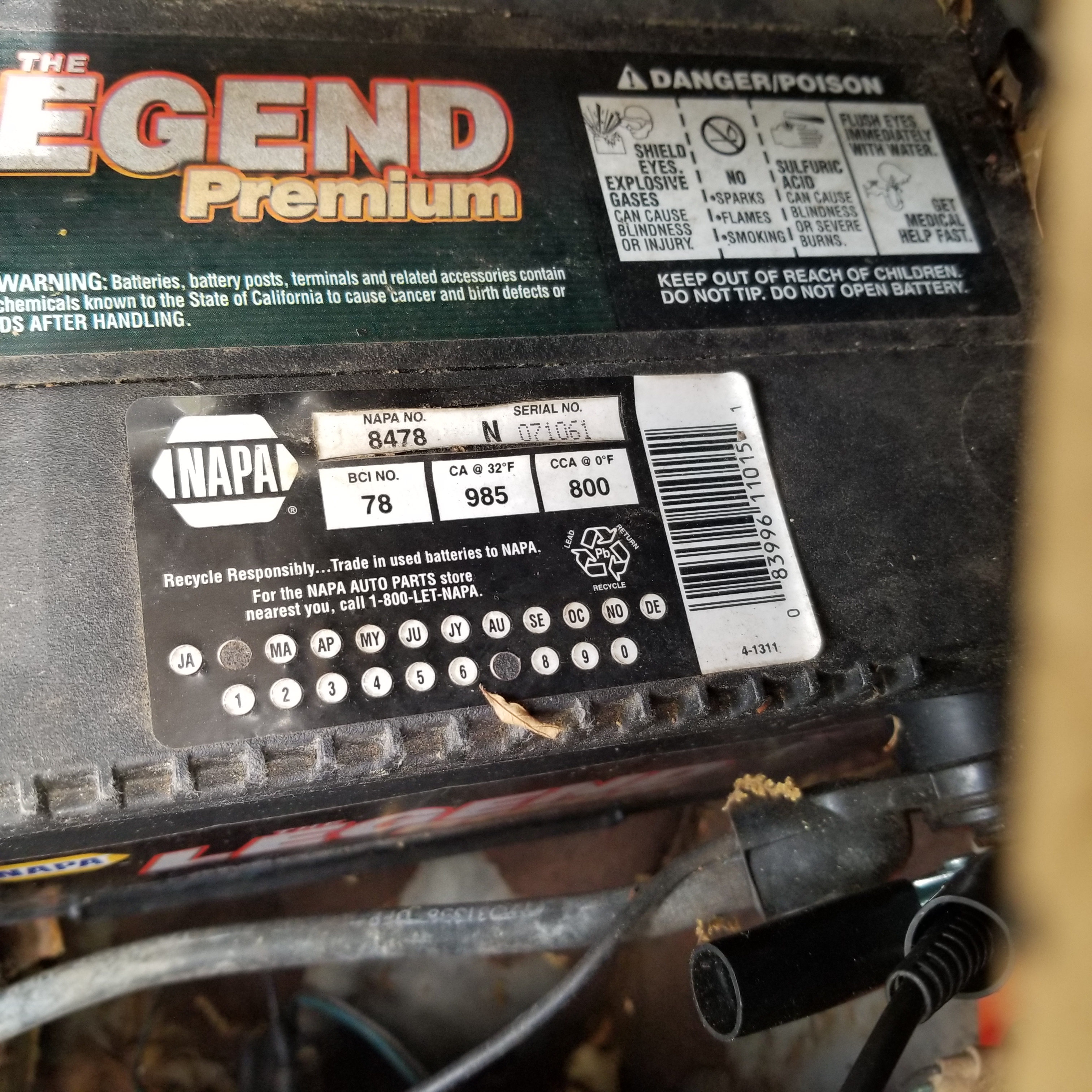

My cousin is lamenting his Optima blew out after 10 years. :rolleyes: It didn't fit his Caravan so he stretched the cables and in doing so, I think he tweaked the post because now it is leaking out. :eek: :rolleyes: Lead is not steel--it does not take kindly to abuse or extreme torque.

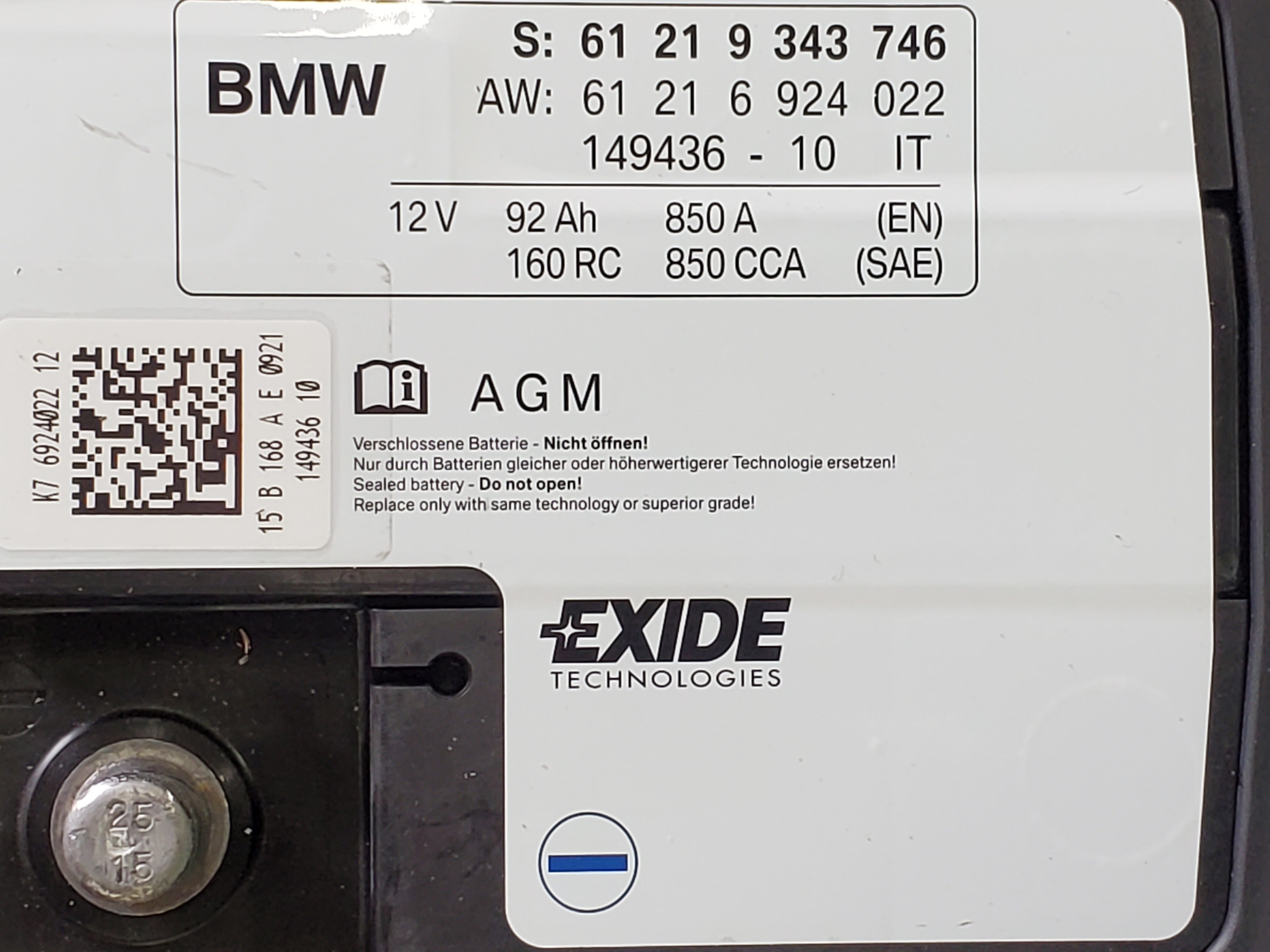

BMW uses Exide batteries. It is quite common for them to last 10 years or even more... like this one from mid 2015 I pulled out of a customer's car today.
I don't know if it is just a high quality battery or the cushy life riding around in the trunk or intelligent charging control that makes them last so long but finding this old of a battery in a BMW is not unusual.
This customer came in for a check engine light and did not have any complaints about starting the car. I noticed a slow crank when I brought it in and found a couple of undervoltage faults in addition to the thermostat fault that turned on the light.
