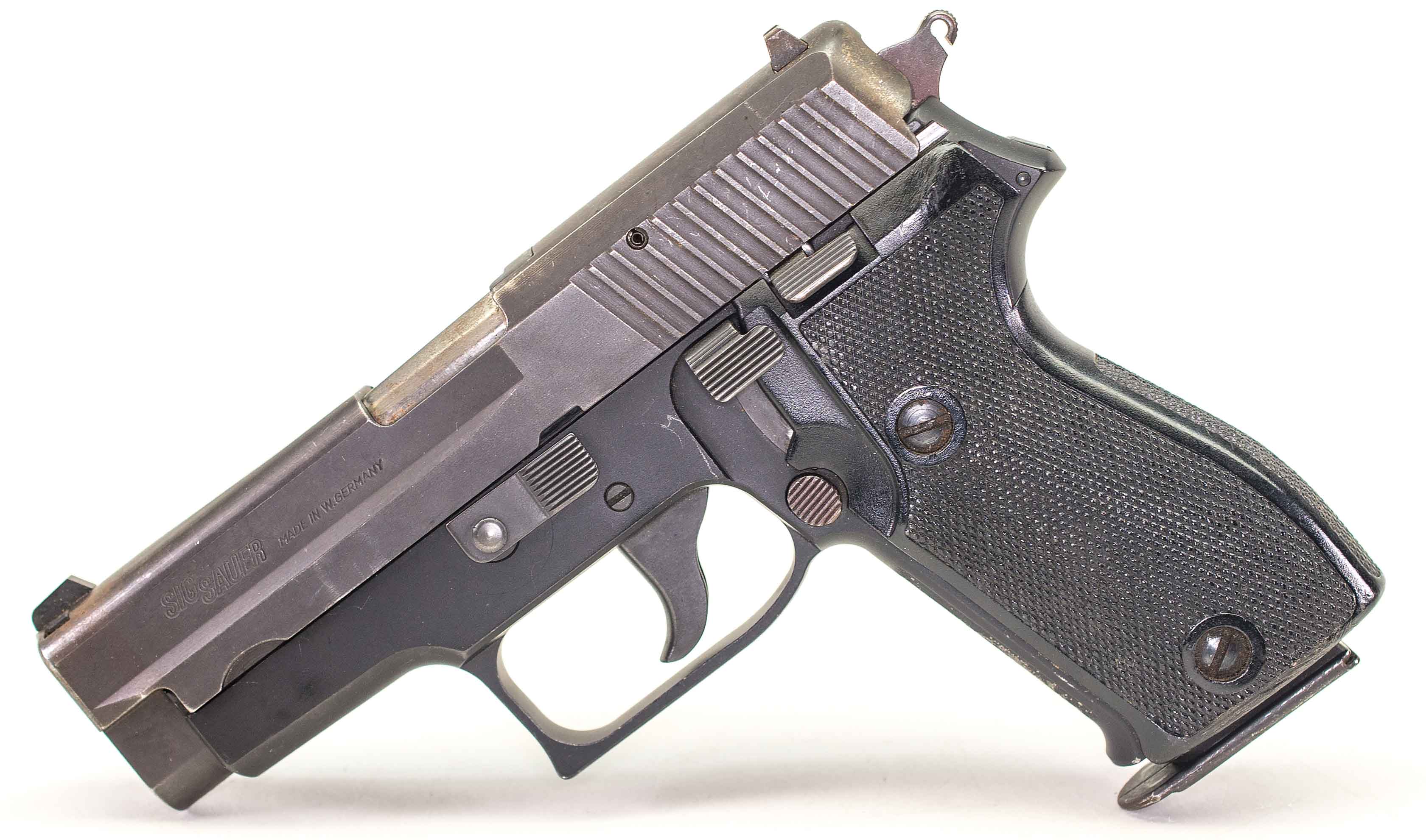

In restoring a Sig P6, I could not find a source for the unique forged hammer they put on that model. See pic. A P225 hammer would work fine and they were readily available, but it is a MIM part and didn’t have a hole and slot shown in the photo below. I bought two and cracked them trying to replicate that hole and slot. In the process, I muttered obscenities that would make a Marine Corps drill instructor blush.
