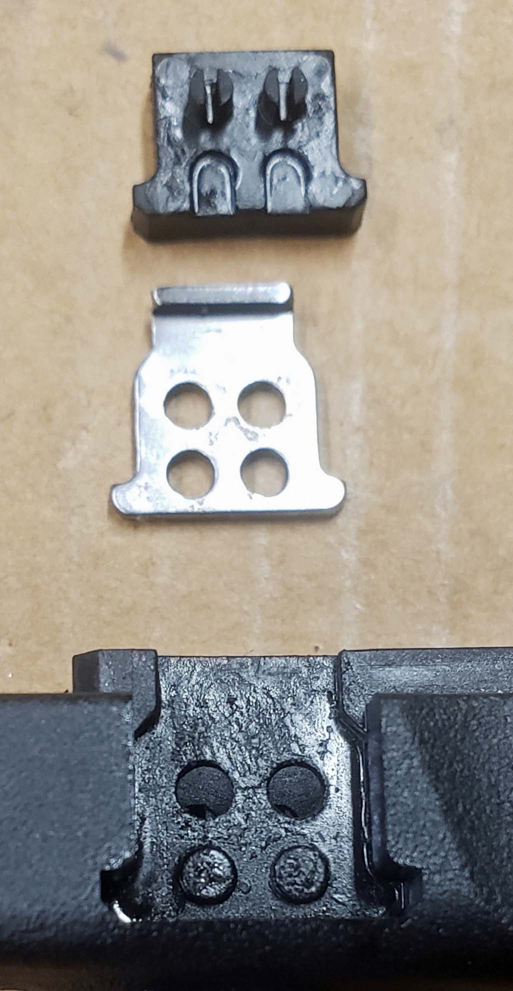

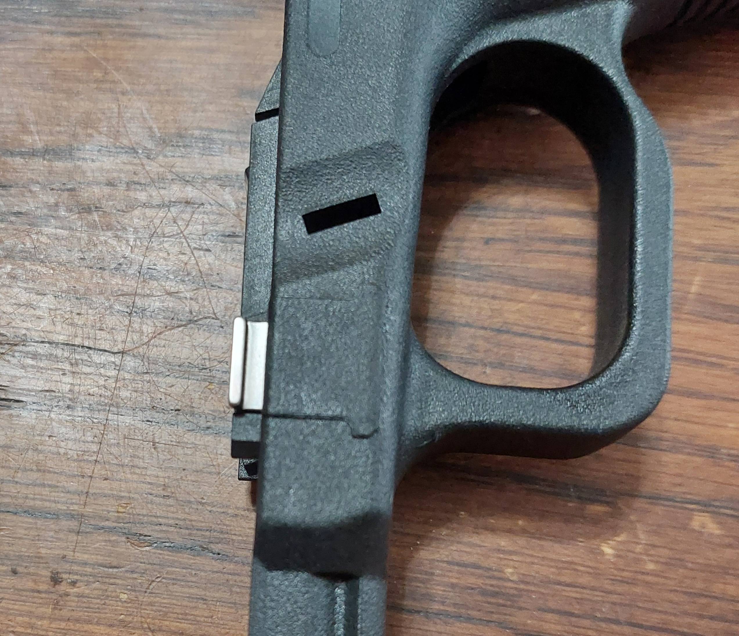

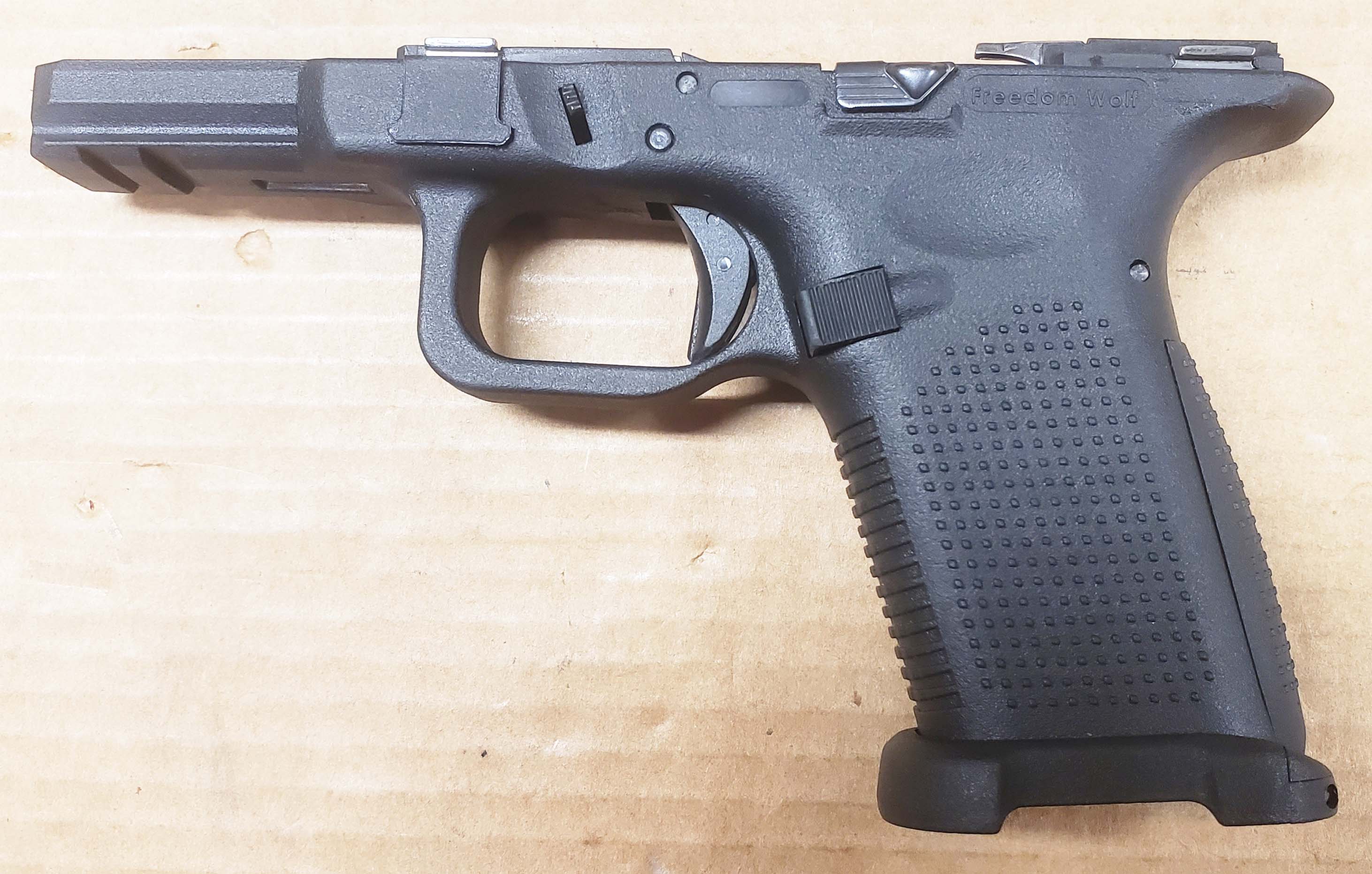

I was planning on using this frame for an upcoming steel shoot. While looking it over, I noticed one of the rails had come loose! :eek: Initial correspondance with Lone Wolf and they are like "just glue it back on!" :rolleyes: I took great pride and care putting it together with plenty of time to dry. And the Loctite glue recommended is almost $30 for .1oz! :eek:
I replied back with something to the effect of "How many people have been hit in the face with a slide from this issue?" And some other potentially sour notes. I'd be OK with a credit to get a serialized frame from them at a discount but I don't think that is happening ("we don't swap unserialized frames")...
So what do you all think? I'll update with any good news but I'm thinking this will be my last purchase from Lone Wolf... đź–•

So, the only thing holding the rails in is glue? No pins?
I had the same question but more of a "WTF - glue?" I know industrial strength bonding materials exists and can do wonders, but somehow gluing metal to polymer doesn't seem like something I'd want to rely on for something important or are there other rails on the frame pinned in place and these are just additional support/guides?.
Yes... there is some amazing adhesive technology out there. Even some car chassis are GLUED together.
The methods used to repair or salvage FUBR frames can be used to repair this as well.
Welding with soldering iron and used tabs and even JB welding it all on top of it.
Even if one has completed frame and no issues yet, drilling few small holes around the perimeter of the tabs and then filling the border with superglue and baking soda and then sanding it all up to reinforce it.
Wearing safety glasses is definitely a must at the shooting range with it.

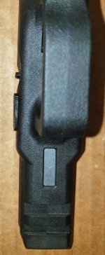

No. All the rails are glued in. Yes, you are gluing metal to polymer, but you are also gluing polymer to polymer. I can't help but think that the OP's problem isn't the frame or design, but an adhesive or assembly problem.

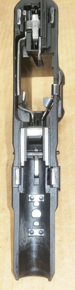

See(ing) those pictures helps. It is glued to hold it in place, however, there is polymer frame which is also backing it up. I was envisioning something glued to the top of the frame. I like the P80 pinned rail approach better.
Possibly a surface contamination issue... causing a failure to bond?
That would be a possibility. I admit, I don't have more than 5-600 rounds through any of the Freedom Wolves I've built, but I'm pretty sure the frame would break before I could break the bond of those rails.
I have built three, two 9mm and one 22LR. Not problems with glue not holding. I used Loctite 380. This is the strongest epoxy I have used.
The only way it wouldn't hold would have to be 1- not enough glue used or 2- have a contaminated surface with oil or acetone.

UPDATE: LW recommended Loctite 380 or Vibra-TITE, both found at zamazom.
They DID get back to me today and looks like they might be sending my FFL a bare serialized frame. :) Since Bidet "outlawed" them, they got out of the 80% game so any Freedom Wolf frames you find will be old stock.
I get you'all pointing fingers at the OP or more specifically the OBOB (Old Boy Original Builder) for "errors assembling". :rolleyes: But this ol' boy is quite particular especially when it comes to building/repairing guns. The rail pockets and other parts were cleaned with alcohol, glue applied to all the mating surfaces, frame was clamped in a vice, and allowed to dry for a couple days--as per the instructions. The glue was a black liquid in a little packet, I think--I can't remember and I lost my build pics from a HD crash.
I'm a firm believer in the "miracles of modern science". :) Maybe the glue they sent was sub-par? I do know it didn't last in the container I put it in when done, and hazed up and dried up like Super Glue does.
It doesn't look like there was much glue adhesion but there was definitely glue in there and every rail pocket as it oozed out as the rail and cover were squished into place, requiring a good amount of cleaning as I went. If I (had to) do it again, I would scuff up all of the mating surfaces to create more surface area for the glue to bond to...

That is defiantly a epoxy failure. I didn't use the glue that came with my FW because it was already setting up and two out three kits the glue had already harden. Thats way I used the Loctite 380.
Before I used Loctite 380 I did a test on some scrap polymer and there was no way that I could pull it apart so to see these rails just come apart has to be epoxy being old and bad.
Glad to hear they are going to make good on their problem.
From the looks of the rails, they could be cleaned up and reused as long as the tab pins are still in place.
isopropyl alcohol leaves behind a residue and should not be the go-to for adhesive preparation or any paint preparation. go with an aerosol paint degreaser or lacquer thinner or MEK. if you really wanna get wild cyanoacrylate primer prior to the gluing process. once glued properly these rails should never come apart.
