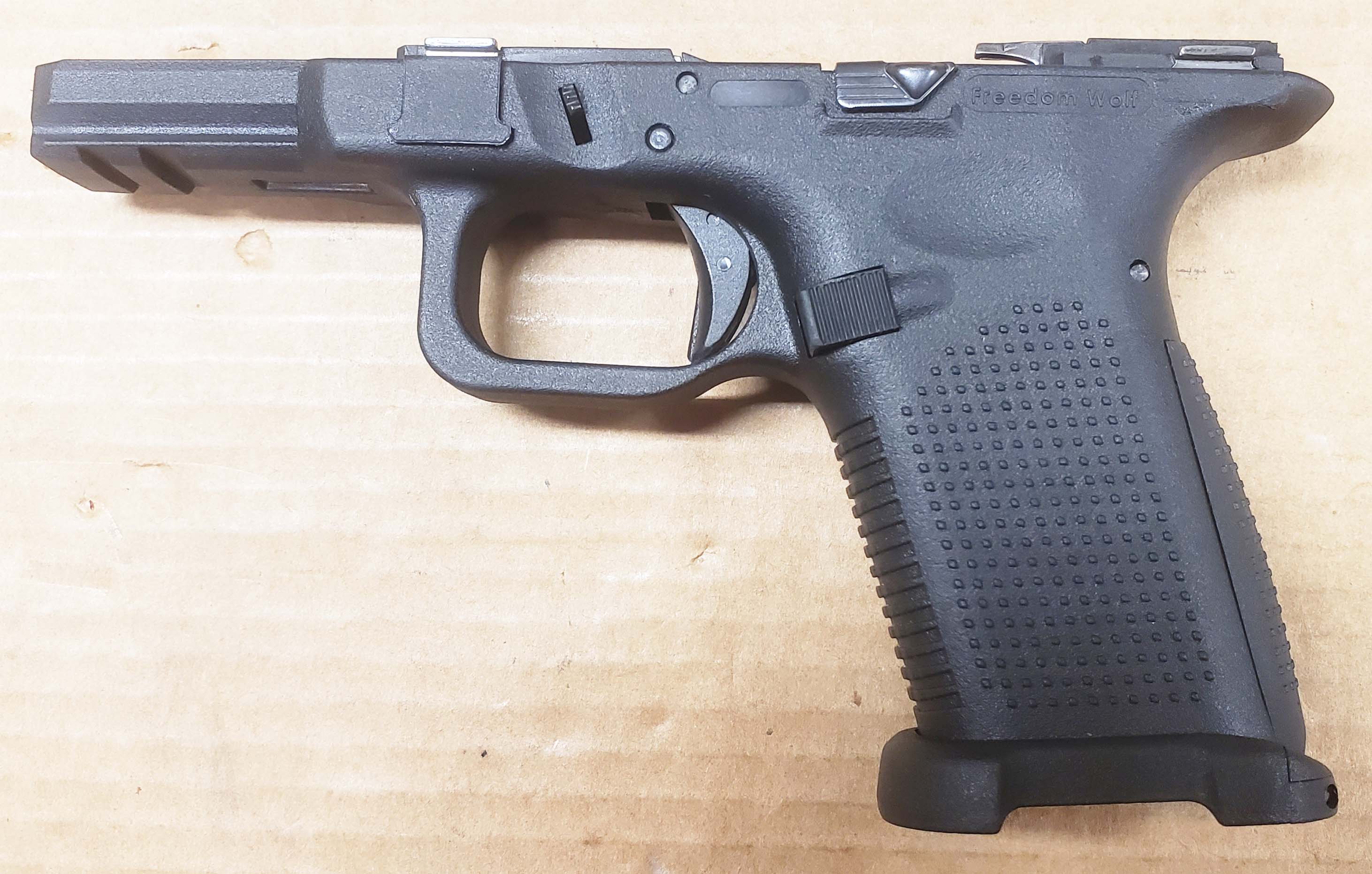

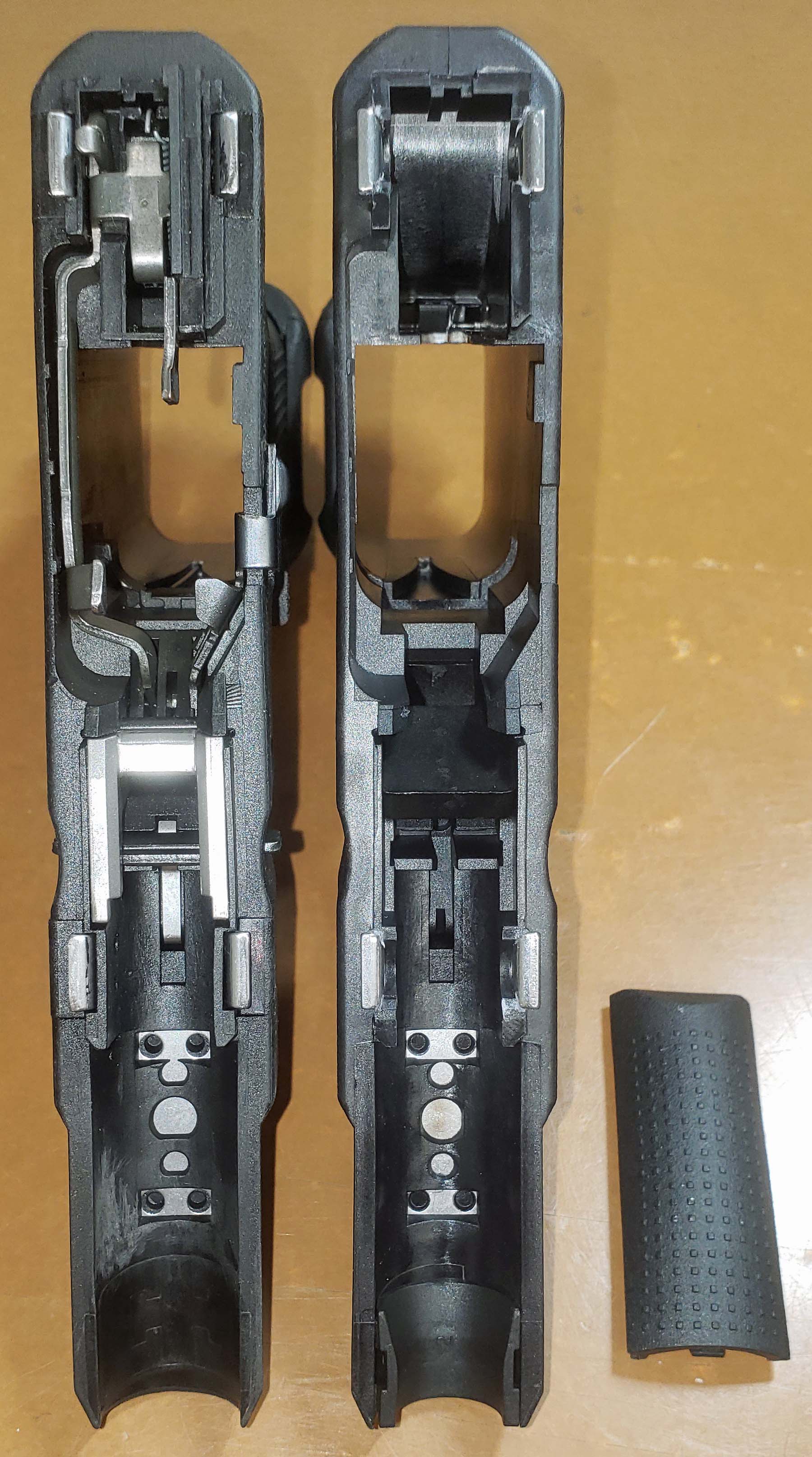

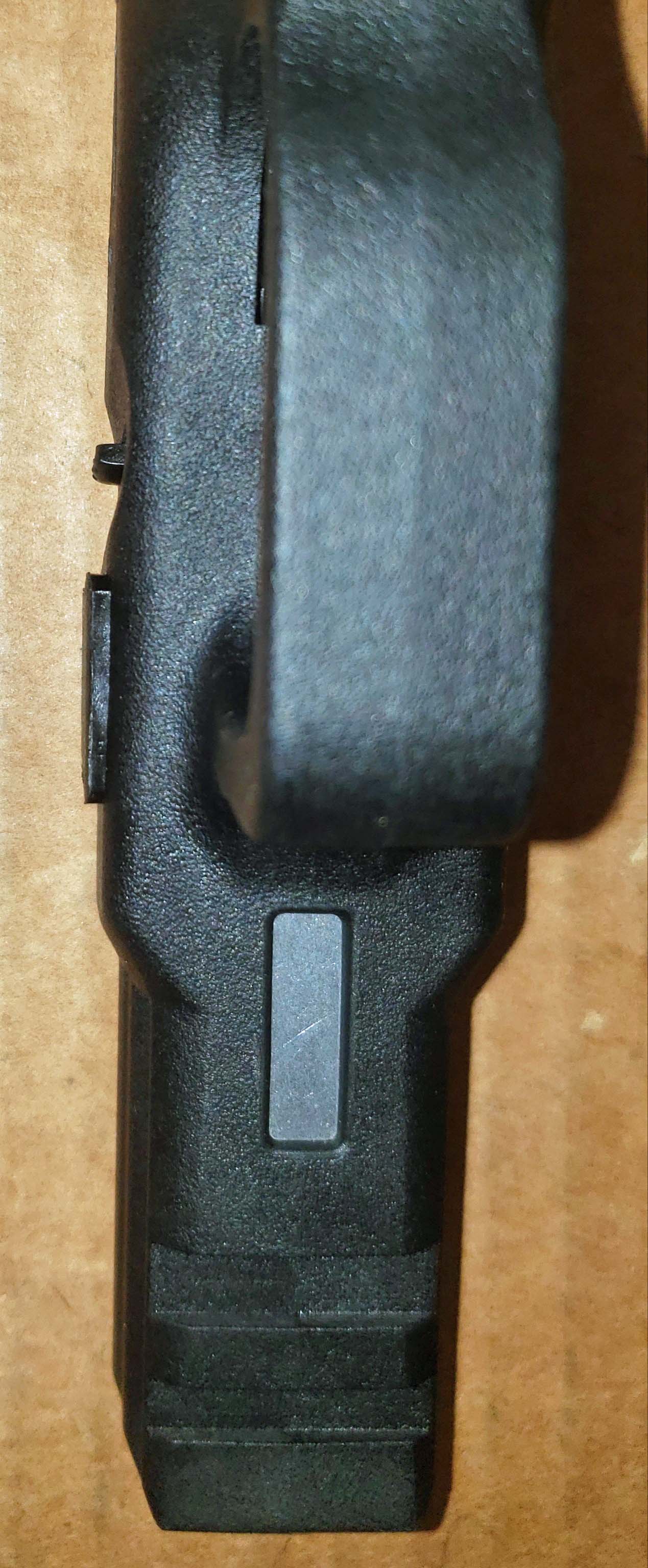

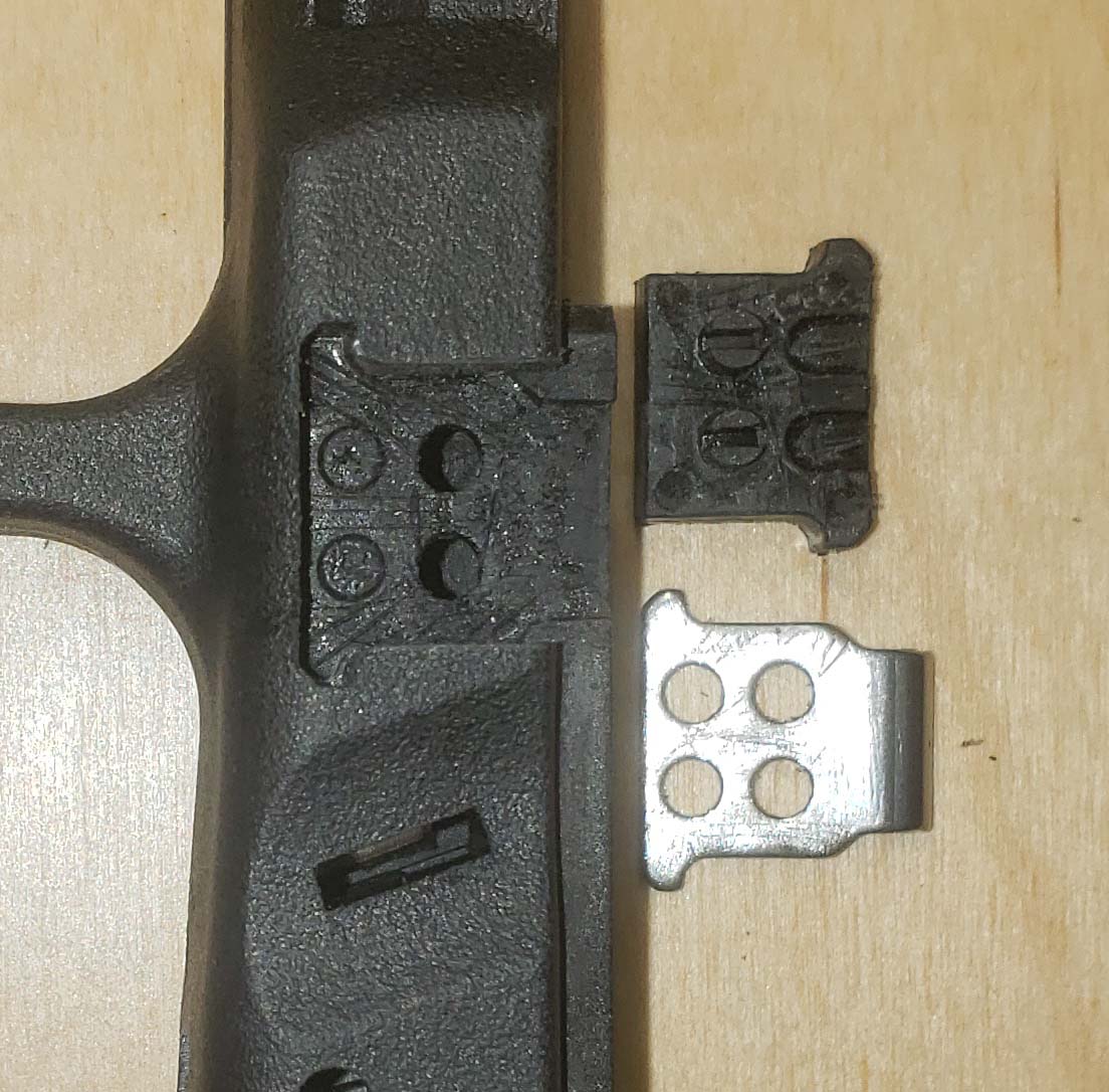

I was planning on using this frame for an upcoming steel shoot. While looking it over, I noticed one of the rails had come loose! :eek: Initial correspondance with Lone Wolf and they are like "just glue it back on!" :rolleyes: I took great pride and care putting it together with plenty of time to dry. And the Loctite glue recommended is almost $30 for .1oz! :eek:
I replied back with something to the effect of "How many people have been hit in the face with a slide from this issue?" And some other potentially sour notes. I'd be OK with a credit to get a serialized frame from them at a discount but I don't think that is happening ("we don't swap unserialized frames")...
So what do you all think? I'll update with any good news but I'm thinking this will be my last purchase from Lone Wolf... 🖕

That's some shady crap on their part. You might've got really lucky. I too wonder how many people their products have injured.

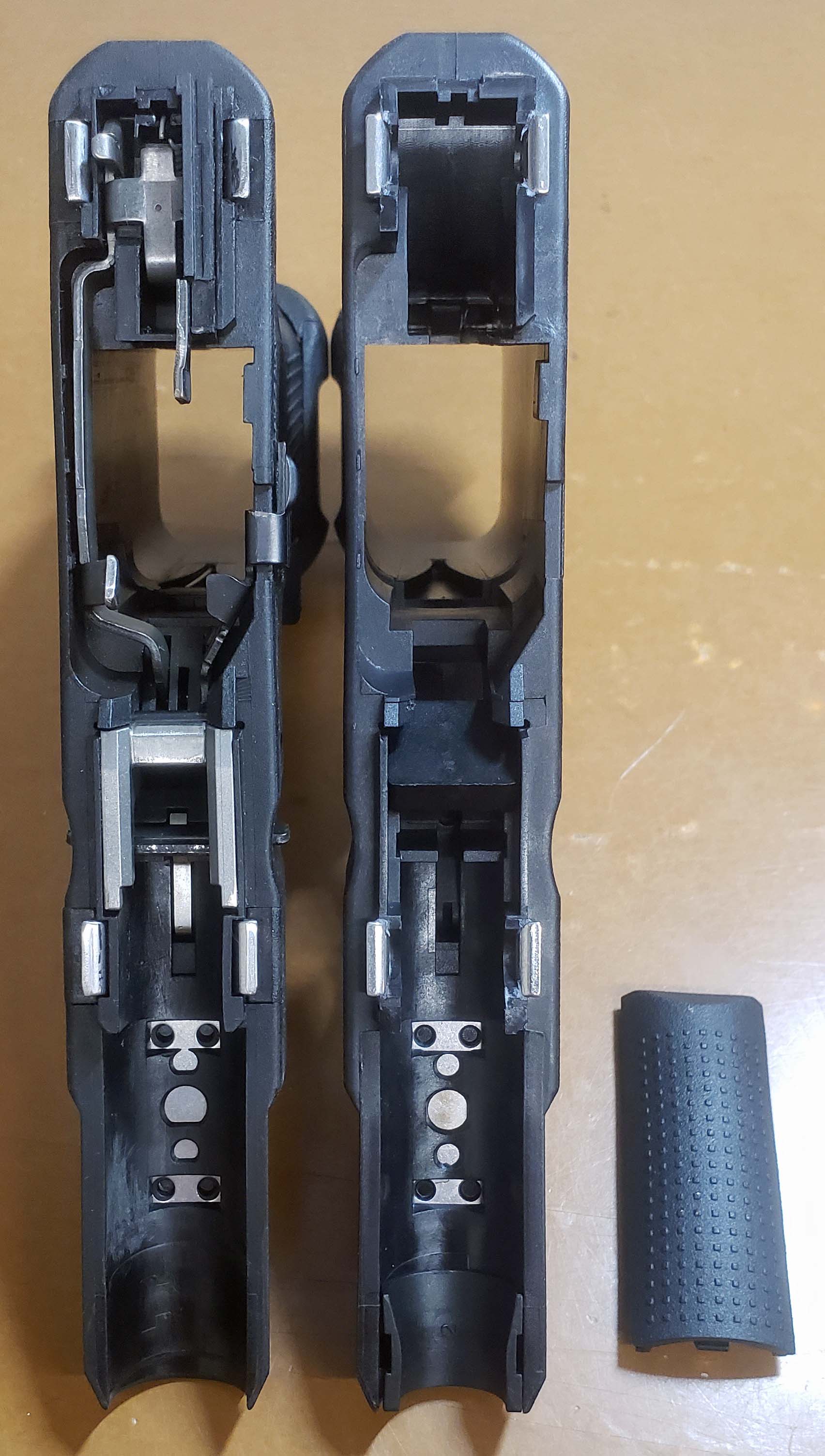

I thought I should update this post as Lone Wolf Arms provided proper satisfaction and customer service to me. I can't and won't guarantee anyone else will encounter the same level of service, but you could probably expect it. (y)
As an aside, I've been a LW customer for a number of years, having bought this frame plug for my Gen3 G30 back in 2008. :)

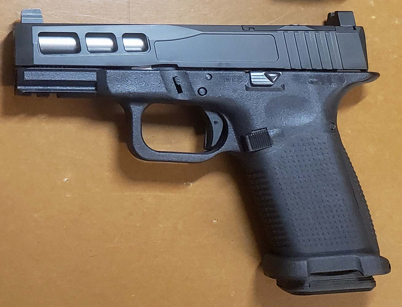

As described in my "Cereal-ized" thread, LW sent me a serialized TWC3 frame to replace the Freedom Wolf compact 80% frame purchased during a BF 2021 sales event. I also purchased a necessary "frame completion kit" at that time. You can find their parts kits at this LINK. They no longer sell Freedom Wolf (80%) frames but do sell different size serialized frames with or without parts kits.
The total for the FW back then was $122.50 to my door. (this was before FL decided to start collecting sales tax on internet purchases... 🙄 ) Update to today and add to that $10 for the transfer ($40/4), ~$218 for the PSA slide delivered, another $15 for the mag and the gun stands me about $366 not including labor. Let's say it took me at least an hour to build/troubleshoot it at my min. shop rate of $120/hr and soon you realize an 80% is far from a "deal". ;) Contrast that with the fact you can get a brand-new base Dagger compact for $300+ and you soon realize we aren't building 80% guns to SAVE money or to create a "throwaway" gun. :cool: But since we like spending each other's money, I would recommend getting the Dagger "deal" they offer with optics cut slide, 10 mags and case for $400. :)

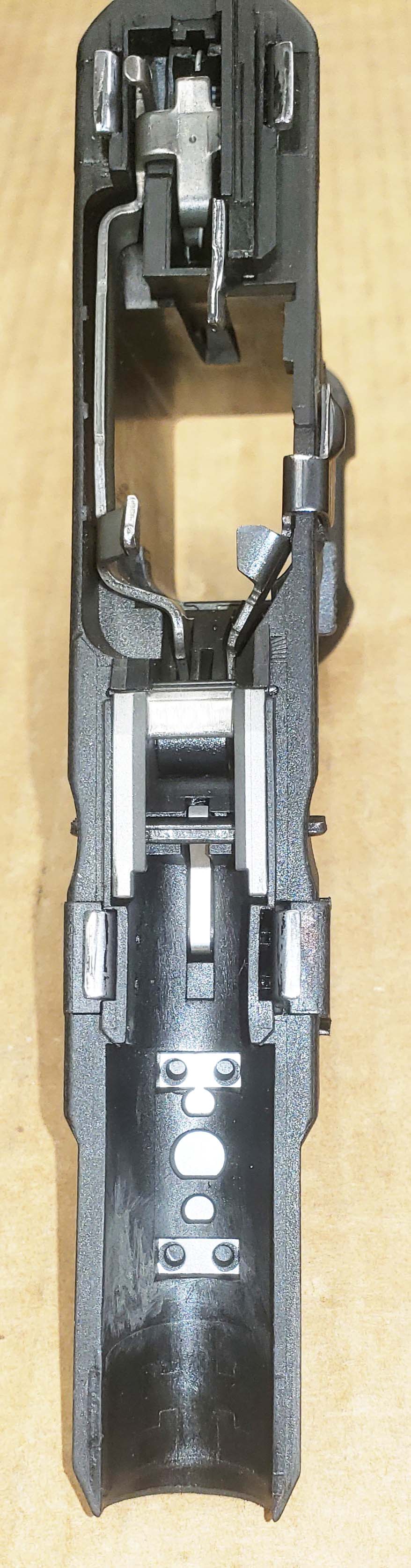

As shown in the pics, the frames are nearly identical. Pics are flash and non-flash. A few minutes to swap the parts over and we're now back in business. The new frame came with a curved backstrap which I installed. It also came with a little "square" that was installed where the locking block goes and removed during assembly. The 80% came with the same "extras". This is a Gen3/Gen4 G-19 size frame. Comes with a flat backstrap, I installed the curved. Also has a pinned-in magwell that functions well but impedes on pinky space (at least for me it does). Has a removable spacer in the dust cover for Gen4 slides. Gen4 parts are the mag release and rear trigger block so you kind of have to get LW's parts kit. I'm not sure if the LW block is the same as a Gen4 block but it does come with a "built-in" trigger travel limiting screw and wrench. Back then, I ended up having to use OEM Gen3 Glock parts in the FW but with their block (Gen3 doesn't fit) to get proper trigger function.
Fired a couple mags at the range and the new frame seemed to be working well. I need to get a better rear sight tool so I can replace the skyscrapers with some tritiums.

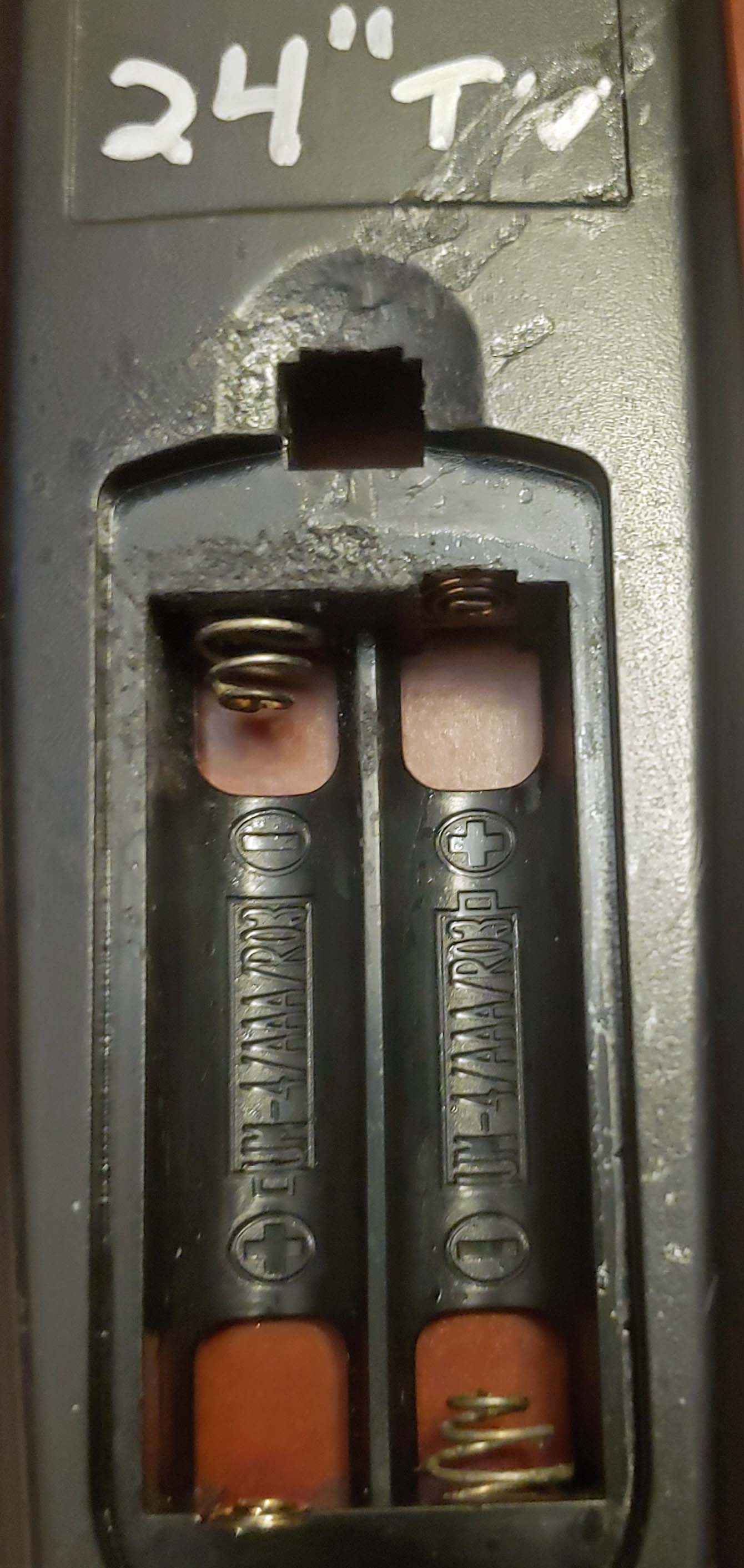

A little OT but since melty plastic was mentioned, I noticed my shop TV remote had a Rayovac battery (DO NOT BUY!*) that had melted down. I'm usually pretty good about removing batts from unused devices (I use the Roku remote with this TV), but this one was overlooked. Gave it a little spritz with Brakleen Red to clean the corrosion off the spring and noticed the plastic getting soft! :eek: Quickly blew it off with compressed air before it caused too much damage but it did damage it a little... :( Although Brakleen Red has many uses such as killing wasps and pepper spray substitute ;), cleaning plastic probably should not be one of them and I should have known better. I had a can of electronics cleaner right next to it... :rolleyes:
* regarding Rayovacs, I bought a couple few bulk containers of AAs and AAAs a few years back during BF sales. They sat on the shelf inside, climate-controlled for maybe 6-8 months until I needed one. Unfortunately, I found them melted down inside the NEW, UNOPENED package. :eek: Rvac said they would give me a total of $15 back keeping in mind I probably have $30-$40 into them. :mad: I've been having good luck with HF "orange" batts for the past few years and Rvac lost a customer for life...

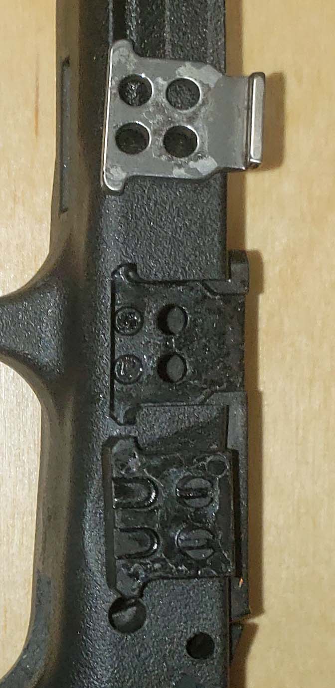

UPDATE: so I had the FW frame advertised "AS-IS" needing the rail re-glued on a local guntrader website for $100 firm. Had a guy hot on the hook, seemed legit, local town public works guy. Was "going to pick it up but had to work late" a few days in a row. :rolleyes: I don't chase buyers and I told him once the ad ended later that week, I was going to keep and fix the frame. That was a couple months ago and yet another item on my "list" of things that need doin'... :)

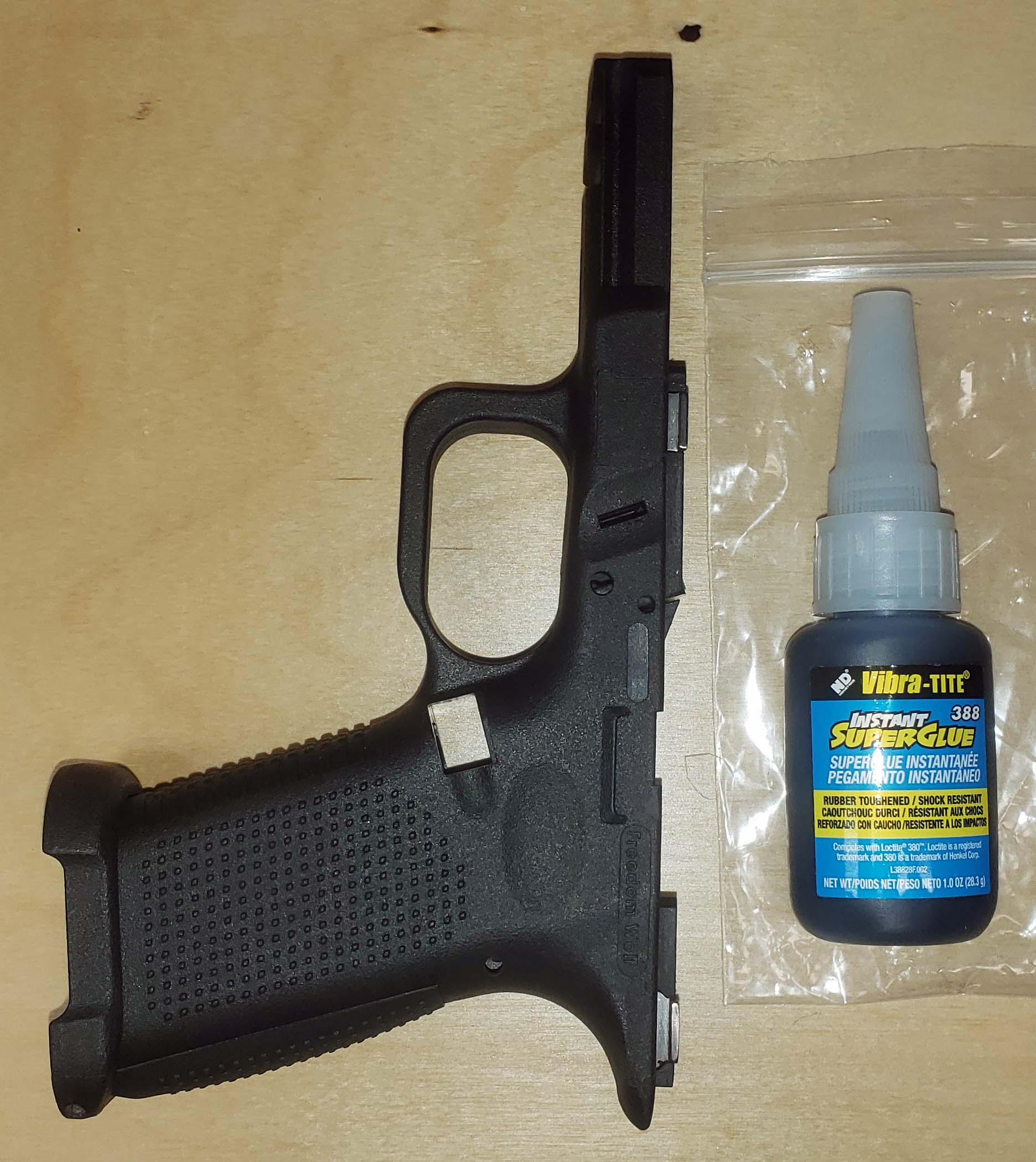

My dot's BF has Prime so I had him get the glue for me: $16? + sales tax, I gave him a $20. I will note that you get your money's worth--the bottle was filled to the brim! :) I had the glue in a day.
To refresh your memory, the rail came loose due to a glue failure. Lone Wolf graciously sent me a serialized TWC3 frame gratis "under warranty". Since I was doing a number of transfers at the time, the FFL only charged me $10. The TWC3 is identical to the Freedom Wolf frame and is a Glock 19 Gen4 style. It will also take a Gen3 slide with included dust cover spacer. The TWC3 is currently sitting in my son's glove box with a Dagger DLC black non-RDS slide on it.
I cleaned the old glue off best I could and scored and scuffed the pieces so the new supersuperglue could adhere better. I'm going to let it dry a couple days while I round up parts. I have a P80 940SC rail I think will fit and work if I can find it. Should have everything else to put it together. :) (maybe) Then I will test it with the Shitmos slide--that ought to stress it. ;) I think I still have some .40 reloads left...
UPDATE 2: Ended up temporarily swapping the trigger parts/block/PSA non-RDS DLC slide off the TWC3 into the FW to test the "fix" to the rail. I had swapped the OE LW trigger back into the TWC3 (w/3.5 connector) and it seemed to be functioning fine (I think :unsure: ) after a tweak . But back in the FW it proceeded to malfy. That was the LAST range session where I had intended to test the rail fix. :rolleyes: I got about 10rds through it before I called it done.
Since I had a Glock Precision Trigger NIB I figured I would put it in the FW temporarily to try it out. Although the GPT came with a Gen5 back plate, I put the Glock armorer's plate on this particular slide for testing and until I can get a replacement BP. This particular PSA back plate was EXTREMELY difficult to get off so I'm calling it defective. The GPT will not be staying in this frame as may be used as a LATSOAC gun... :D Don't want to be throwing away good money after bad! ;)
So today, after Public Day at my range (I'm a RSO), I tested a few guns, the FW being the only one to pass its test. The rail seems to be staying in place as are the other ones. I ordered a new billet block for the DaggerWolf and I'll take its block and trigger and put it in the TWC3 and I'll put the OE glock trigger that was in the TWC into this frame. I have another PSA slide waiting for a home.
