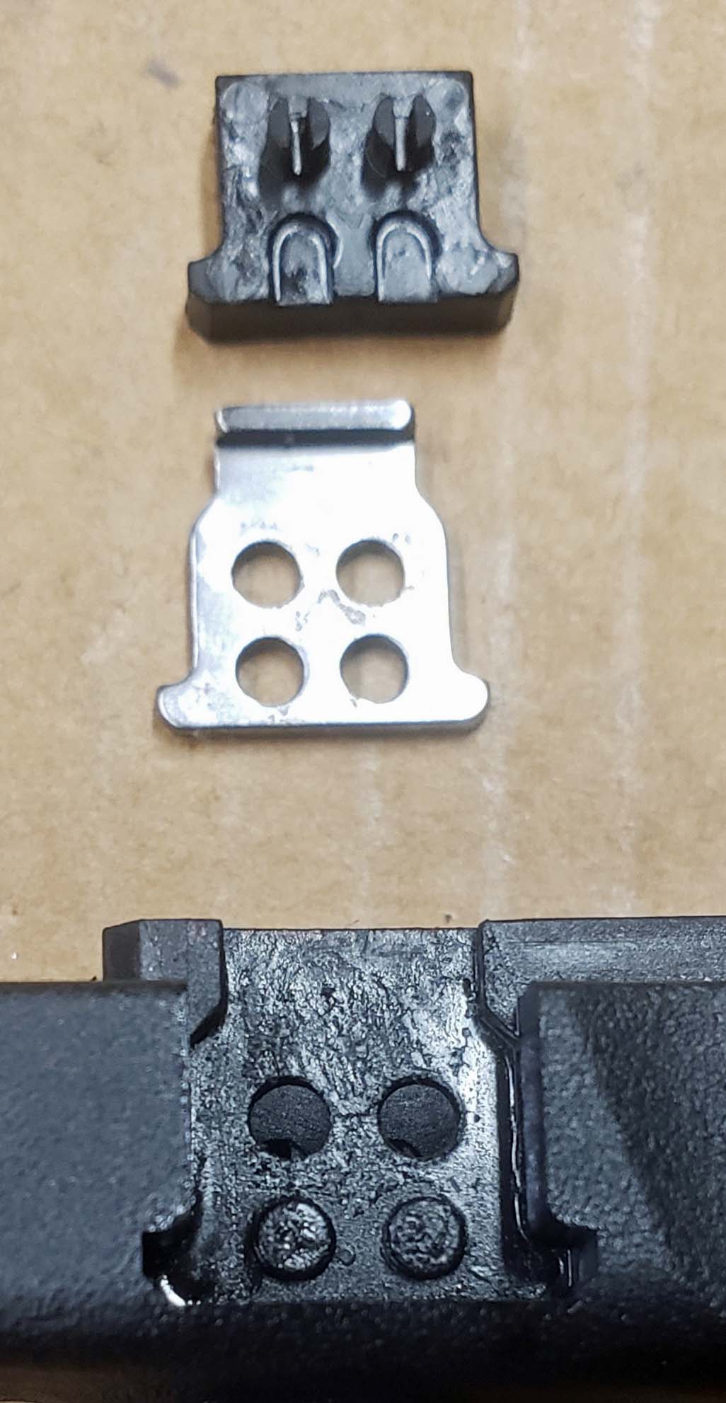

I have never seen a LW frame up close like this. Looking at this pic, I wouldn't trust that frame with somebody else's face. Bad design. I have a hunch they chose this because it's cheap and it's also possible that they didn't want to infringe on somebody else's patents.

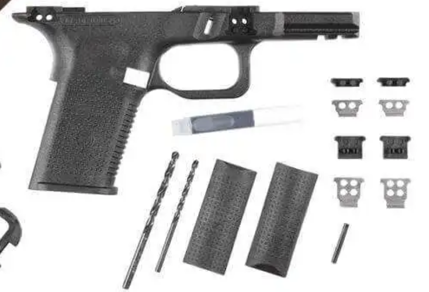

Curious, I poked around a little to see the entire kit when it was new. Their current serialized frames abandoned this design. There's no way I'd trust those nubs to not shear over time. The glue would mitigate some of that but metal really isnt going to bond molecularly to plastic. What the glue is doing is fusing the nubs and that cover plate together.
Well, they didn't abandon the design, they never had it. The Timberwolf has always had the rails molded into the frame, just like many other 100% serialized frames.

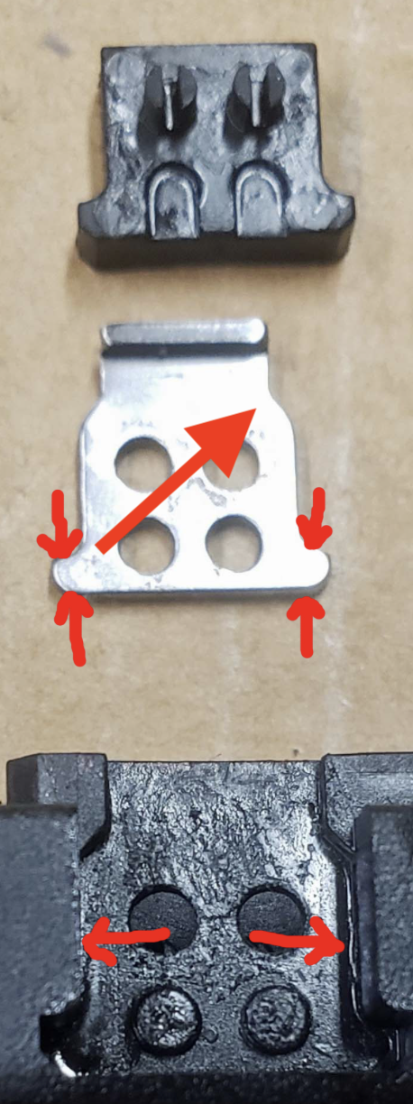

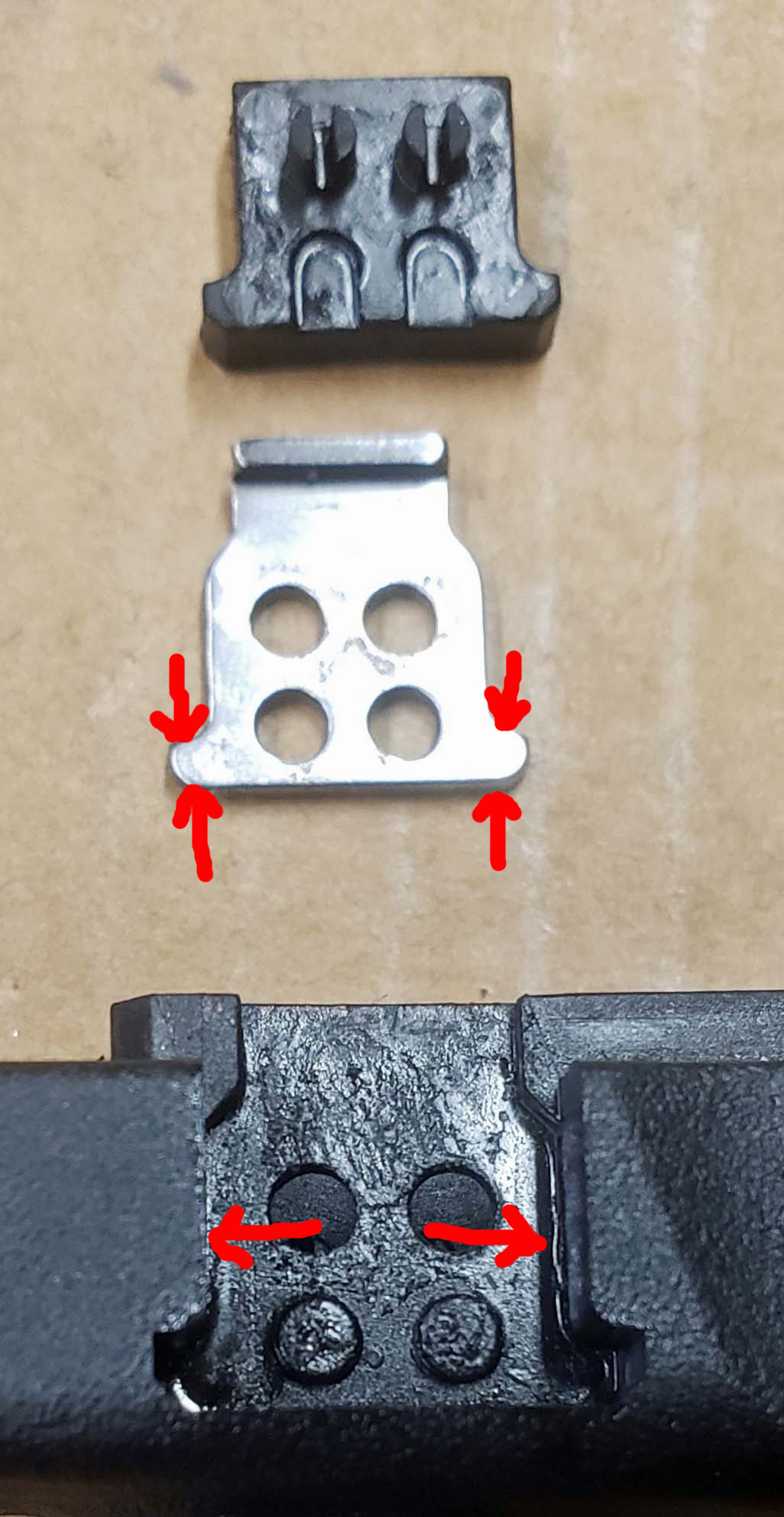

I don't think you all are considering the forces involved. :rolleyes: I see frictional forces front to back on the rails and inertial mass which is absorbed by the frame/RCA. Then there might be slight up and down forces on the slide when the barrel unlocks and goes out of battery but most of those are absorbed by the block and frame. Lateral forces I believe are negligible, maybe slight when the extractor and ejector do their thing to spit the case out.
Look at the pic and the arrows. Remember this part is recessed into the frame and the rail is contained within it. The forces are easily contained and if the glue does its job, it can easily handle any side load generated.

I think the load is mainly on the frame because the rail segments are recessed. If anything, the pegs ADD strength because it is four more areas in the frame to secure the rail. That is IF the glue does its job. Of course, a serialized frame may use the same rails, I couldn't tell you and I'm not cutting apart a frame to find out... ;) I'll add it to my list to "call LW to find out how the rails in serialized frames are constructed"... ;)
All true. But it sure looks like the metal rail was loose and buggered the surrounding plastic and pegs. That rail is taking load in all directions when the gun is fired. The lateral movement is less significant. The torque on the part is likely to include a twisting motion as well as the perpendicular or upward and downward force you show. How much depends on how much slop there is between the frame and the slide. In scientific terms, it's been wiggling every time you shoot the gun. And metal being the harder material, it's impinging the plastic on all sides for every shot fired.
