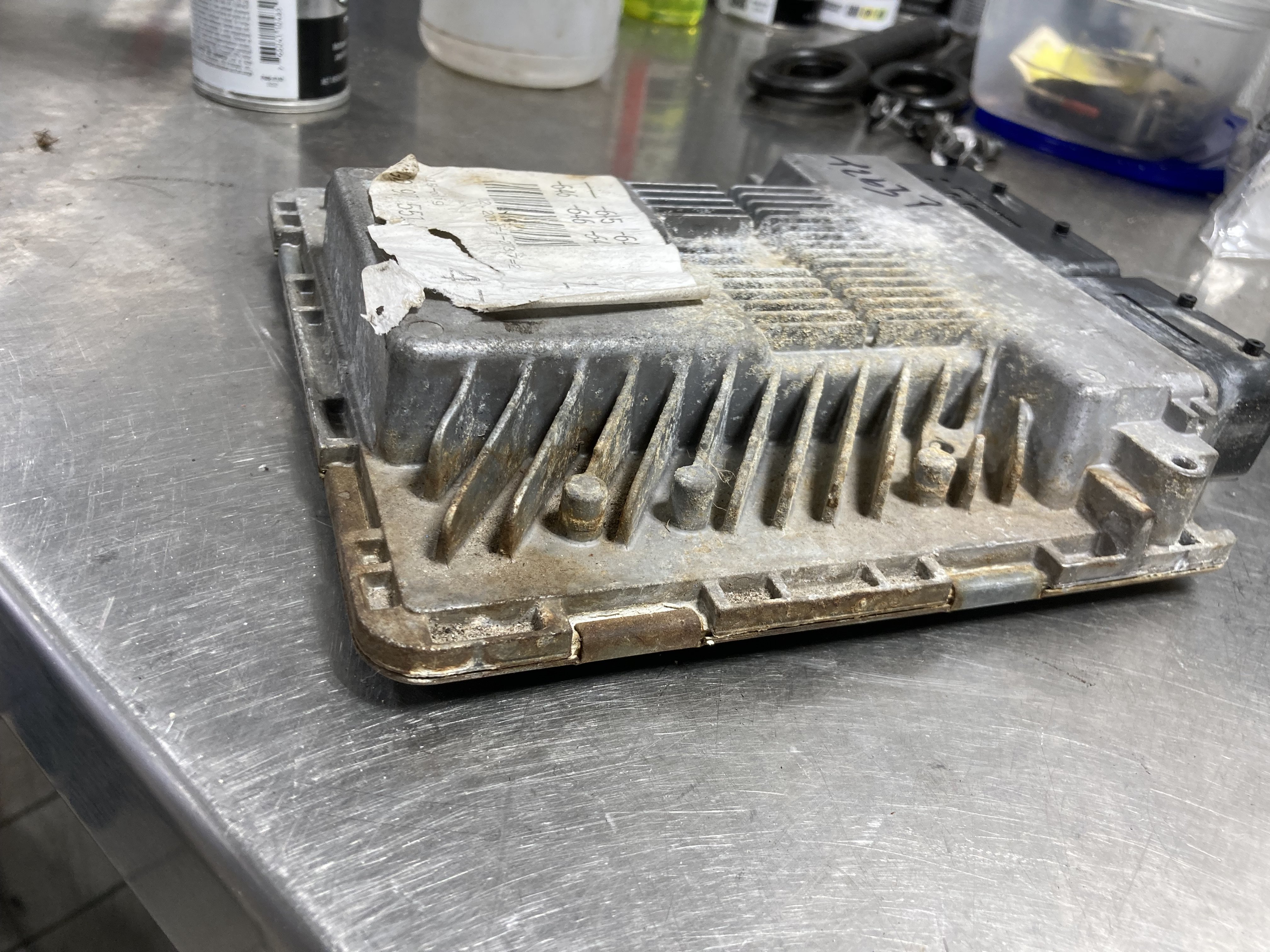

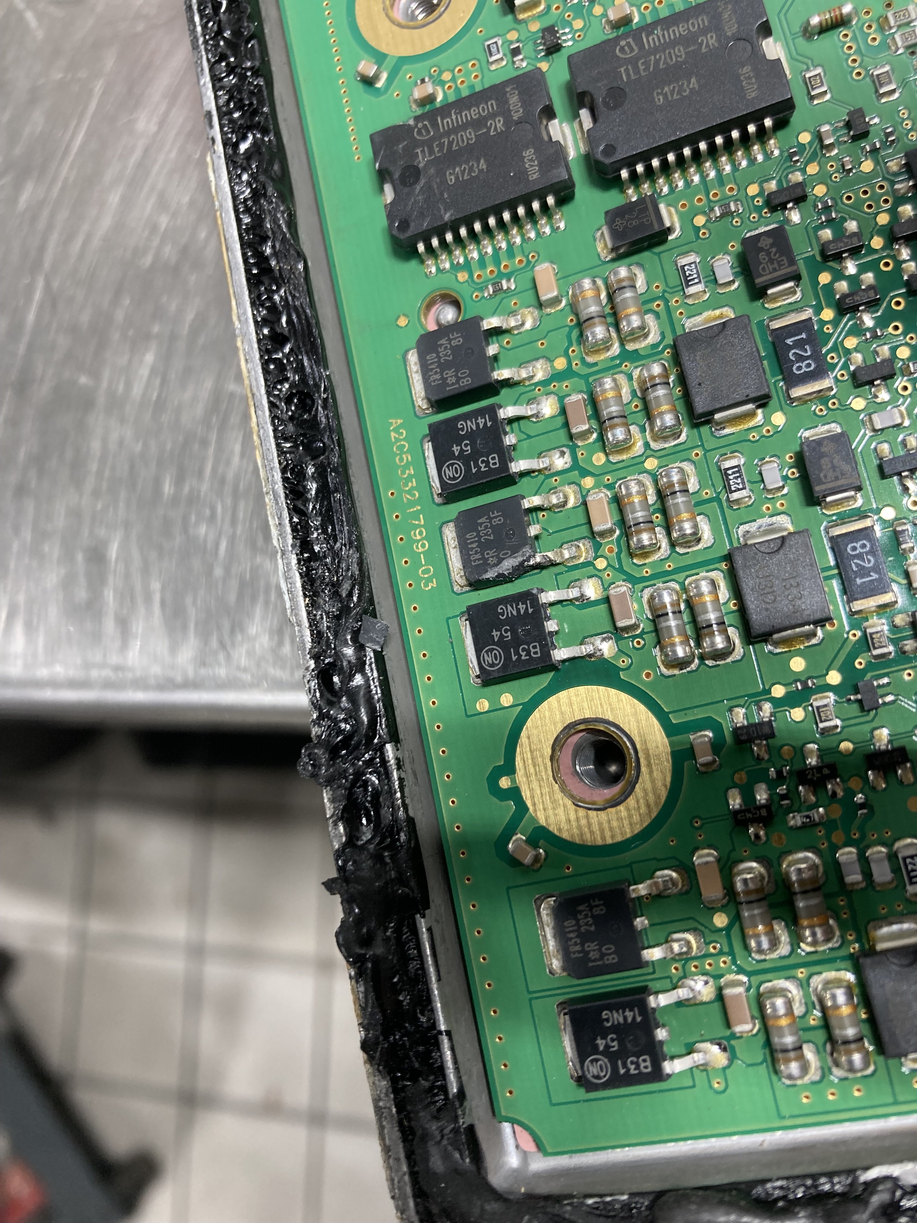

So after getting the DVOM out and starting at body grounds I was able to see that all injectors had ground and a 2v reference on firing. The one cylinder that was misfiring had .4-.5v at the injector. Checking continuity throughout the entire harness for that injector wire I traced all the way back to the ECM and found it appeared to have gotten wet. So against Audi instructions I cracked it open. And aha! Found a broken solder joint. It’s still enough to allow that half a volt but nowhere near what it should be. Time for customer to eat a ECM for several thousand dollars
Nice exploratory diagnosis! :) (y) Why don't you just solder another VR/diode(?) in place? :unsure: The trade numbers are on the back. Is there not any kind of "emission" warranty on emission parts any more? :unsure: How did it get wet and how is it the customer's fault? If it were MY car I'd try soldering another thingy onto it... ;)
PS: was it a flood car?
ECM is mounted inside the cowl panel next to wiper motor. There is supposed to be a “weather sealed” case around it which was/is missing. The car isn’t under warranty due to being a 2013 with 96k miles on it. For CYA purposes I’d prefer to just replace the ECM and Audi will not provide just that single electrical component
