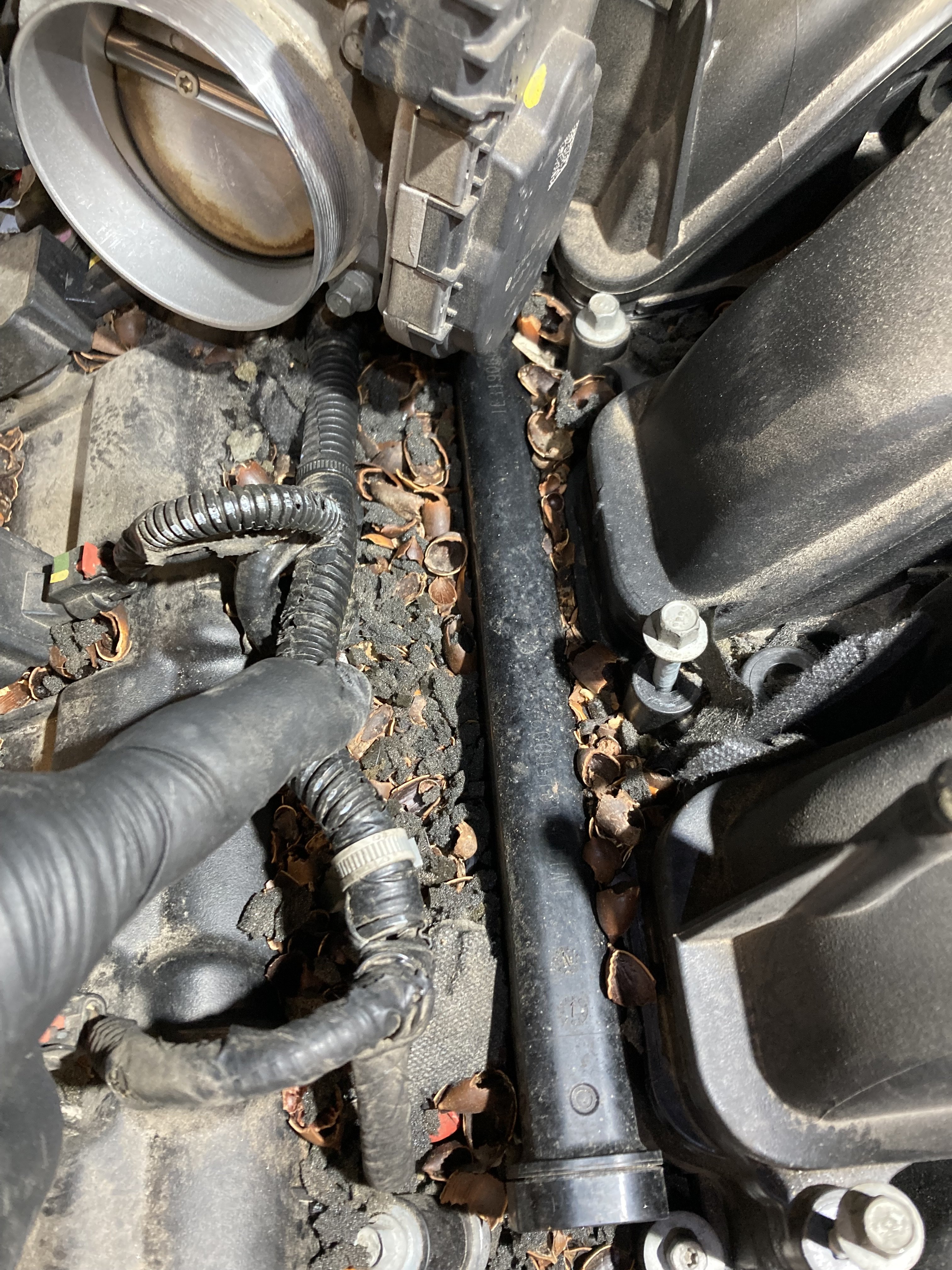

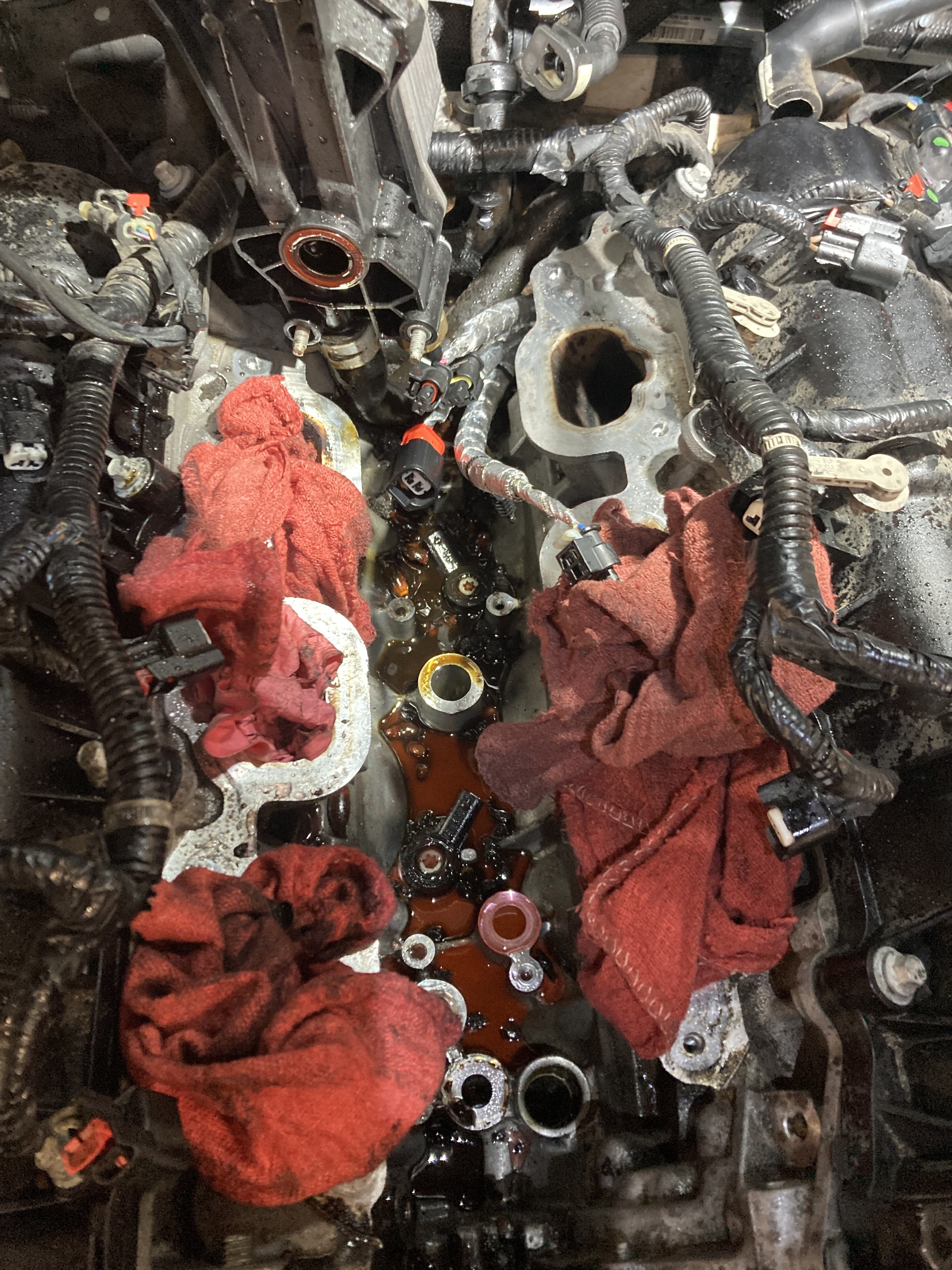

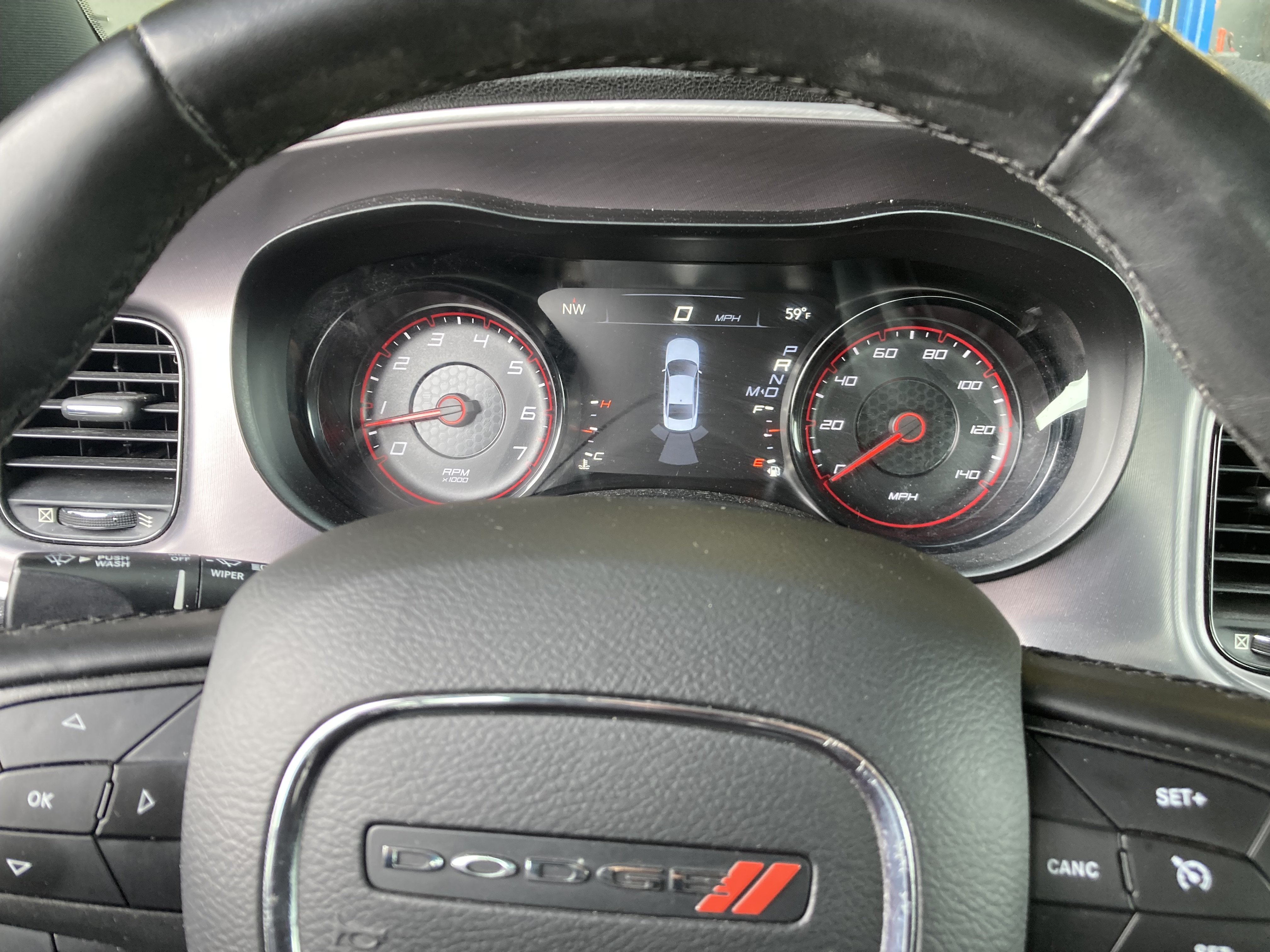

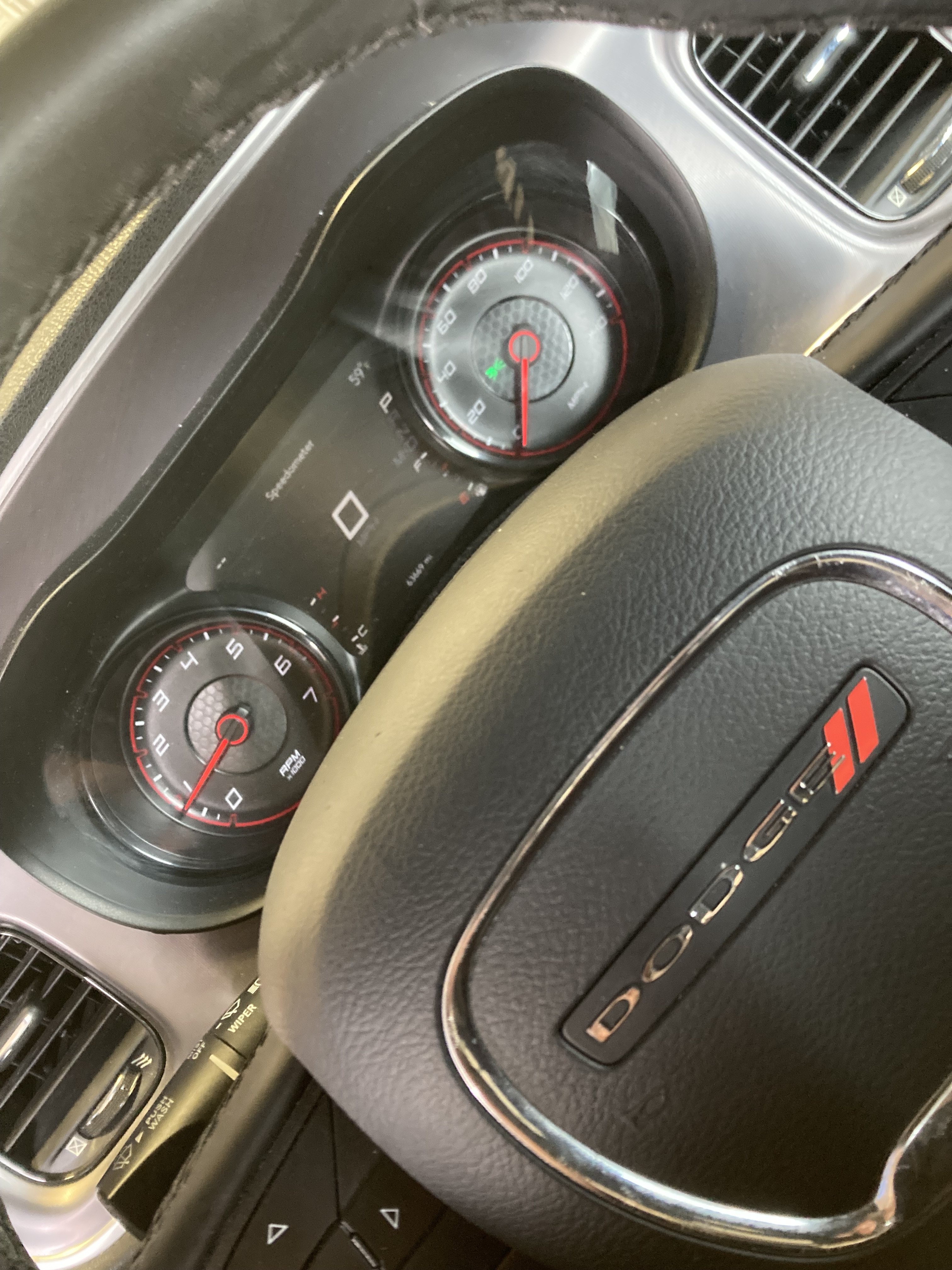

So newish body a charger with the V6 in it. Comes in for check engine light. (Oil pressure sensor Circuit High, and Low Oil pressure). Independent shop tells client car needs an oil pump. Pump is weak. They bring to us for second opinion. On initial inspection I immediately see the acorns, and chewed up insulation from the engine cover. Well, something made a home here. Pull off the intake and woah, no surprise there. It chewed through the signal wire for the oil pressure sensor. A harness and 2 hours later it’s fixed…
View attachment 28603View attachment 28604View attachment 28605View attachment 28606View attachment 28607View attachment 28608
What a mess the critters made.

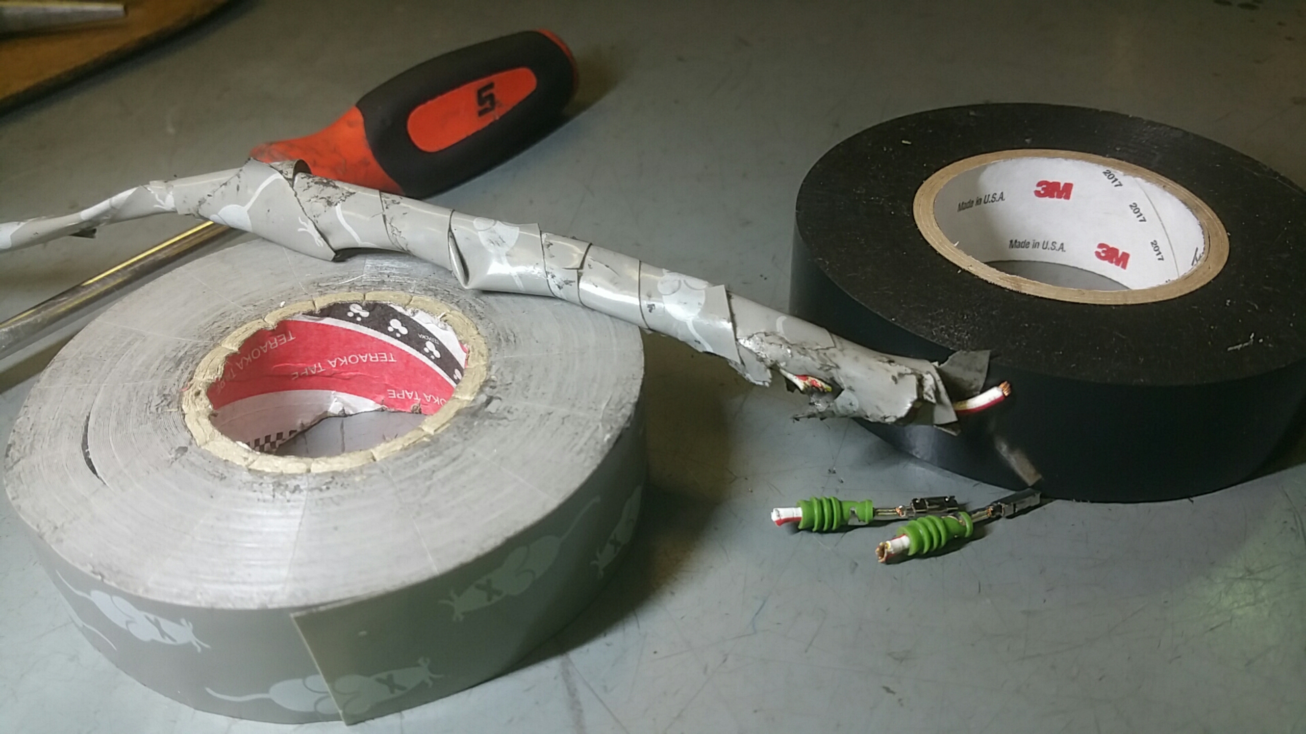

A friend of mine has a Honda Ridgeline. Apparently, rodents love the 'eco-friendly' jacketing Honda decided to use on their wiring harnesses. I guess it tastes good. Honda replaced the damaged harnesses under warranty.
Honda sells a "rodent repellent" tape to cover those tasty wires. We were using it for a while but gave it up after finding out our local rodents did not read the press release about the properies of that tape.
I think it's more effective to send the rats a strongly worded memo.
I remember that stuff many years ago ( early 2000's ) when I was at Honda. I had always wondered if it actually worked. I never had any comebacks from electrical repairs so i always figured it did. Guess I was wrong.
