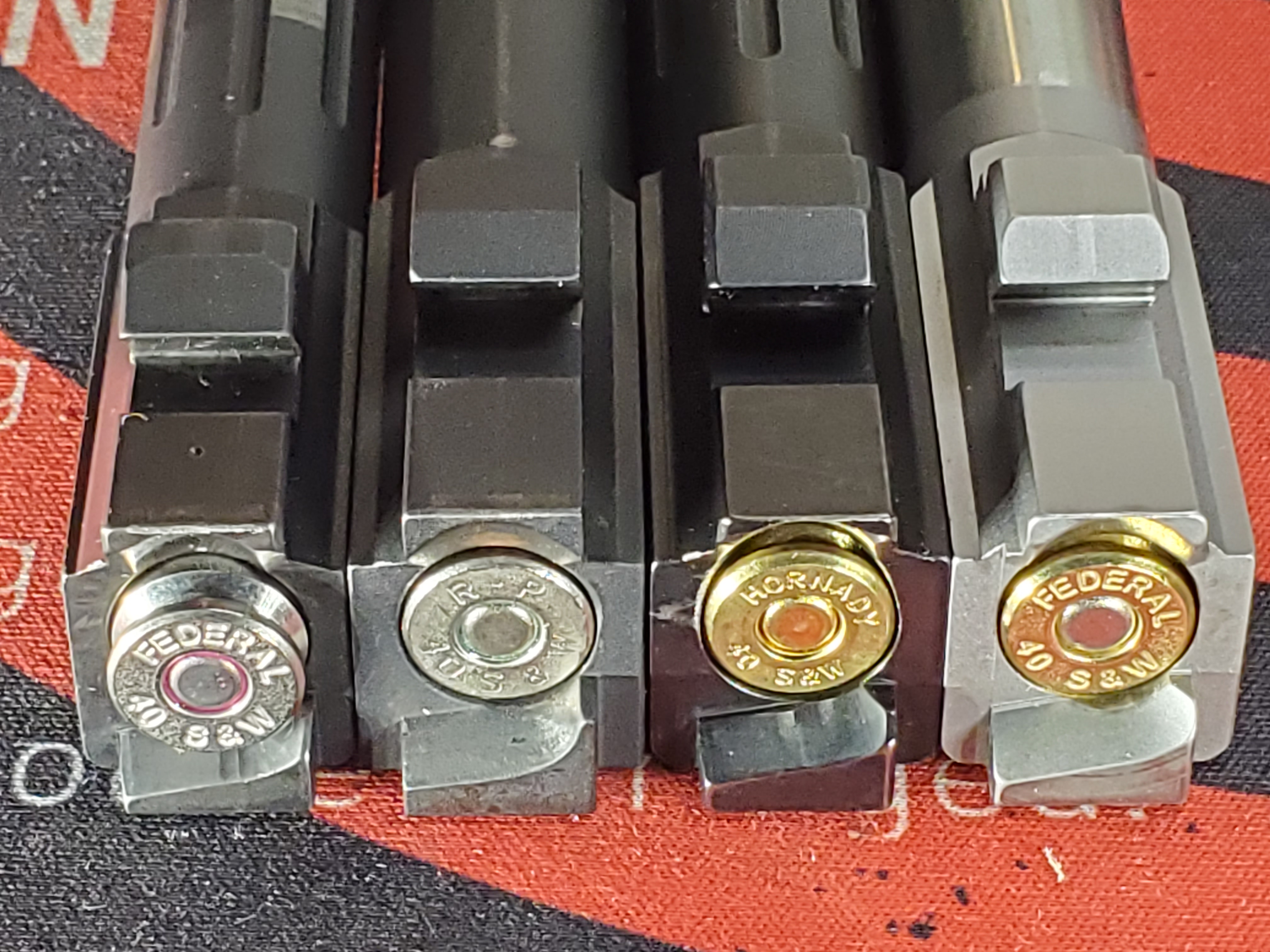

So, the longer chamber or "throat" of the 10mm still allows the .40 to sit in battery with correct head space? I thought on the rimless cartridges rested up where the lands/grooves start?
No, the .40 is being held in place by the extractor and in battery by the breach face. You fire the gun, the case expands in the 10mm chamber to hold itself in place while the powder burns and bullet goes out the muzzle. Pressure drops, bullet case contracts and is yanked out of the chamber by the extractor (usually). The .40 bullet travels about 1/4" before it hits rifling.
Rimless pistol rounds are usually located in the chamber (headspaced) by the mouth of the case. If you look in the chamber you'll see a small ring/ridge of where the case does this. If you take a .40 round and drop it in a 10mm chamber, it will go in deeper until it hits the 10mm ridge.
Firing 40 SW in a 10mm is not unheard of. Some do it because they have an appetite for being ridiculous. Or enjoy fucking with their jammed handgun at the firing line vs. shooting it. Bad idea with a carry gun though. The normal action is the round gets shoved out of the magazine and the extractor slips over the rim. This has to happen every time (duh). Since the 40 case is shorter it can go too far into the chamber. If the extractor doesnt keep it from doing so, it falls too far into the barrel. The firing pin cannot reach, so it will not go bang. Similarly, if the cartridge gets forward of the extractor yet does fire, it will not extract because the extractor dog is behind the rim.
