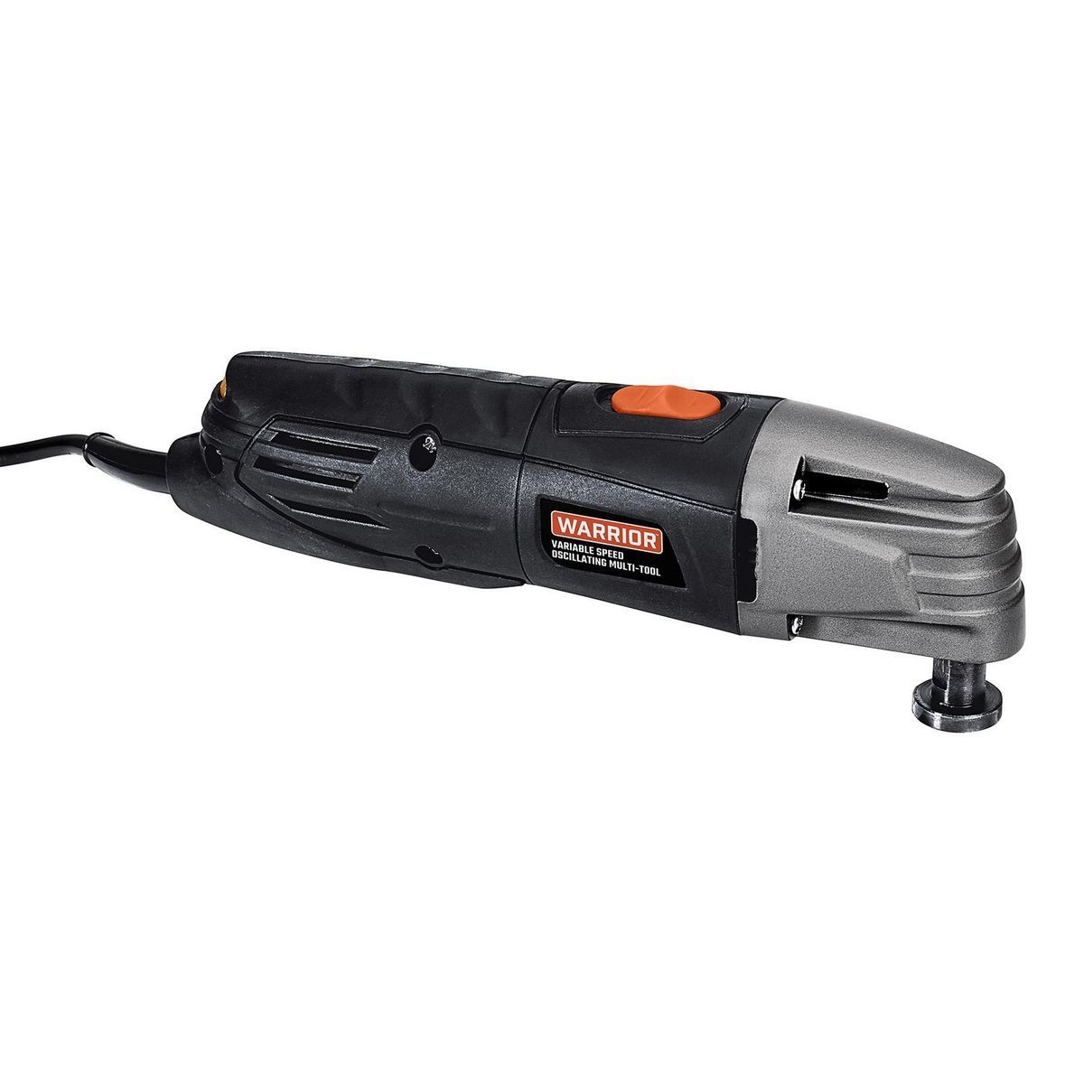

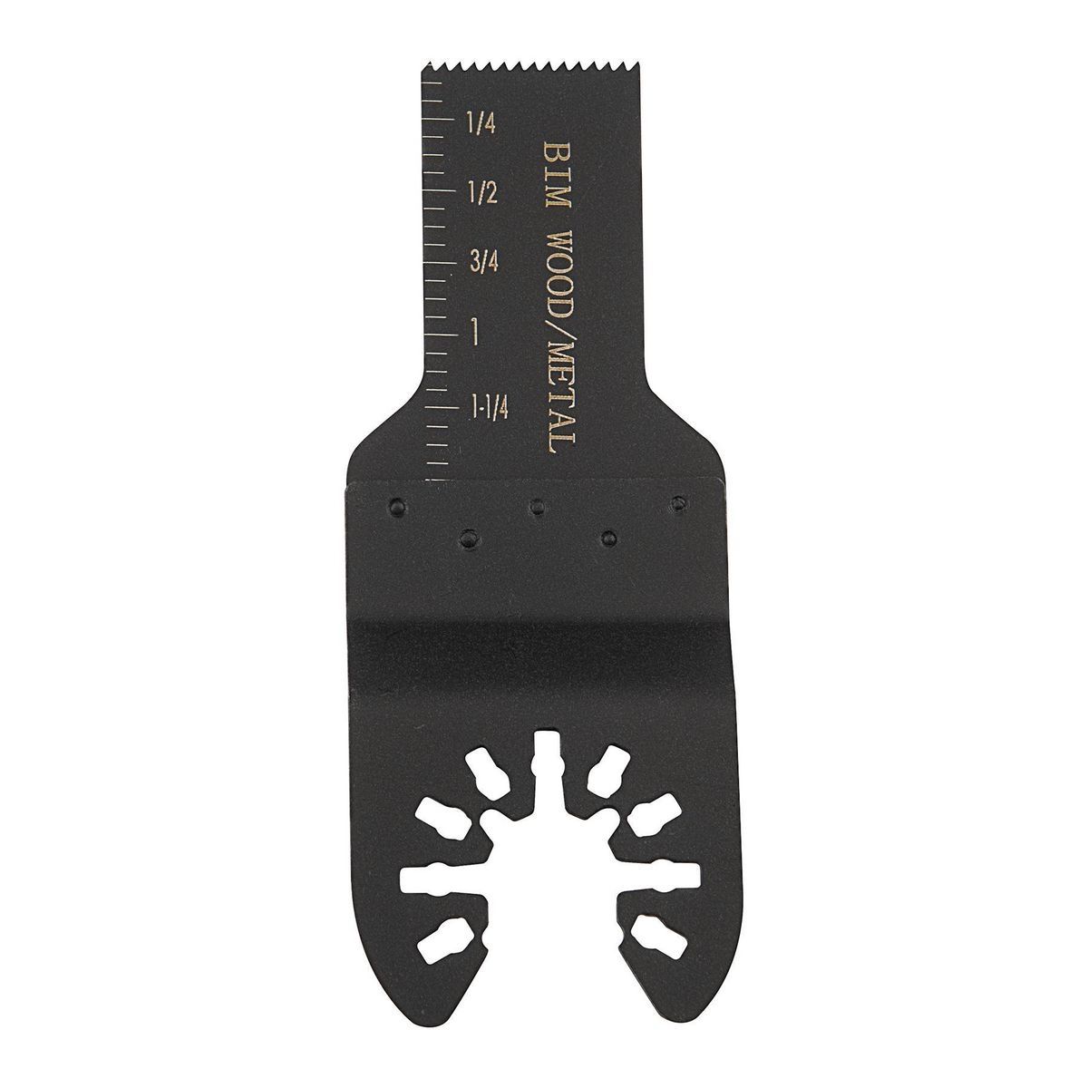

How about adapting something like THIS? $15 You can get all manner of blades for them. LINK If you had to, you could grind down a blade to fit in the pocket? :unsure: You can also get the blades at Home DeLowe's, etc.

Not a bad idea as you can resize the cutting portion of the blade to make it smaller if need be. The hardest part is to cut along the front wall of the trigger pocket. The second hardest is to not go too deep in the trigger pocket. You could mark the depth on the cutting blade with a piece of tape based on a finished gun and use that as a depth guide. Cheap and easy method, I like it. Just use a tool that has variable speed, and it should work pretty well. You could make a few vertical plunges and then snip with those nice nippers you purchased.
