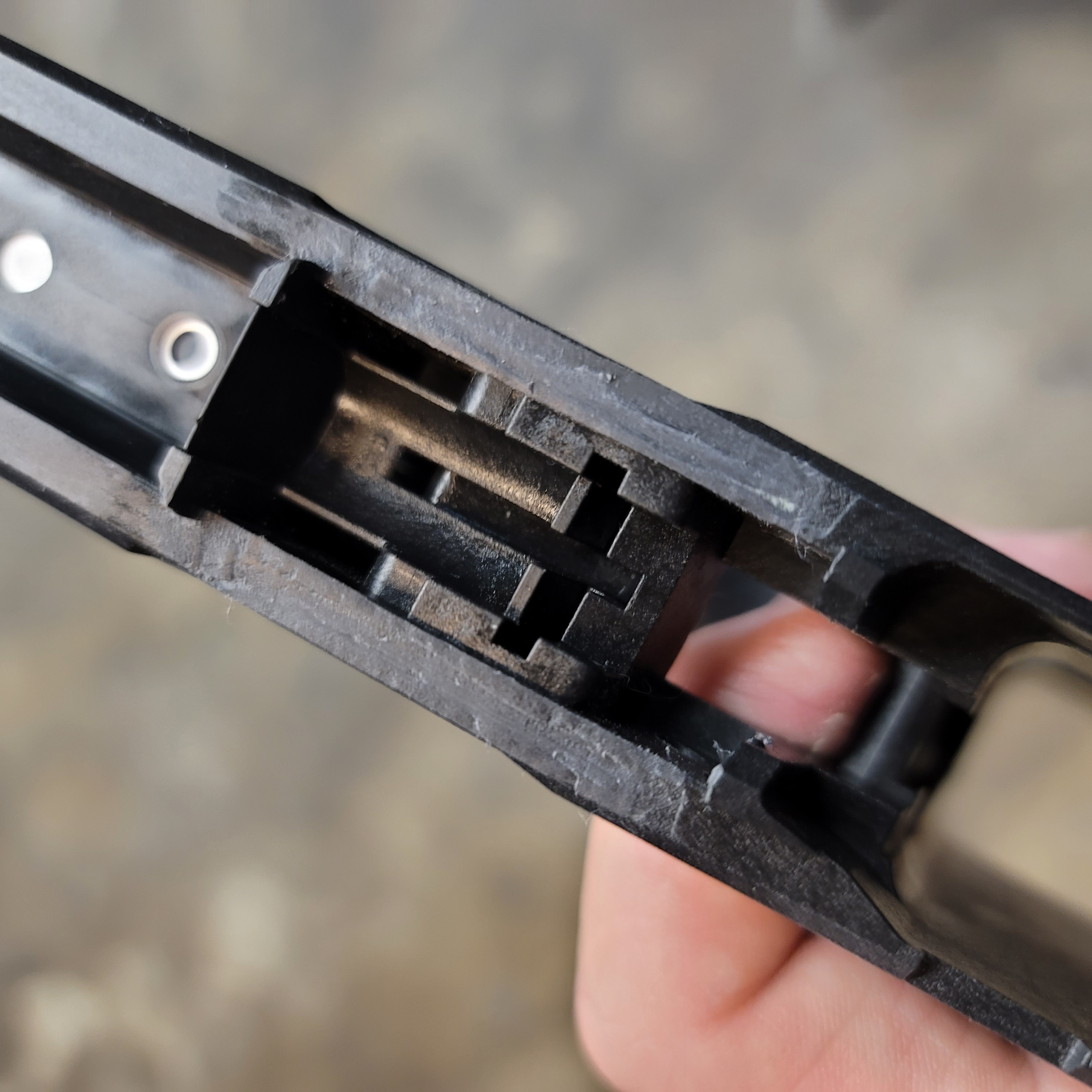

I'm doing a build on the pf940c right now and just taking my time. I work on it when I'm bored. Kinda why I got em other than I love doing this. After reading in here and watching MGB videos like 5 times each I don't remember him ever saying to score before using Fret Cutters. I just spent $62 on Hosco Fret Cutters which will be here tomorrow and after reading this I pulled my Xacto set out and took all 4 of my tabs off perfectly flush in 10 minutes maybe less. I have a pf940SC I'm doing next and I might just use a regular box cutter but the Xacto knife did a wonderful job, I just need to do some clean up for that "First Time Quality" job.
What I'm worried about is doing the channel. I was already going to use my xacto knives to make the final cuts, I was going to use the Hosco Fret Cutters to get it started but I read in here that they push the towers in the Channel. Now I'm a little bit afraid to do it this way but If I don't go perfectly flush against the towers and get super close maybe I can just use the dremel to get the rest off. If I do use the Fret cutters for the Channel the final cut will be with my Xacto then I was going to make the relief cuts in the bottom of the channel and use the mini Fret like Cutters I found at Harbor Freight to nip the rest away. The Channel worries me the most, it's the one thing I am afraid to mess up on.
I have been reading these forums as much as I can, is there a post on the easiest way for the Channel? That's all I need to do on this PF940C to assemble, besides wet sand after the Channel and tabs.

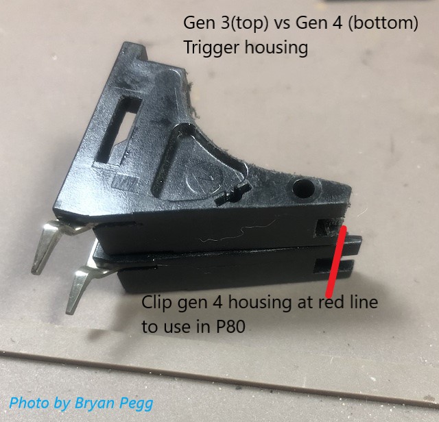

1 more thing I was about to order the 47021 ejector from ebay but I'm noticing the entire housing with Ejector is $9.99 online it's just sold out everywhere except 1 website I found. The 47021 ejector is thee best way to roll right? Just making sure! I also bought a lone wolf extractor plunger, spring and bearing on accident from ebay while I was picking up some polish and a new back plate as I have an extra stock glock 19 slide from my stock glock 19 I bought a while back, I was going to put the stock firing pin and stock extractor plunger back in the stock glock slide and use the lone wolf titanium firing pin and assembly with the extractor plunger assembly in my Faxon Hellfire slide with the PF940C I'm working on right now. Super excited to get this finished, just my first time doing first time quality and everything right! Any suggestions, I thank you all for in advance!
I used the Dremel to start and remove 98% of the channel block. Then I go to the "Micro-Sander." After than... rubber points.
Here's video of how I do it. Skip up to 6:36.
View: https://rumble.com/vs3e16-using-a-micro-sander-for-p80-frame-and-channel-finishing.html?mref=wdrri&mc=9kvnk
And I do it differently myself. I cut as much out with a set of homemade mini fret cutters then I finish removing the rest with a machinist's triangle scraper.
As you can see there are definitely more than one or two ways to remove the tab and finish the channel. Use what ever method works best for you and produces a nice clean and smooth channel.
Yep. I'd say that "magic ingredient" is: Take your time! Go slowly! Little bit at a time.
Shooter- 47021 ejector for gen 5 will work fine as long as it's put in a gen 3 housing or modified gen 4 housing. Here's a pictorial of ejectors for P80s ...future ref
Gen 4 housing mod

Gen 4 housing/ejector
Gen 3 housing/ejector
LWD gen 4 ejector only- swap out for gen 3 #336. Tested by community it does work
I can vouch for the LW (OEM 30274 clone) ejectors that Michele linked. They install just fine in an OEM trigger block, and are as good as, maybe better, than OEM. At least they are polished. I've installed about 4 or 5 of them.

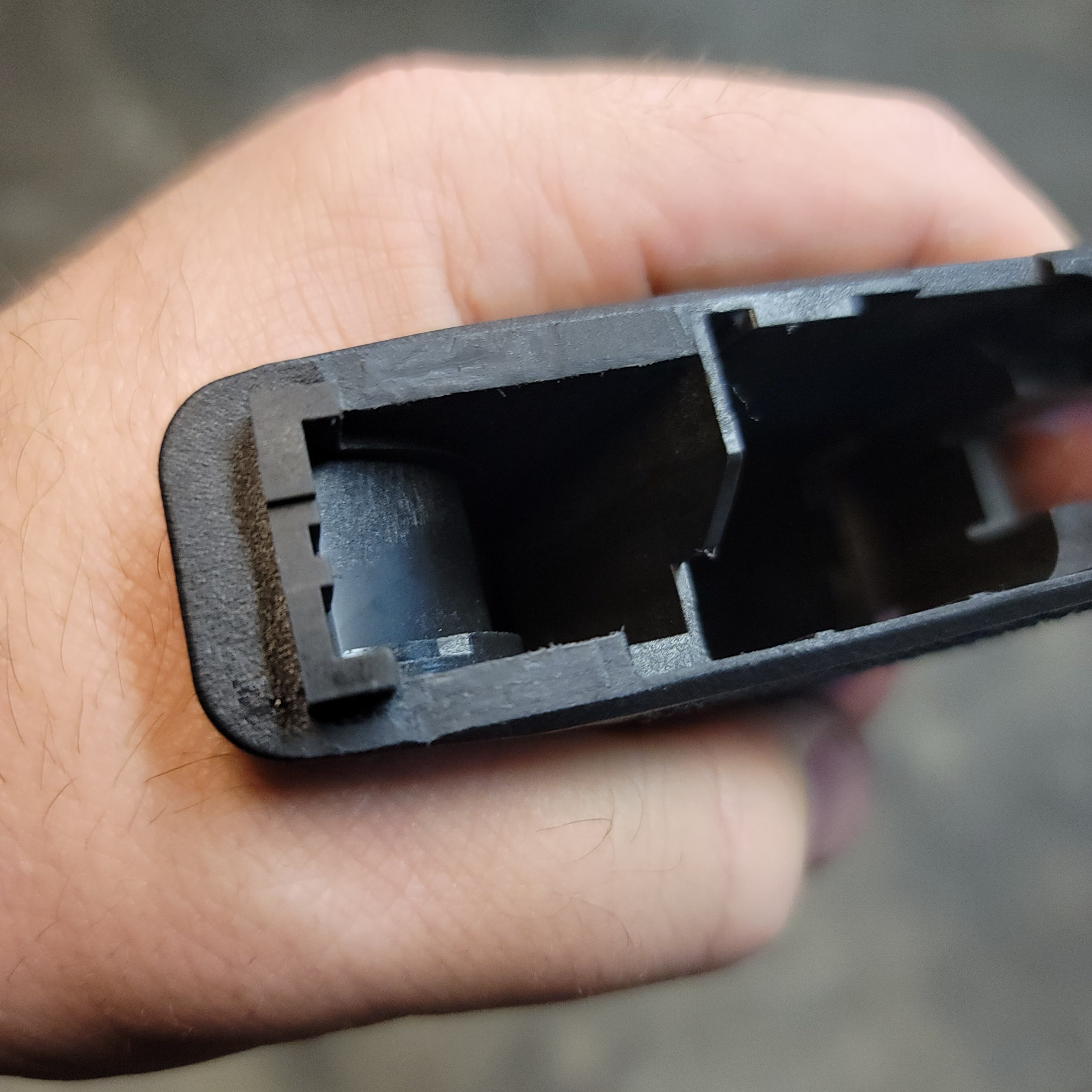

Super nervous about my tabs. I cut them off while still in the Jig. It's like there's nothing left. It was cut all the way across. It's clean but I'm not sure If I should take the metal files like MGB used to sand out the edges or if I should wet sand them in with like a 240 grit or something, it's amazing how clean they cut. There will be some flaking but that's all, no little nudges of anything, the tabs seem to have come off 100% so I'm just worried about going down too far!
Just drink a whole bunch of caffeine and then pick up your existing tools! ;)
Dude I would be shaking to death...I have permanent nerve damage which sucks, broke my back 2 weeks after turning 21. Major back surgery made it hard to keep a steady hand without a few puffs. LoL it's why I am so nervous to use the dremel to sand my rails because their so damn flush the entire tab just popped off lol...maybe I have a good amount of room to work I just don't want to take off too much. Wet sand by hand might take forever and a day...maybe do like 400 and 600 and move to the hard white bits I think are the same for polishing metals as well...that seems course enough to take off or help flake off and blend some of it but I might be way too early for that. Maybe I should go in the order mgb did, I just wasn't sure what he used after the metal bits, i think it was the hard white bits. Then he went to black, I have black, flitz and the white tub with red label I forget the name 😆 but it's just that after polish.
Ok so this is my first time trying to go pretty. The Xacto did such a good job on the tabs I used the metal grind bit he uses in tabtastic, to get it smooth without the little flakes and then I rubbed some black in, used a Impregnated buff and some greens to get smooth. Hit with black again but it didn't do much. It feels good...I feel like I need to do a wet sand to get it looking proper. Must I go down the entire rail?

Those tabs look good from here! Nice job. As long as they're smooth, you're good to go. How shiny you want to make them is a matter of personal taste. Once the rails are installed, you can't really see it anyway.
