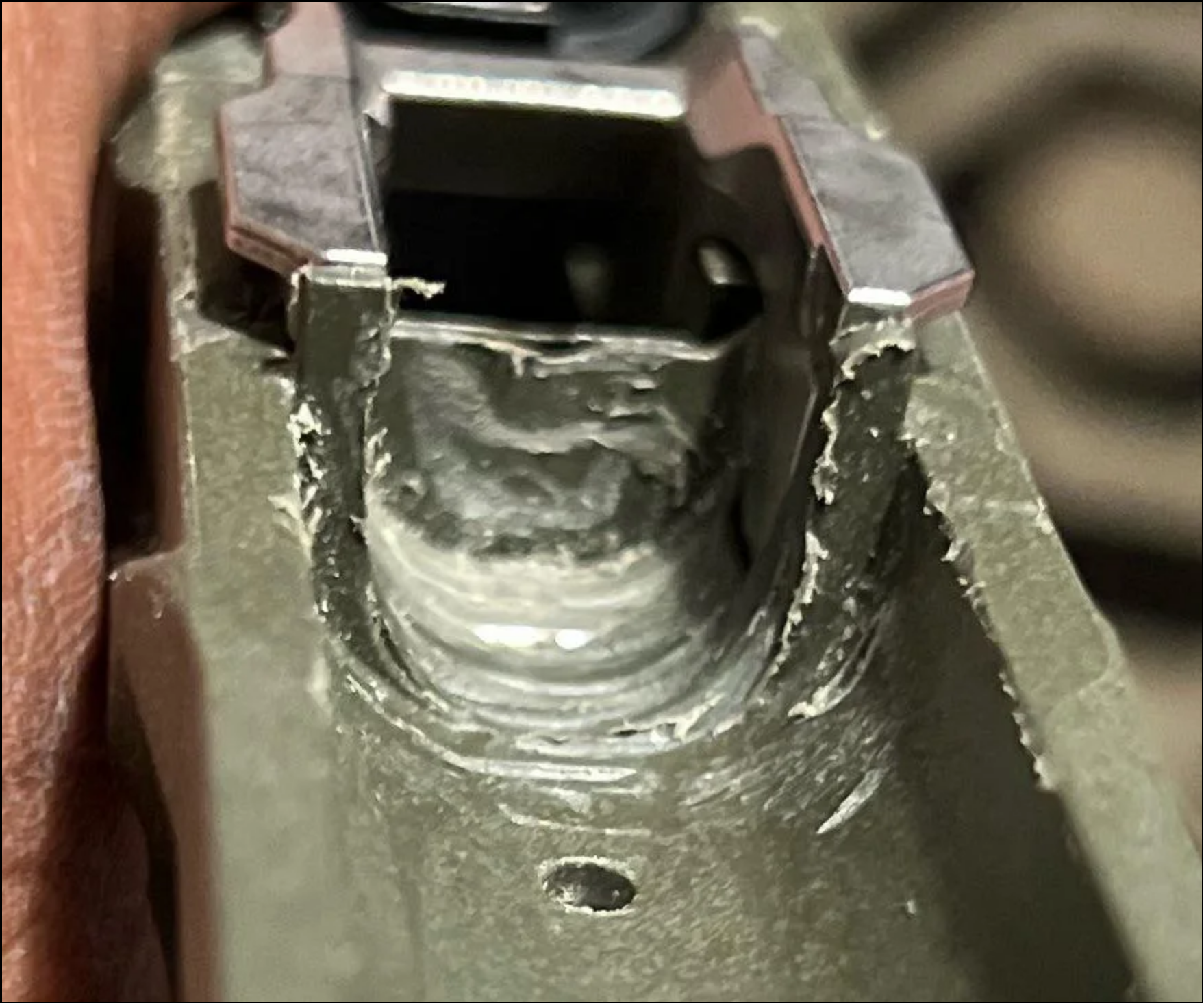

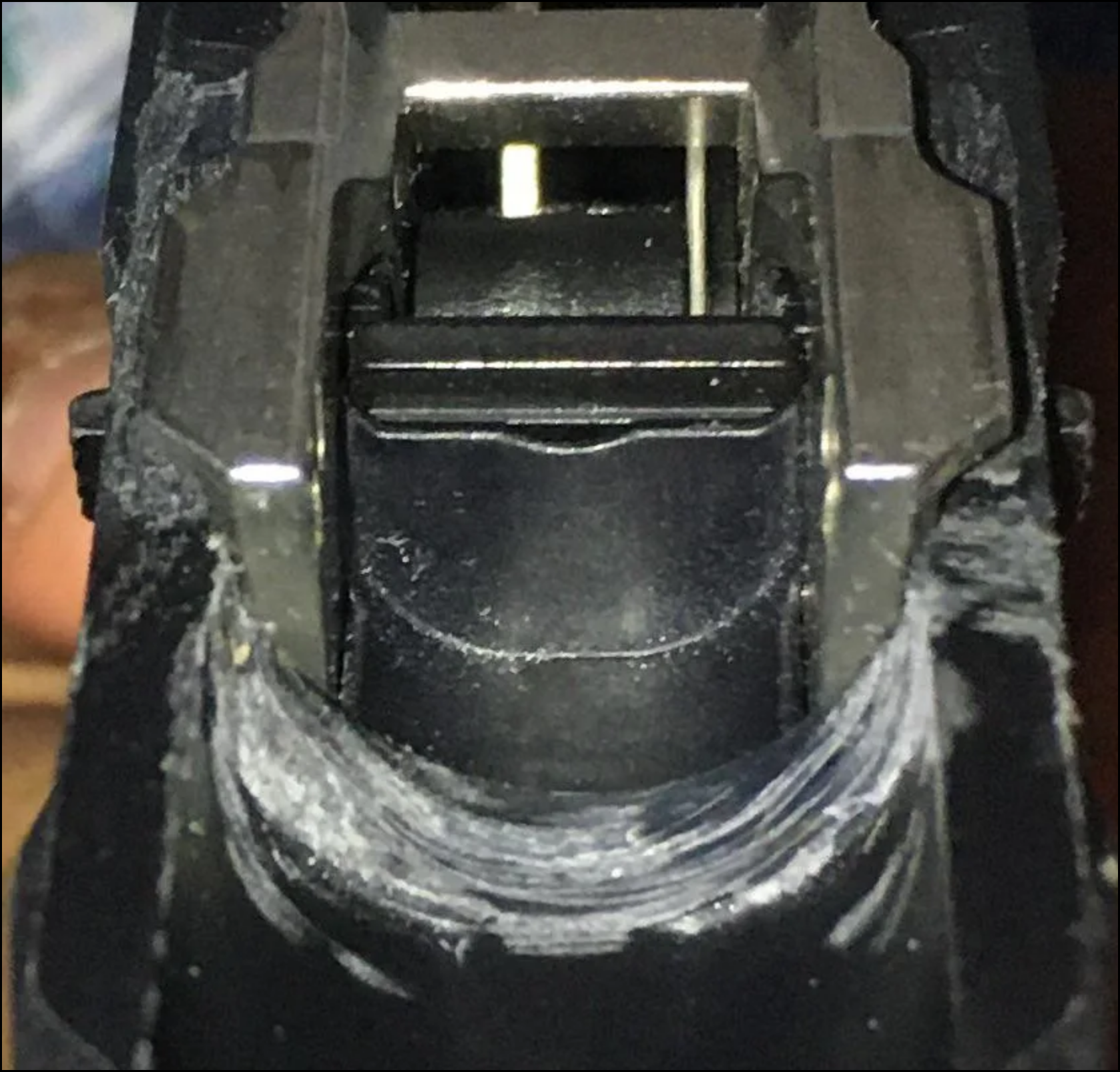

Then we see posts on reddit that ask, "Why won't my slide cycle?"
That adage FTQ kinda makes my skin crawl. First time? Just how does that apply? Does that mean you can't go back and refine your work? How about just "Quality"... but I digress.

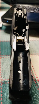

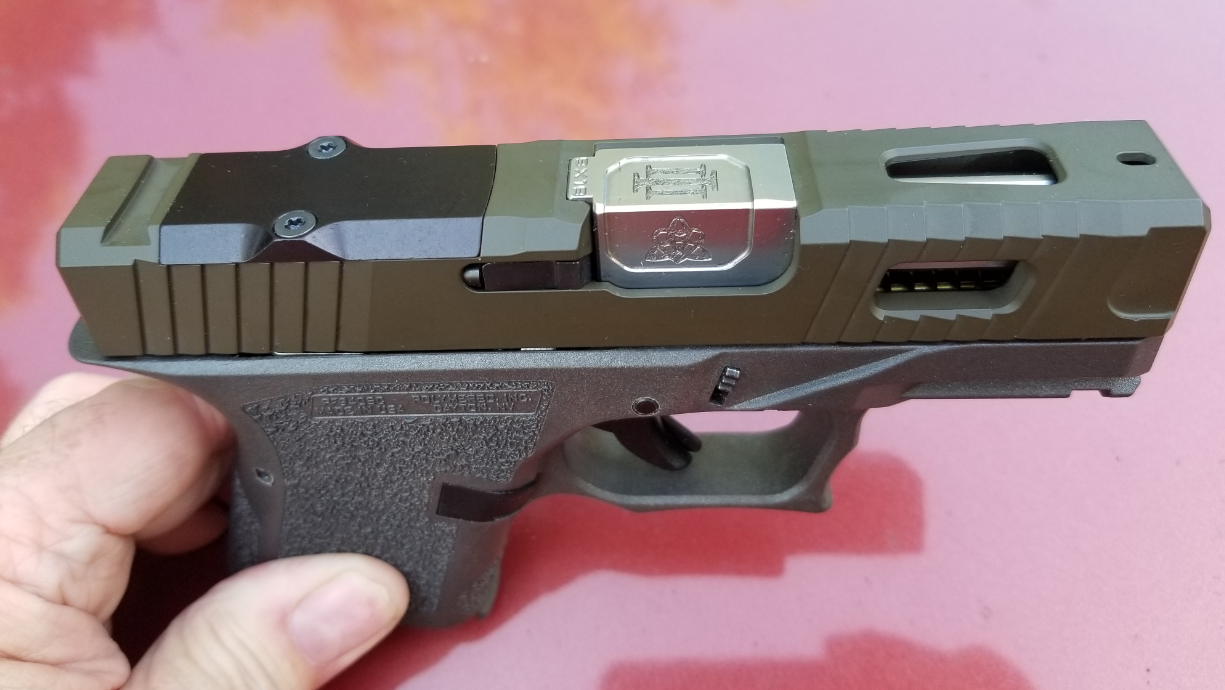

Here's an under the hood pic of my SC...I really need to get some of those little rubber polishing bits for the small details, but anyway there it is. Runs flawlessly....actually they all seem to, except my unproven PF940C build you've seen but I haven't been back to the range since the little medical speedbump I'm recovering from, and having cimpleted that project about 6 weeks ago but it hasn't been test-fired yet. Maybe next week, after the next heat wave here wanes...here's the (ultra accurate and consistent) SC frame:

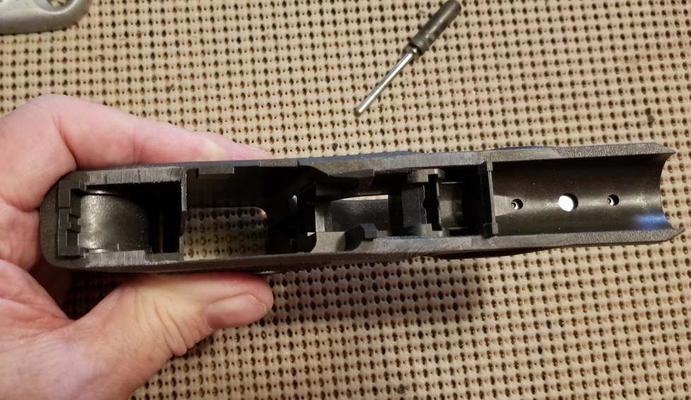

So, the 650 bit shown in the photo at the start of this thread was bought in the 80's and was getting kinda dull. I ordered a new one and used it on my last two builds with the burnt bronze slides. What a difference! It buzzed off those tabs in seconds!
Being this was my first black frame, and I've seen where peeps are using various techniques to blacken where the tab used to be. It seems if it's snipped off with fret cutters, it leaves a white mark. With the 650 bit, it leaves the tab area a little dull, but it's still black. After I had everything smoothed out like I wanted, I used a gray Cratex cylinder on the tab area. It brought the shine back to where you could barely tell it from the untouched part of the frame. Use low speed, a light touch, and keep it in constant motion so you don't make a divot in your nice smooth rail. Works equally well in the channel. I did not use water, but will try it on the next one to see if it adds anything.

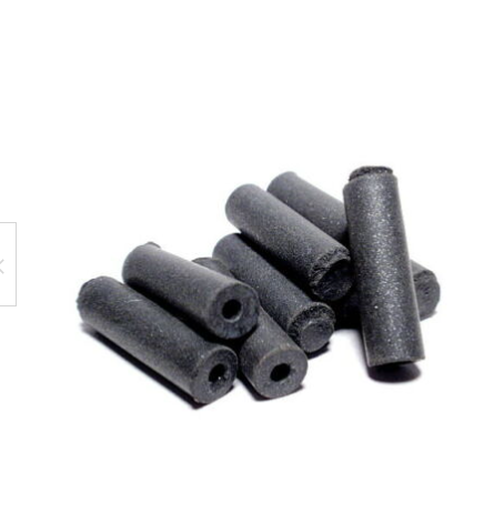

Dremel used to sell these, but they are no longer on their website. These are a bit coarser (120 grit) than the green bits from Amazon.
Just found some on ebay. Going to order some as I only have one more left. These are great for polishing feed ramps.
Dremel 427 Rubber Polishing Points Cylinder + Mandrel (coarse grit) | eBay (comes with mandrel)

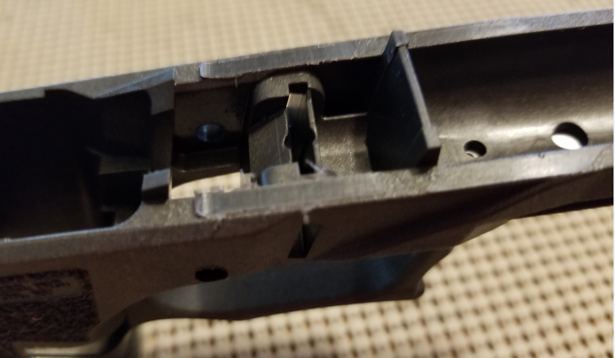

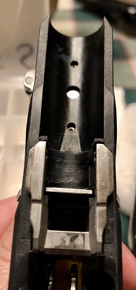

So, the G26 award kit arrived today and building commenced.

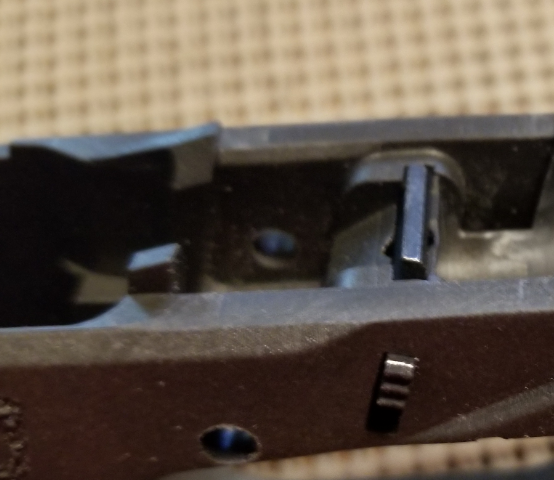

Here's the tabs after cutting, but before any sanding. The little piece at the back is where the jig prevents the bit from removing that last little bit.
After sanding. Let's make that white chalkiness go away with a little Cratex magic.
After. You can barely tell there was a tab there.
Michele's etching is a custom touch. Very nicely done.
Waiting for magazines and sights to finish it.

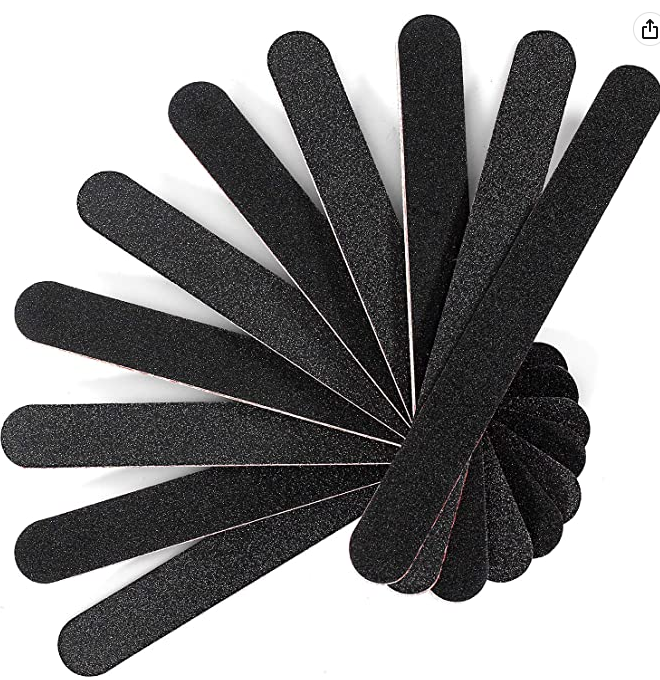

Used one of these for the file work.
Amazon product ASIN B07YC4MV3C
View: https://www.amazon.com/Double-Buffering-Professional-Manicure-Pedicure/dp/B07YC4MV3C/ref=sr_1_1_sspa?crid=34S5L6XVT9X5P&keywords=foam+nail+file+boards&qid=1661244928&sprefix=foam+nail+file+boards%2Caps%2C196&sr=8-1-spons&psc=1

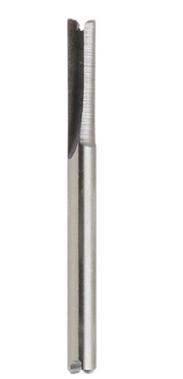

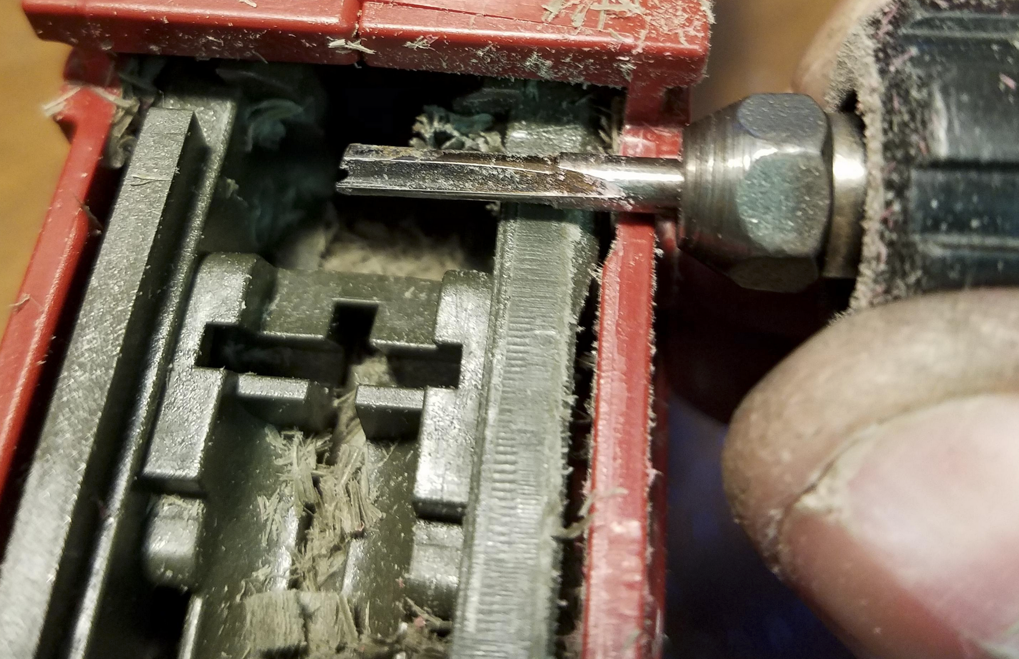

Sorry, was more asking what you used for the initial tab removal such that the "tail" at the back was left. Prior post said "cut" so I wasn't sure if you used the fret cutters or ?
I believe he used the cutter shown in the OP:
And the tool running into the jig is what resulted in the little lip at the far end of the tab.
