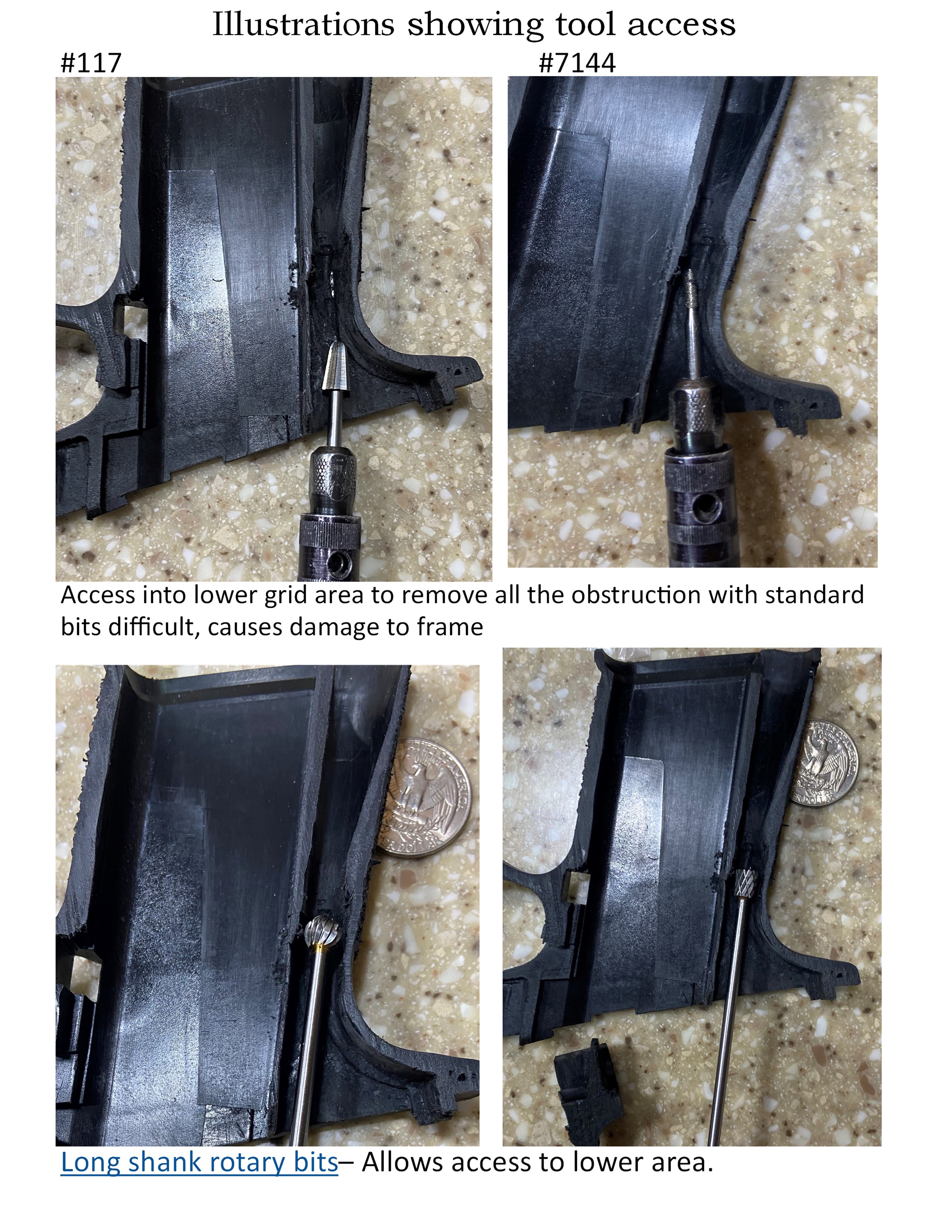

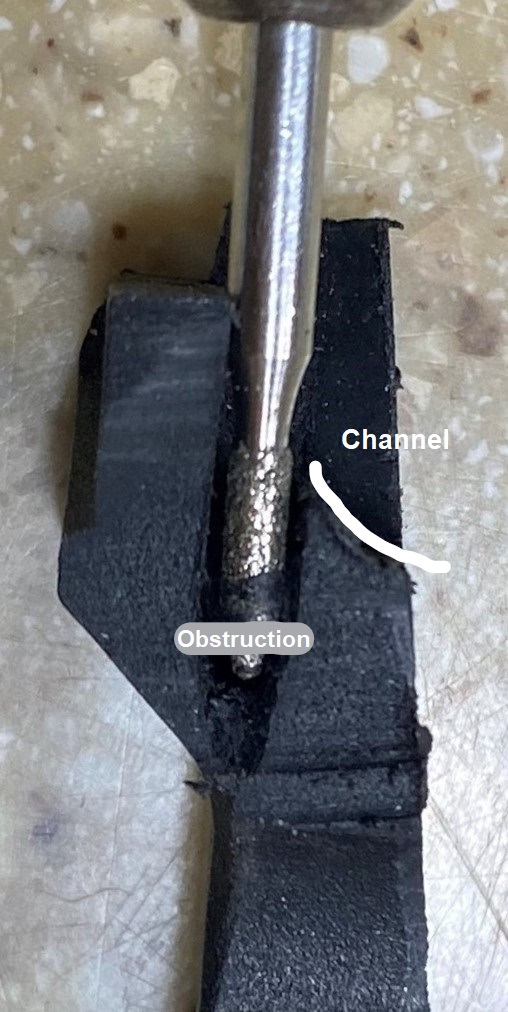

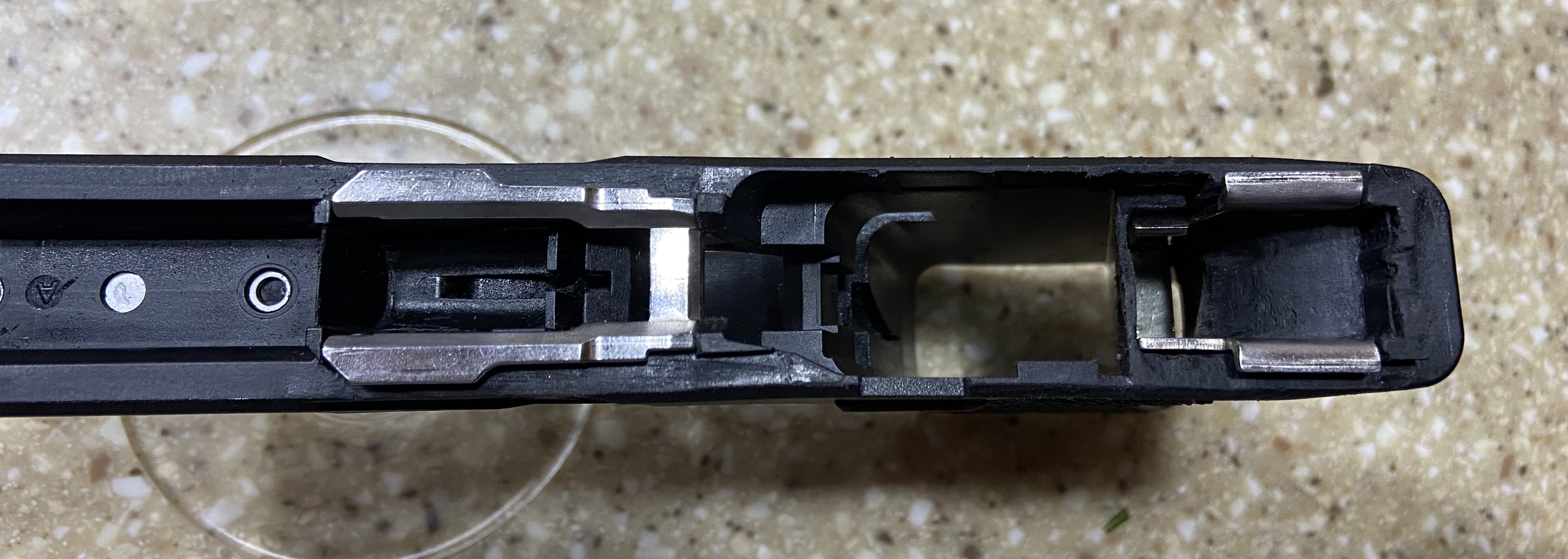

Now for the hardest part. Lower section of the trigger housing. I have not come up with a method or technique for this area. It would have been nice if only the upper area had the waffle fins. They go all the way down to the ridge the rail sets on. I currently don’t see anyway to save that platform. This frame is already too far gone to even attempt it.
These are the issues:
1) Very little room. Dremel doesn’t fit down in there without damaging the surrounding areas. I went down as far as I dare with tool extended out all the way. Hot knife damages surrounding area…no room to move.
2) Can’t see down in there. Tools take up all the space, no light or room to see what’s happening in there.
Anyone have ideas to get down into the trigger housing ?

Hmmm. What you describe here seems quite troubling for relying on a Dremel and the small length bits..

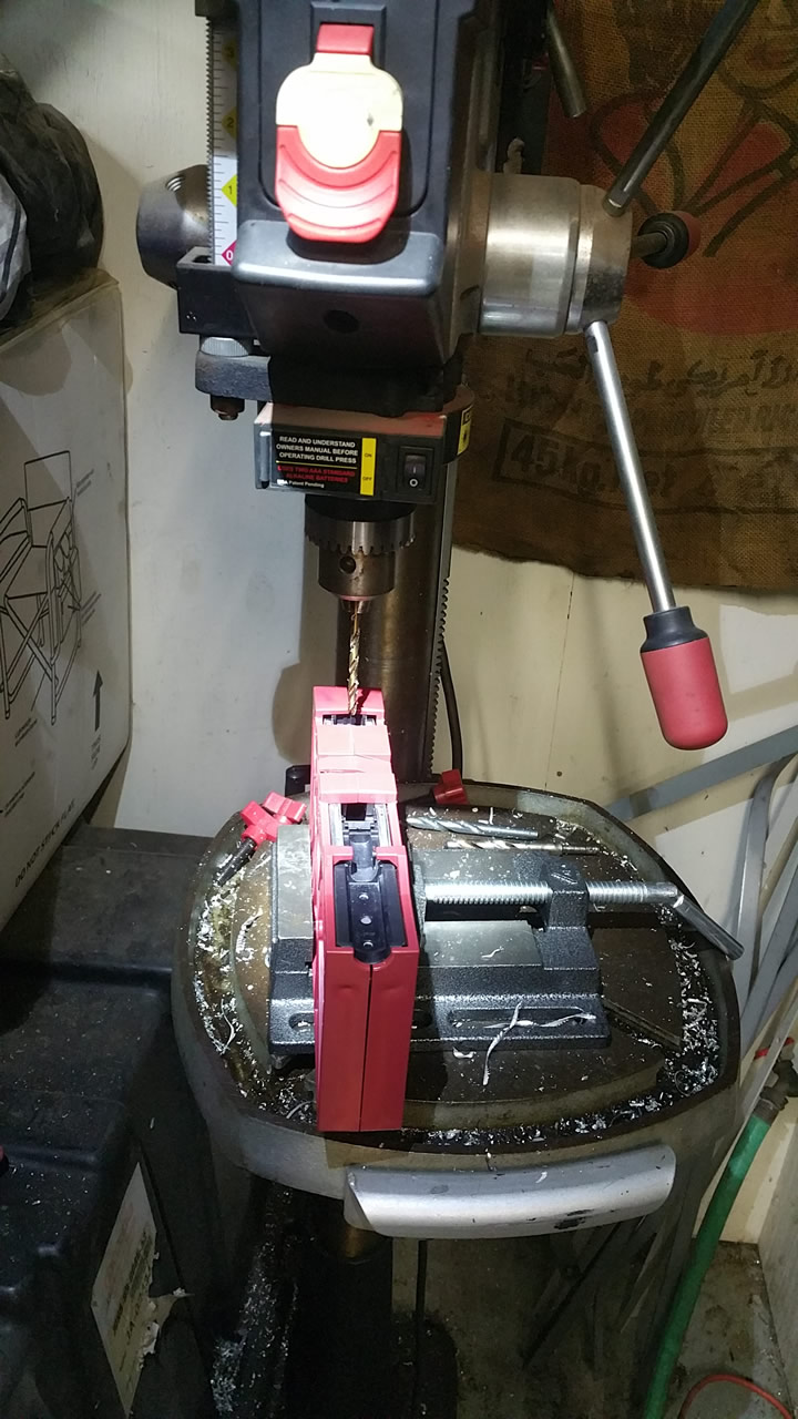

Do you have a drill press?
I would say the way to maybe tackle that would be to perhaps chock it up in the original jig and square it up on the drill press table. Then plunge with an end mill bit that has a flush cut like described in an earlier link by another member. But, I'm thinking those tiny mill bits are not that long enough.
See the photos below.
These two pics are for quick illustration purposes here and I slapped a jig on the drill press table because I'm pressed for time working in the shop for a race next weekend. But, in the second photo, you can see the lower shelf area for the rear locking block and you have some access with it inside an original jig. This is a PF45 jig. It's the only frame I have that isn't built, so I used this one to illustrate. You might need to cut out some of the top of the red jig to be able to plunge deep enough, but on first glance, this area where you would remove material on the red jig doesn't appear critical.
This is the only way I can think of immediately that would afford good control in a tight area and I do believe you need to get the depth correct too and don't go at it willy nilly. The locking block rests on that shelf and you may have ground away some of the other support it has in the arched area, so getting the depth right is probably necessary.
Thanks again for all your effort here. Looks like you have all the tools to tackle this in a variety of ways.

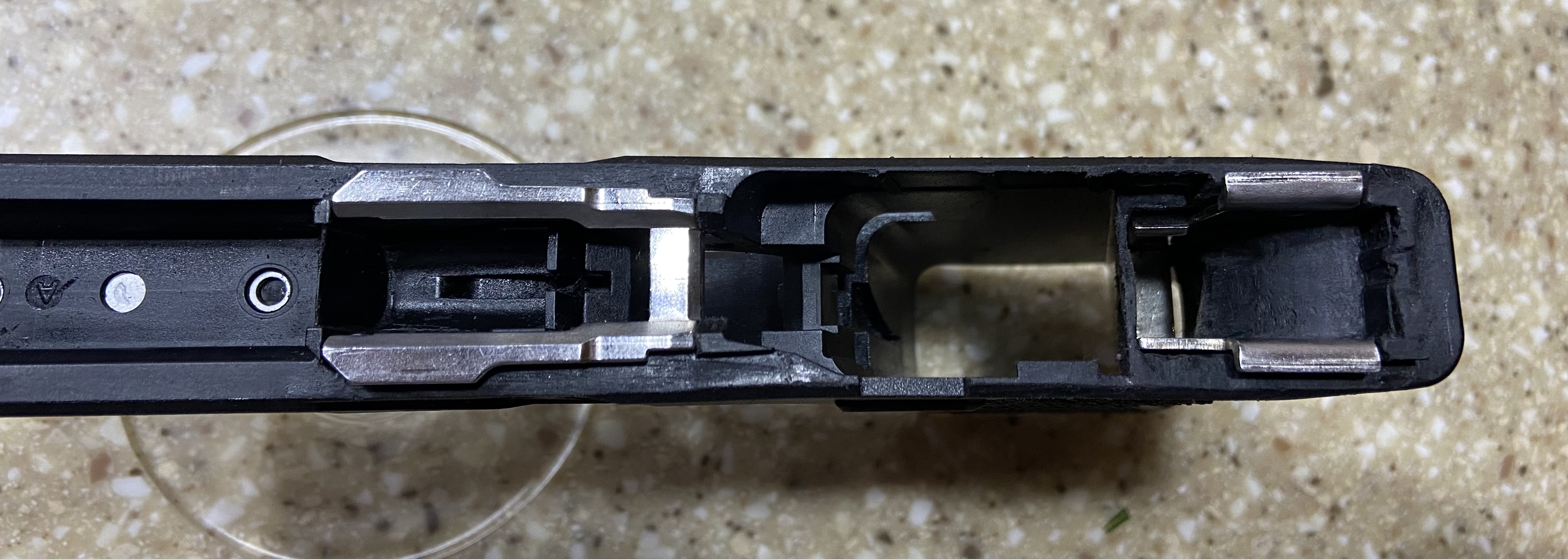

Here is the area where you might remove some red jig material to gain better access (the black rectangle area). You may not need to remove this much. I just drew it up quick. I know this maybe sounds like a PITA, but it would probably result in a square flush cut on the shelf where the RLB rests.
Update:
Here’s where I am so far. This frame is so beat up, it’s surely not FTQ. I suggest protecting areas to avoid melting them or getting Dremel wear marks. I’m really not sure how I am going to get down into that trigger housing without damaging the frame worse than it already is.

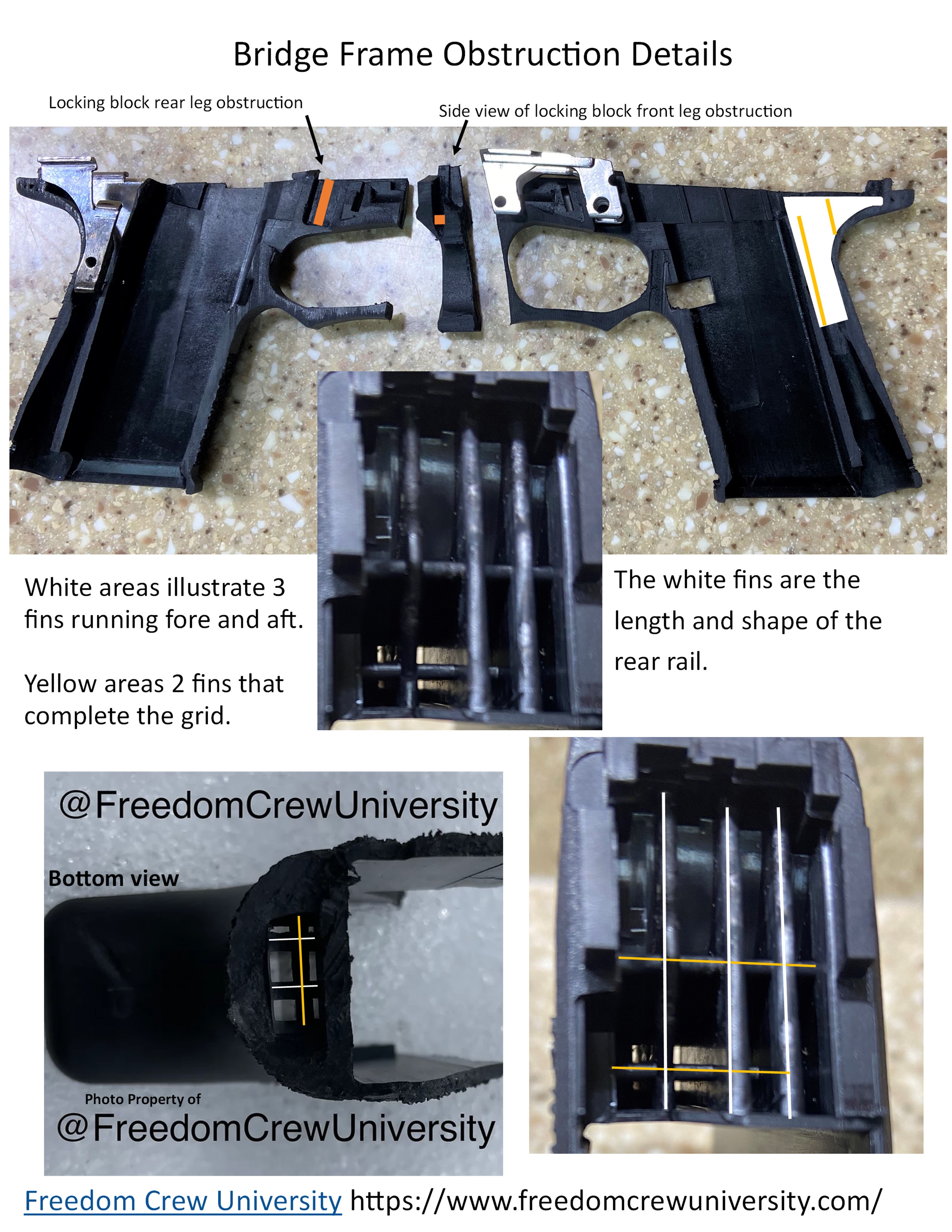

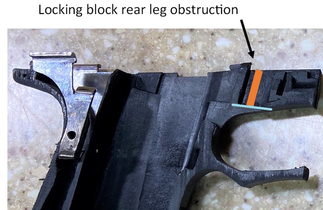

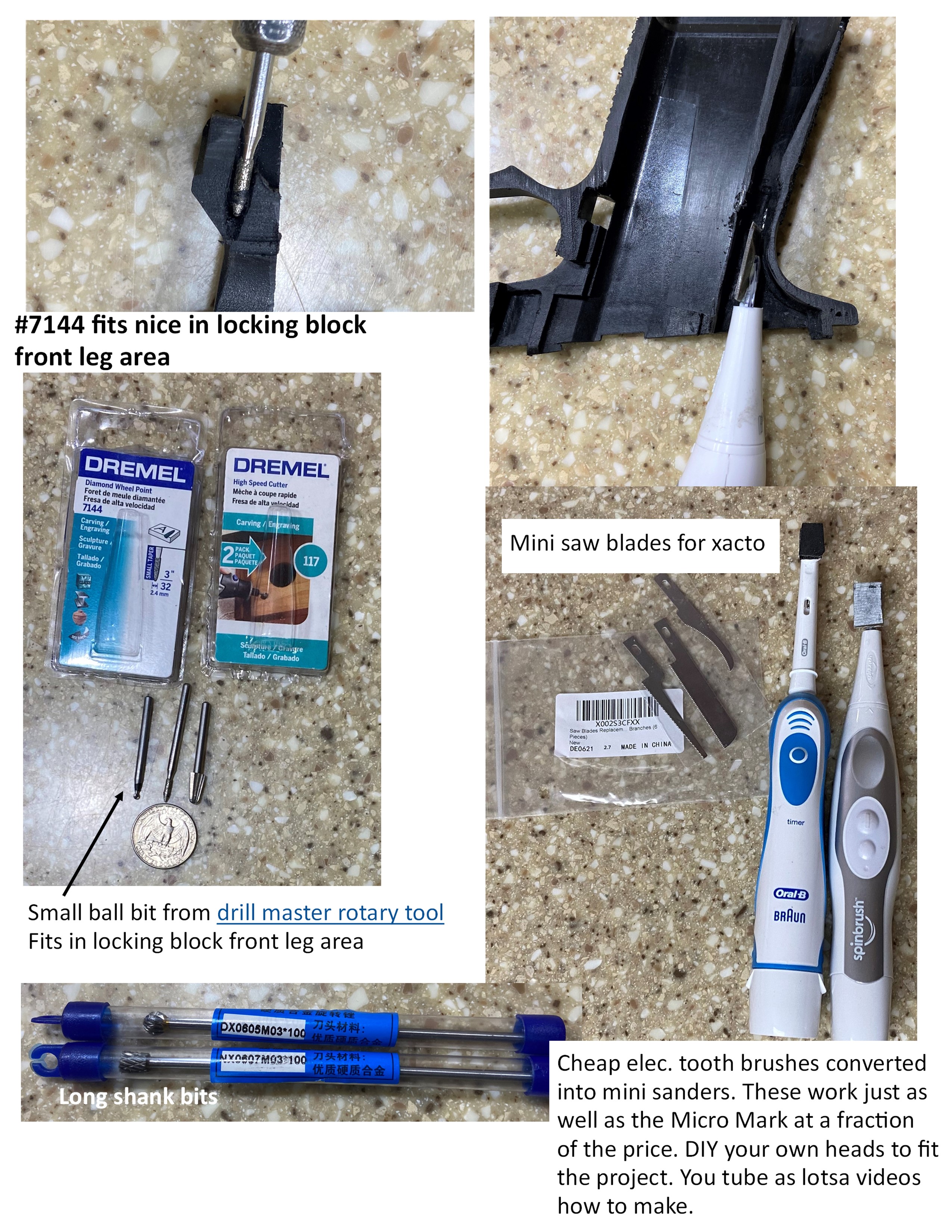

Front locking block obstructions were not difficult to remove at all. The back leg area- used the ryobi chisel to cut straight down then cut off from the horizontal platform with my diy 90* hot knife.
Front leg area of the locking block I used the ryobi chisel and Dremel diamond straits to clean it out.
The locking block fits so far, real test will be after I remove the tabs.

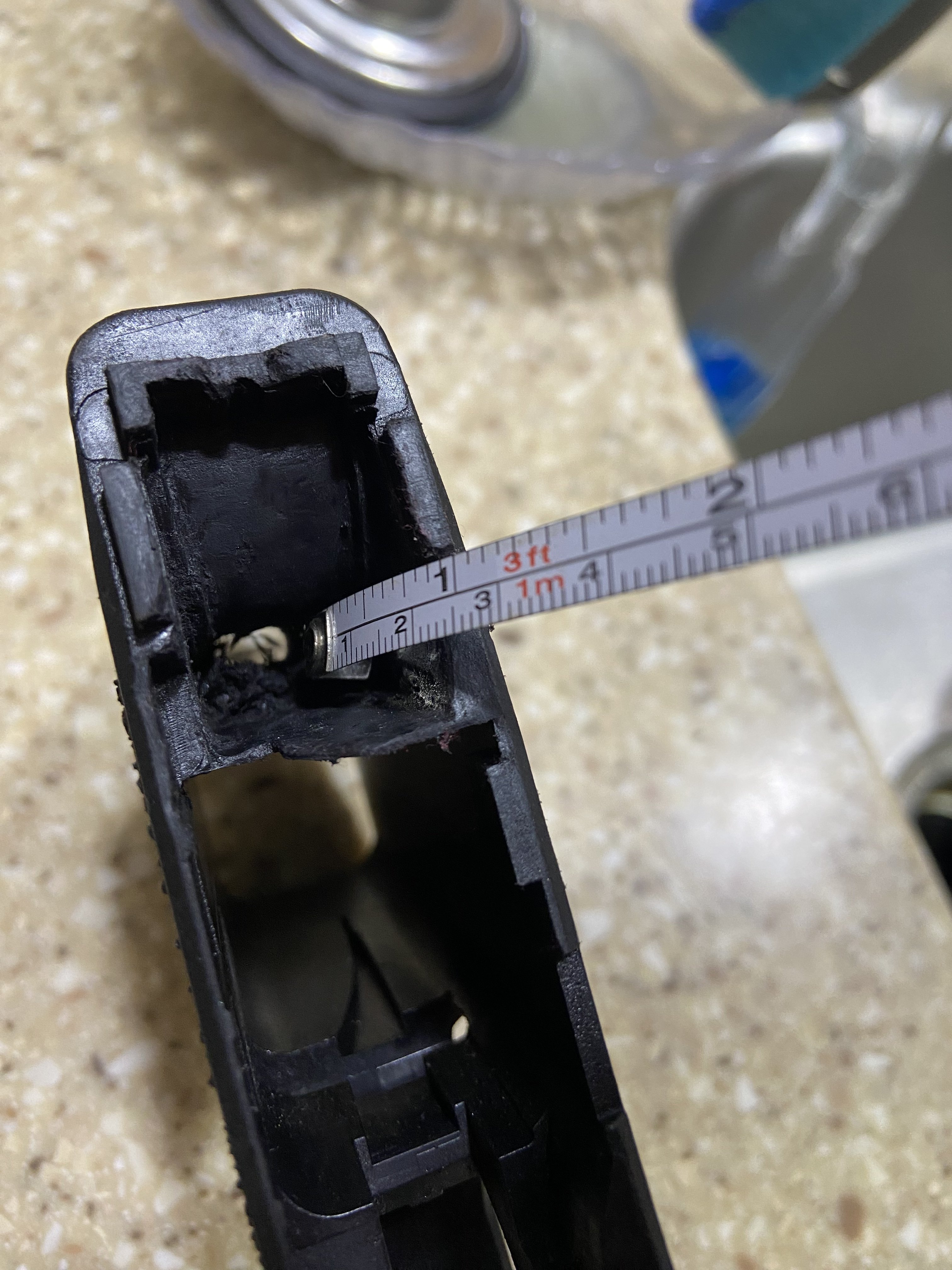

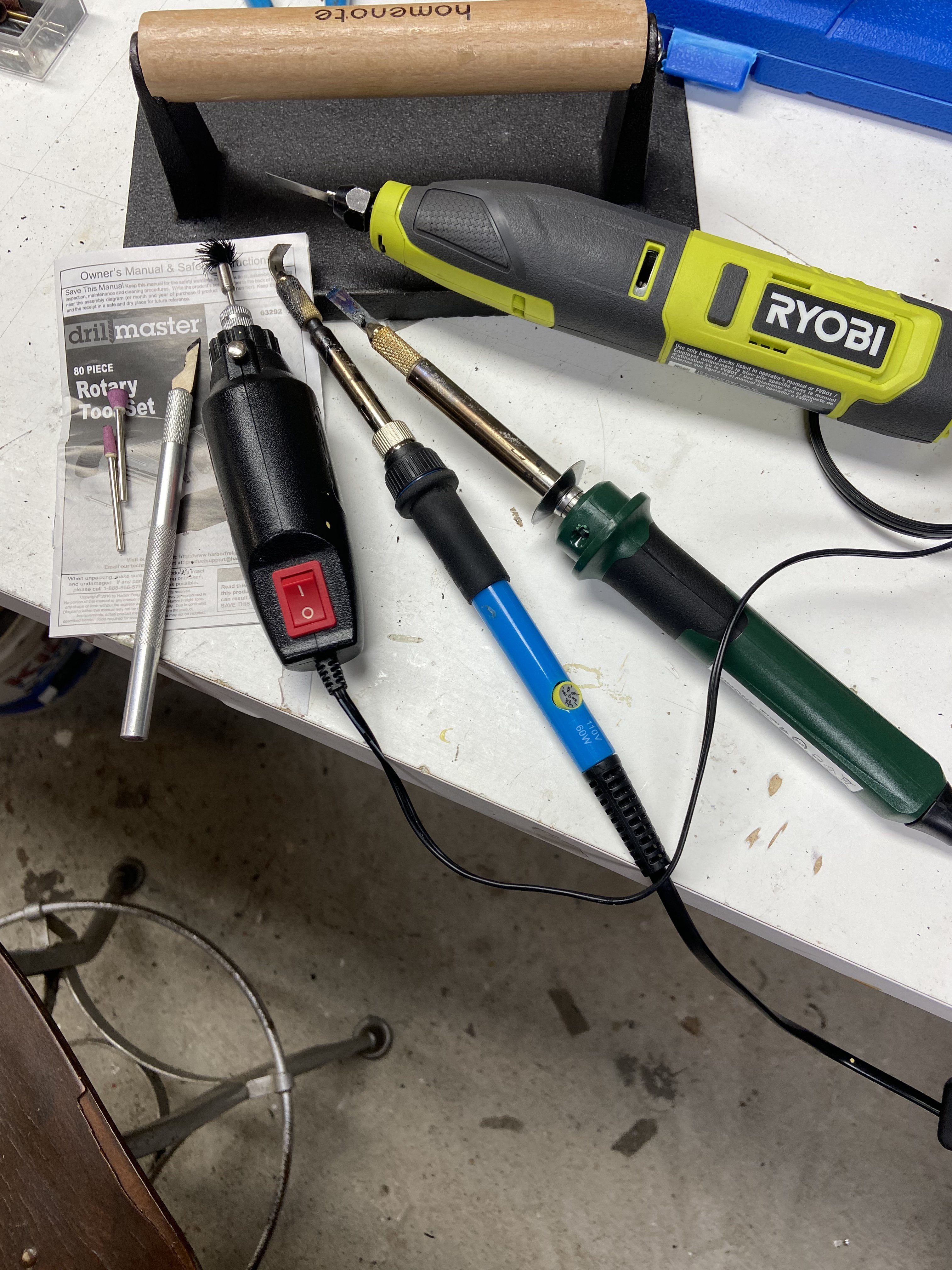

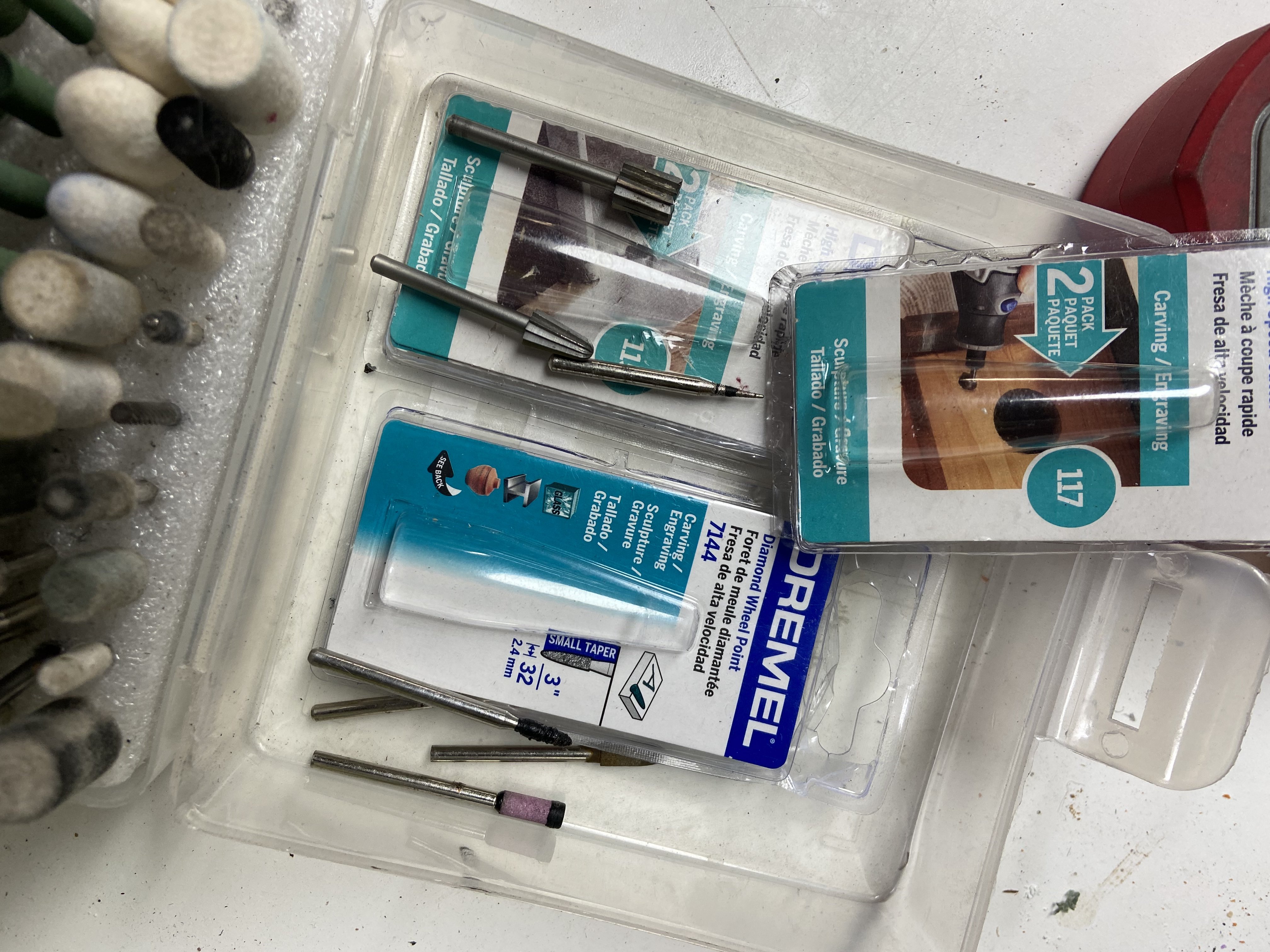

Tools used left to right: Drill master and pink grinding bits from harbor freight, x-acto knife, stipple iron 60W turned up to max temp, hot knife 30W turned up to max, ryobi chisel.
Dremel bits used.
This frame is definitely a challenge. Getting FTQ in the trigger housing area not so easy. I have definitely learned from the mistakes I’ve made. The hot knife is nice it works pretty well. Need the 90* to get a nice looking shelf for the locking block to set on. I also like the electric chisel it cuts fairly quickly in straight lines. I will use both tools on my next frame.

Roger that @GSW10 very helpful. I was fully stumped on how to get down in there.
With this info I will attempt to cut it out employing these tools with the straight blade.
The hot knife / stippling iron works ok but the shaft is hot. Easily melts parts unintentionally. In addition the knife is not as hot as I would like. Employing the X acto knife method the only hot part is the blade which allows more control of what is heated.

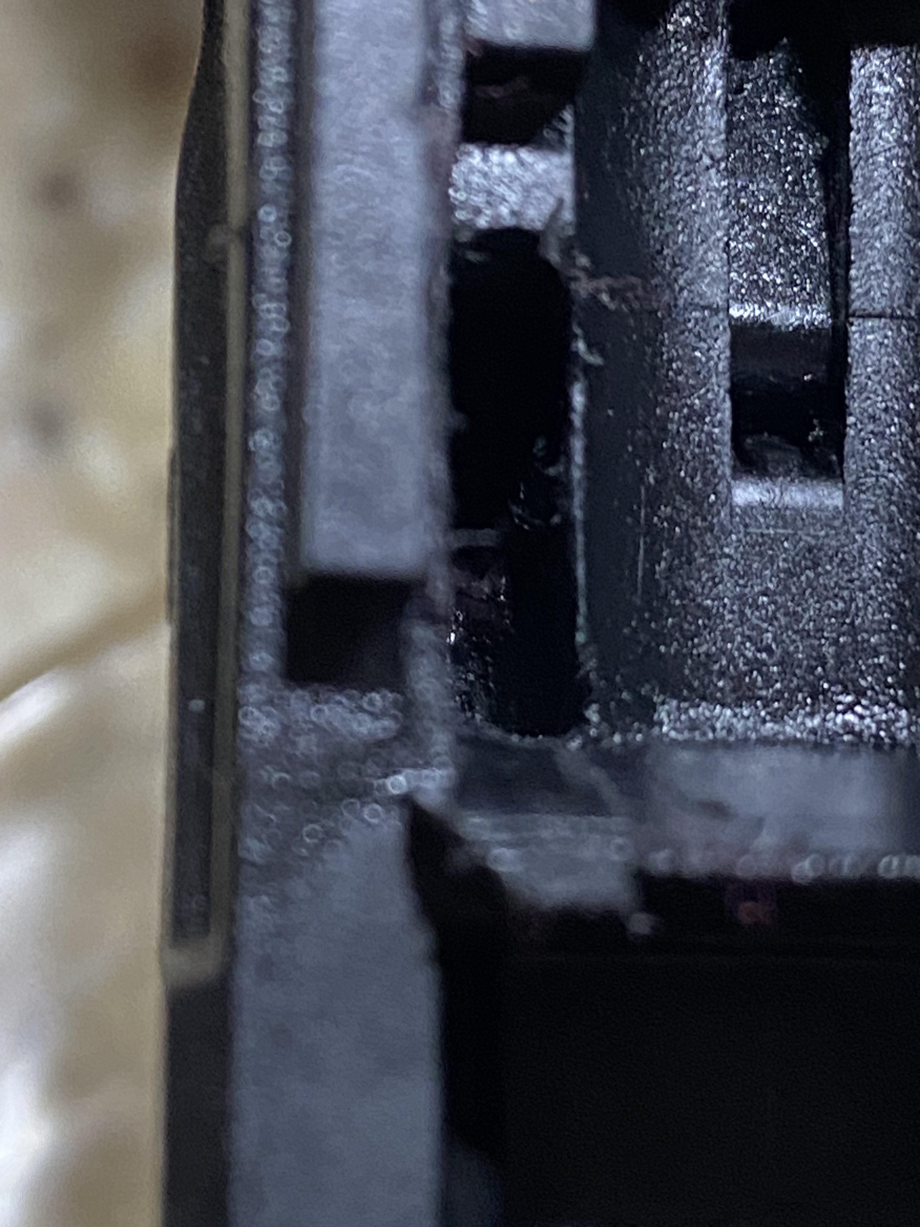

Cleaning out the bottom portion of the trigger pocket is impossible without tearing up the walls down there. Polymer 80 needs to revise this frame and make the grills stop just before the narrow portion. I hope I'm wrong but so far no one has been able to pull it off and make something presentable.

Hello Michele and everyone else. Sorry I haven't had time in the last few days because of work and ongoing doctors appointments.

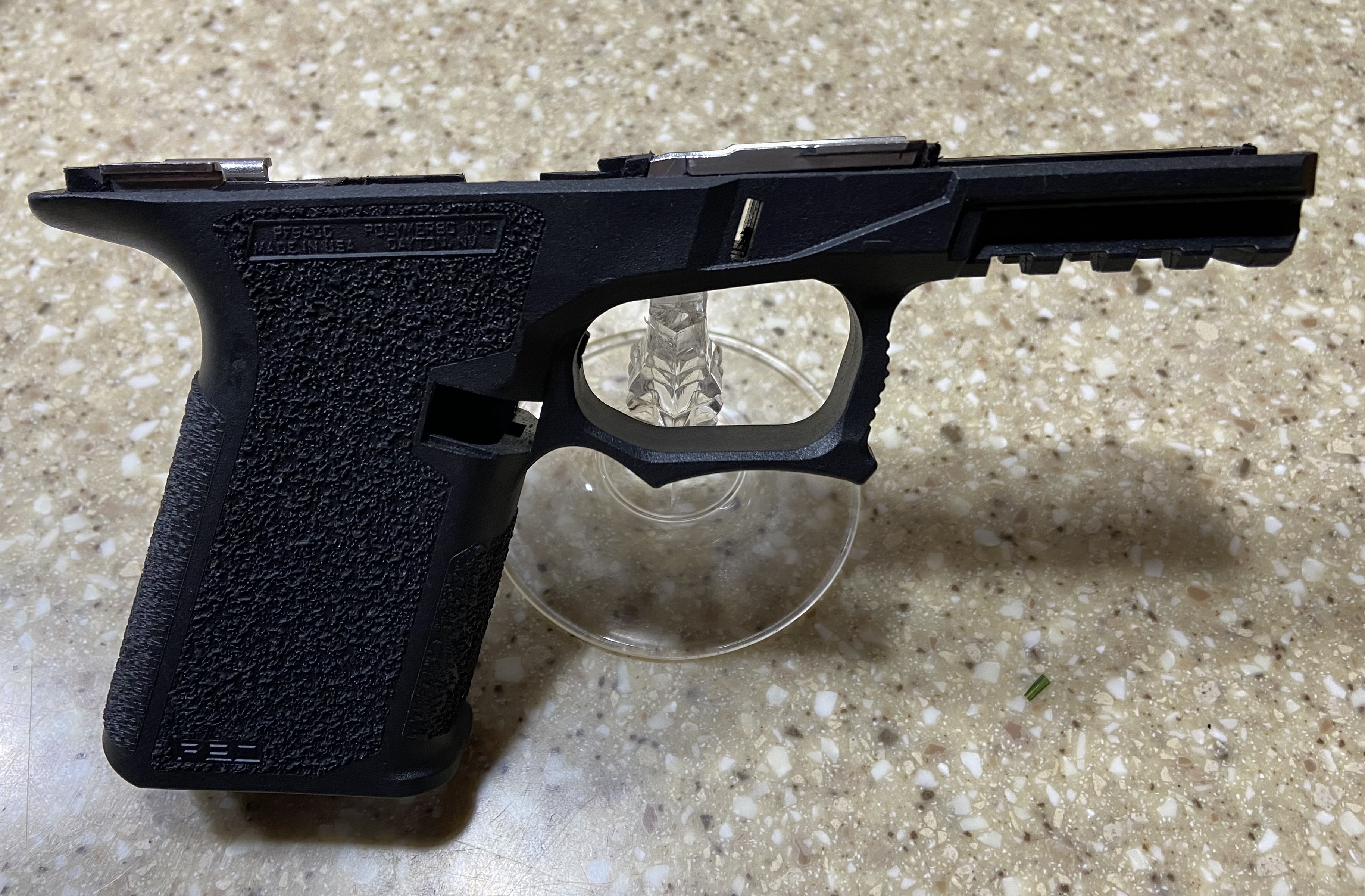

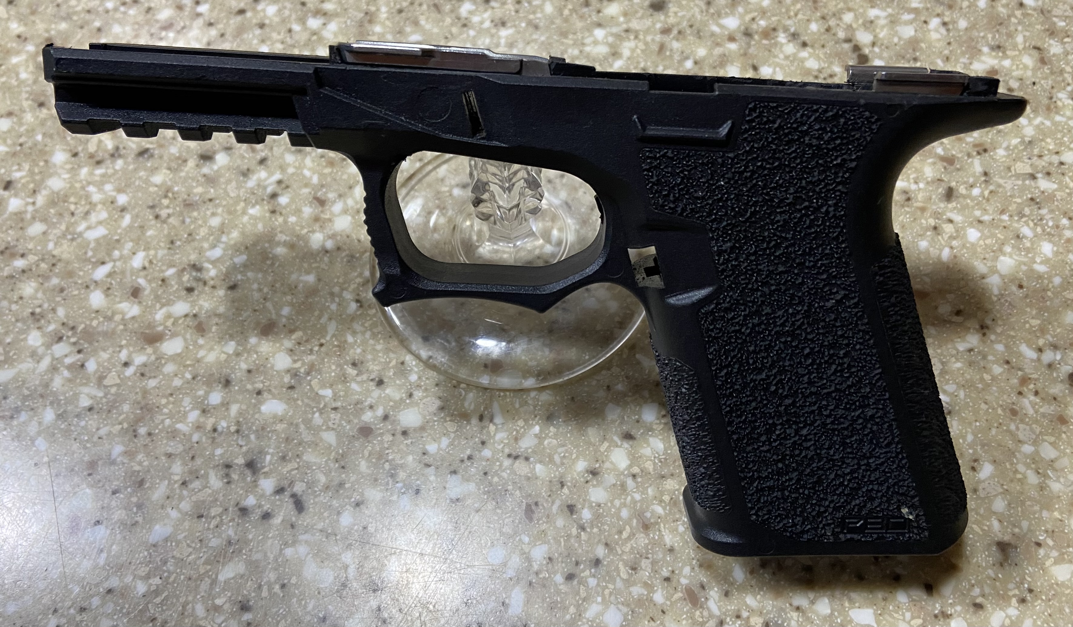

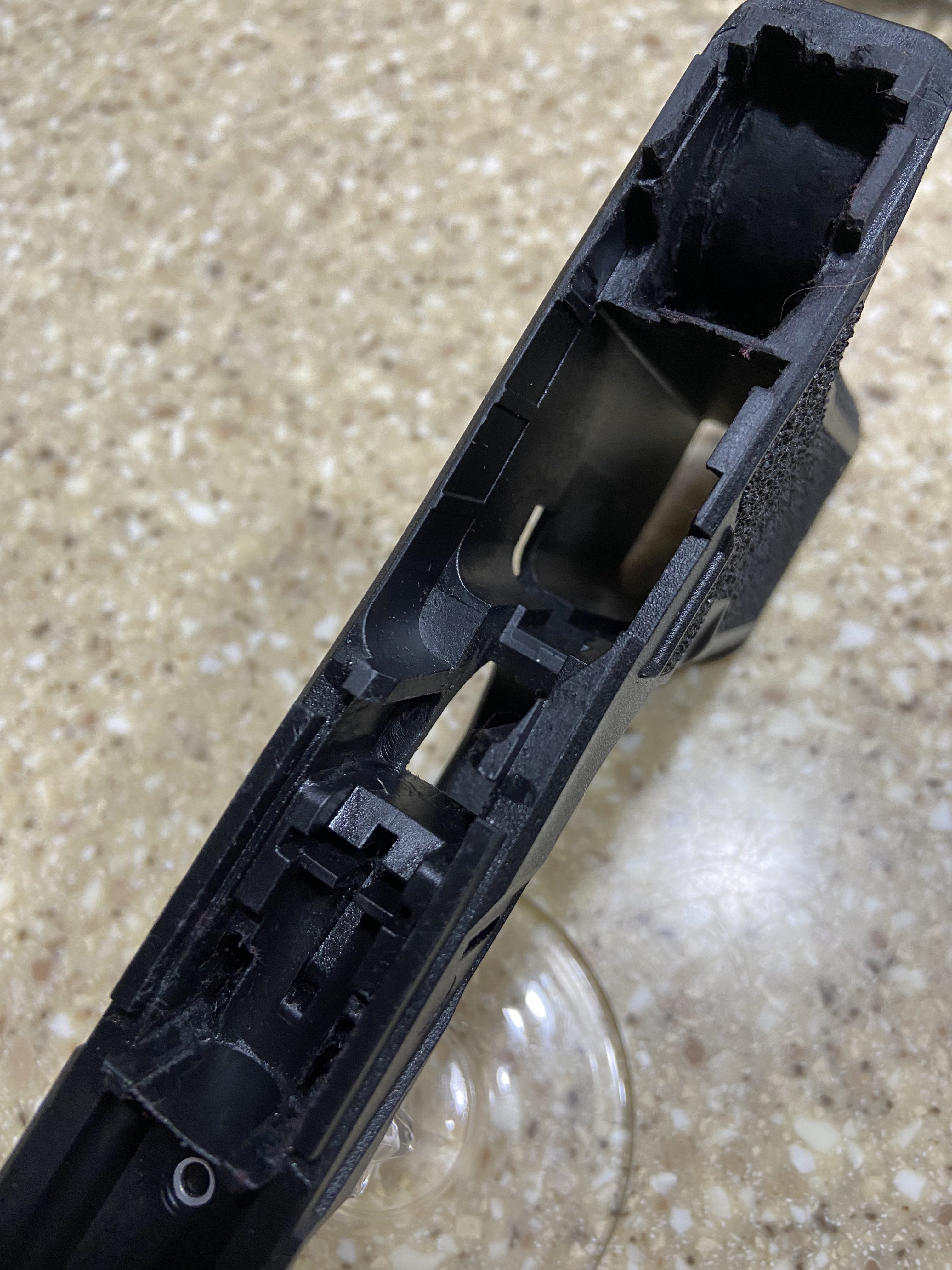

Here she is…..I could keep at by doing a few more repairs on the polymer then FTQ that trigger housing by sanding and polishing. Far as I’m concerned this one is done. I have no plans to build it out. Interesting experiment. I have another frame which I will start in a few days. Using lessons learned from this one, the next should come out better.

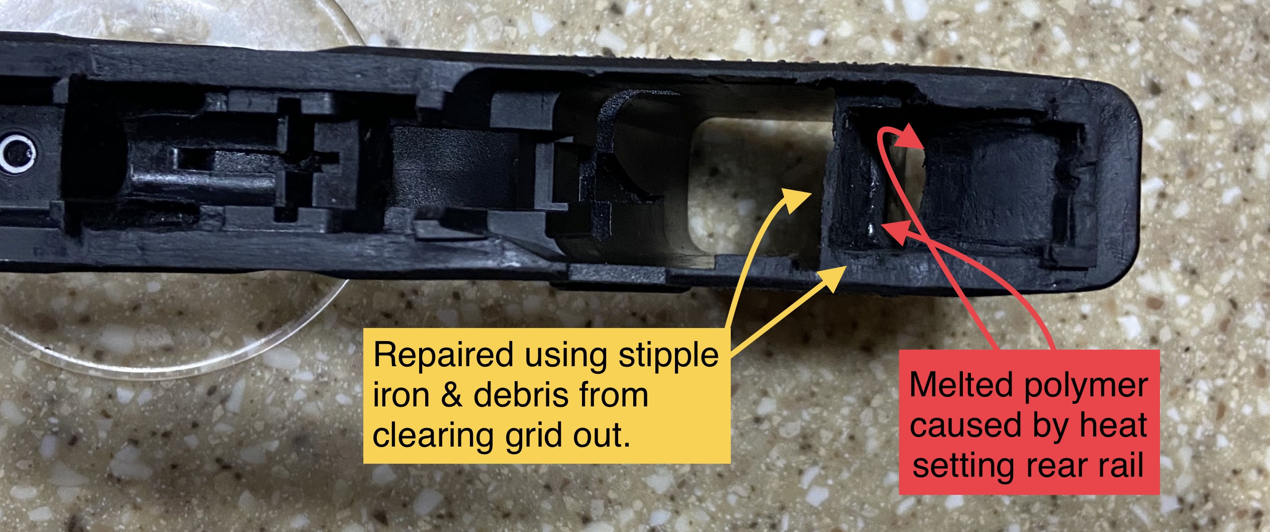

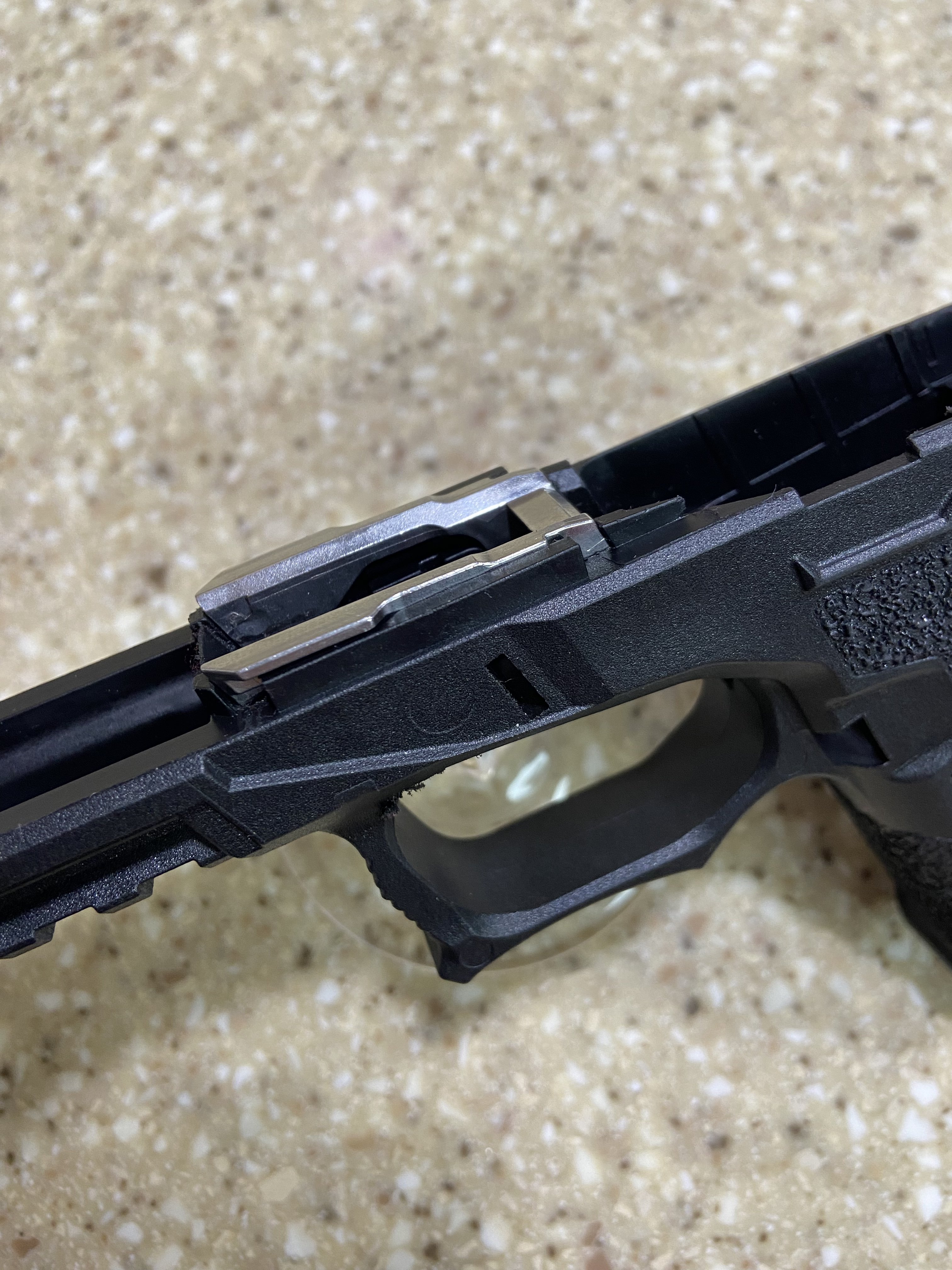

Both rails are seated down properly. The front rail wasn’t quit down fully. Was a hair high. I heated the the front legs with my heat gun a bit and pushed er in. The block went right in like budda and is set in nice.
Same with the rear rail. After cleaning out the lower area of the trigger housing the best I could the rail was high a good 1/16 inch. Instead of playing around with trying to find the high spots in “the dark cave” I opted for a hot press in. Heated the rear rail with the heat gun carefully slid it in as not to damage the surrounding polymer. Pressed it in, repeated again, It set down in nice on the 2nd try
Due to my lack of protecting the frame edges some areas were really beat up horribly. Damaged by the Dremel and melted by the hot knife or stipple iron. I repaired the 2 worse areas with material from the frame. Although it looks pretty rough here, most of it can be polished and more repairs can be done to bring this to a respectable look. However, I’m pretty sure this frame would perform fine as a weapon if completed as is.
Same with the rear rail. After cleaning out the lower area of the trigger housing the best I could the rail was high a good 1/16 inch. Instead of playing around with trying to find the high spots in “the dark cave” I opted for a hot press in. Heated the rear rail with the heat gun carefully slid it in as not to damage the surrounding polymer. Pressed it in, repeated again, It set down in nice on the 2nd tryView attachment 9883

Last post on this thread I'll start a new for the next frame and edit in the link. Hope I do much better with it. Attached a PDF for those that want a piece of paper :)

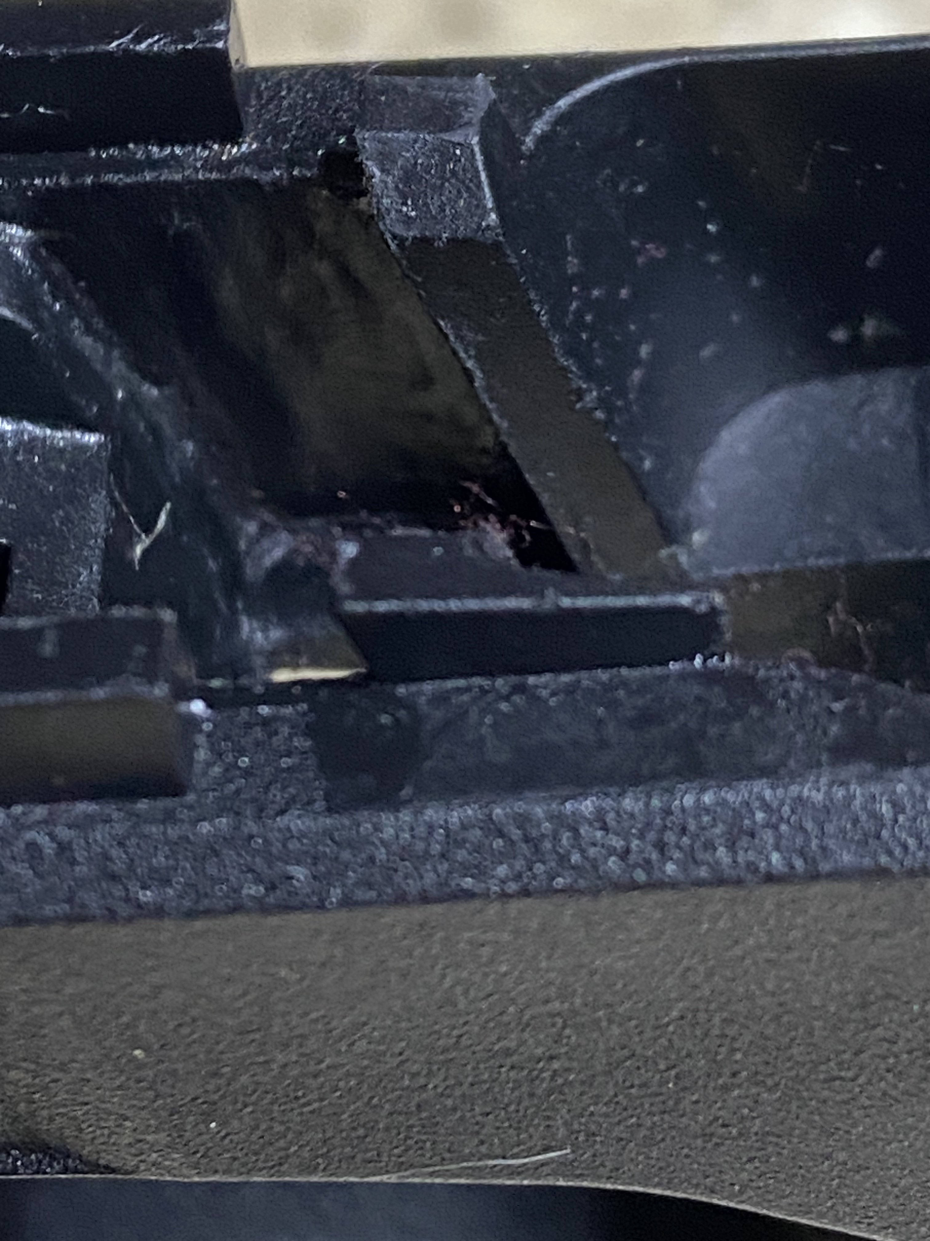

Here she is cut up so you can see what's happened in there.
Lessons learned:
  • Remove the center fin in the grid area of the rear rail before working on the sides. This will allow some room to maneuver to get the left and right grid sections out.

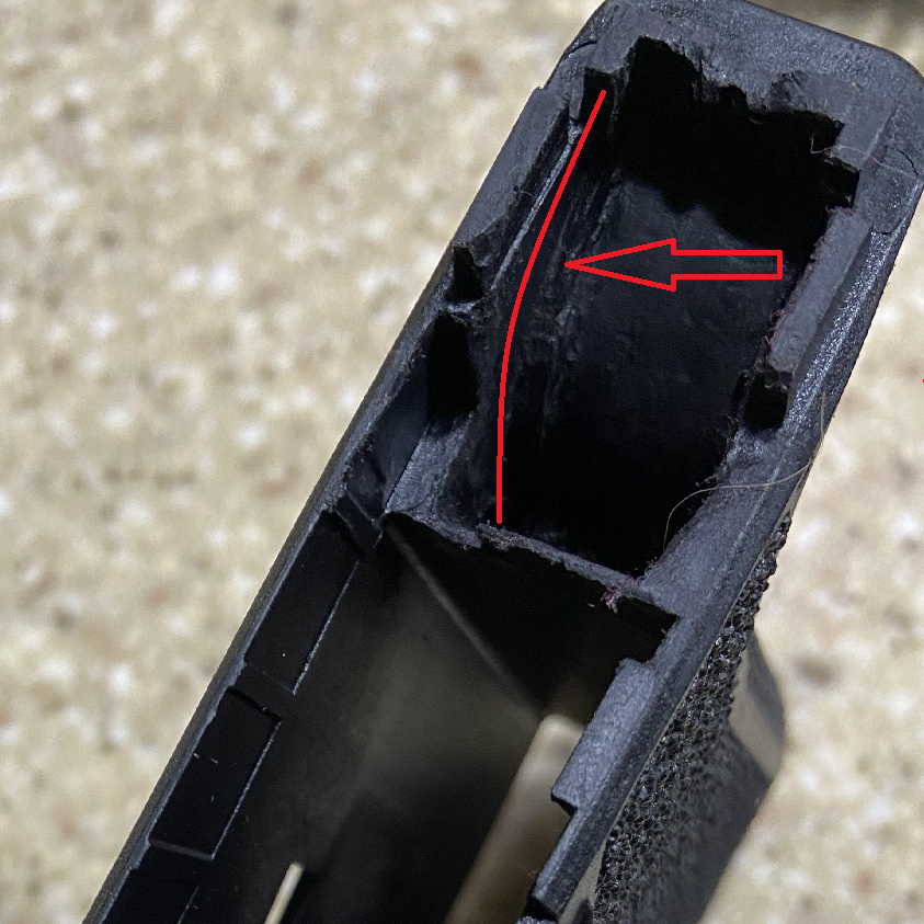

  • Snip or cut grid that is attached to the frame with a flush cut or straight blade before removing the bulk of it.

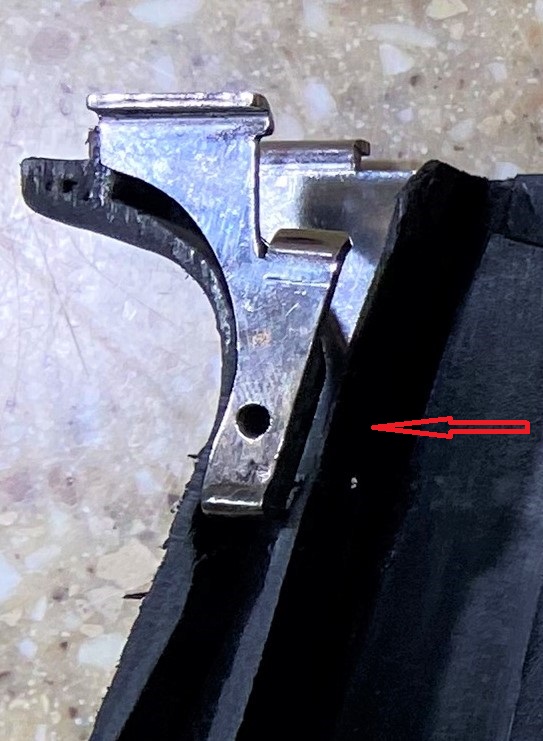

  • The wall, see arrow pictured, is thin and flimsy. Use caution when tooling. Its easy to remove too much, punch through with a razor or bend it out of shape with too much pressure.
  • Protect frame near work areas from tool marks. Tape works great. Its easy to grind/rub or cut parts of the frame, polymer is soft and easily damaged.
  • The obstruction at the front leg of the locking block is down in the pocket aligned where the pin hole would have been. See illustration. Use caution when tooling so as not to damage the edge of the channel. Cut away from frame with snips, xacto chisel or other straight type tooling.

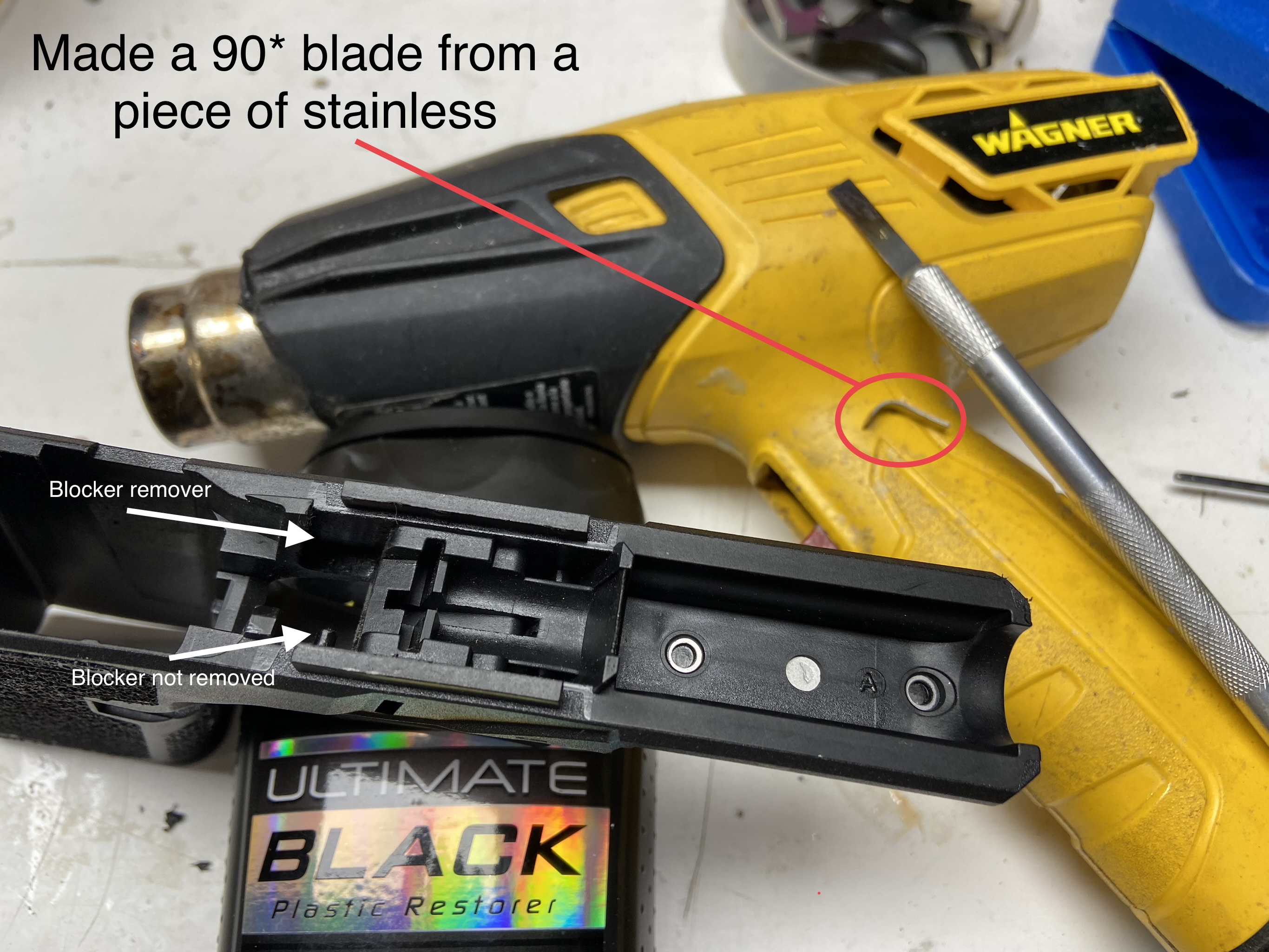

  • The obstruction at the rear leg of locking block is open and easily cut out with dremel, razor, xacto chisel blade or other straight tooling. Use caution and cut just to the rear leg seat (blue line). The seat maybe finished smooth like in LW freedom build. I made a 90* stainless xacto blade cutter used as a hot knife using heat gun to get it hot enough.
  • Hot knife easily damages frame. Heating exato knife with heat gun works well. 90* blade is available on Amazon. DIY blade is much less expensive and simple to make from stainless.
I did🤷
Cool. Do share! Let's see brightly-lit photos of the inside of the finished pocket. Also, how did you do it? Tools?
Lessons learned:
