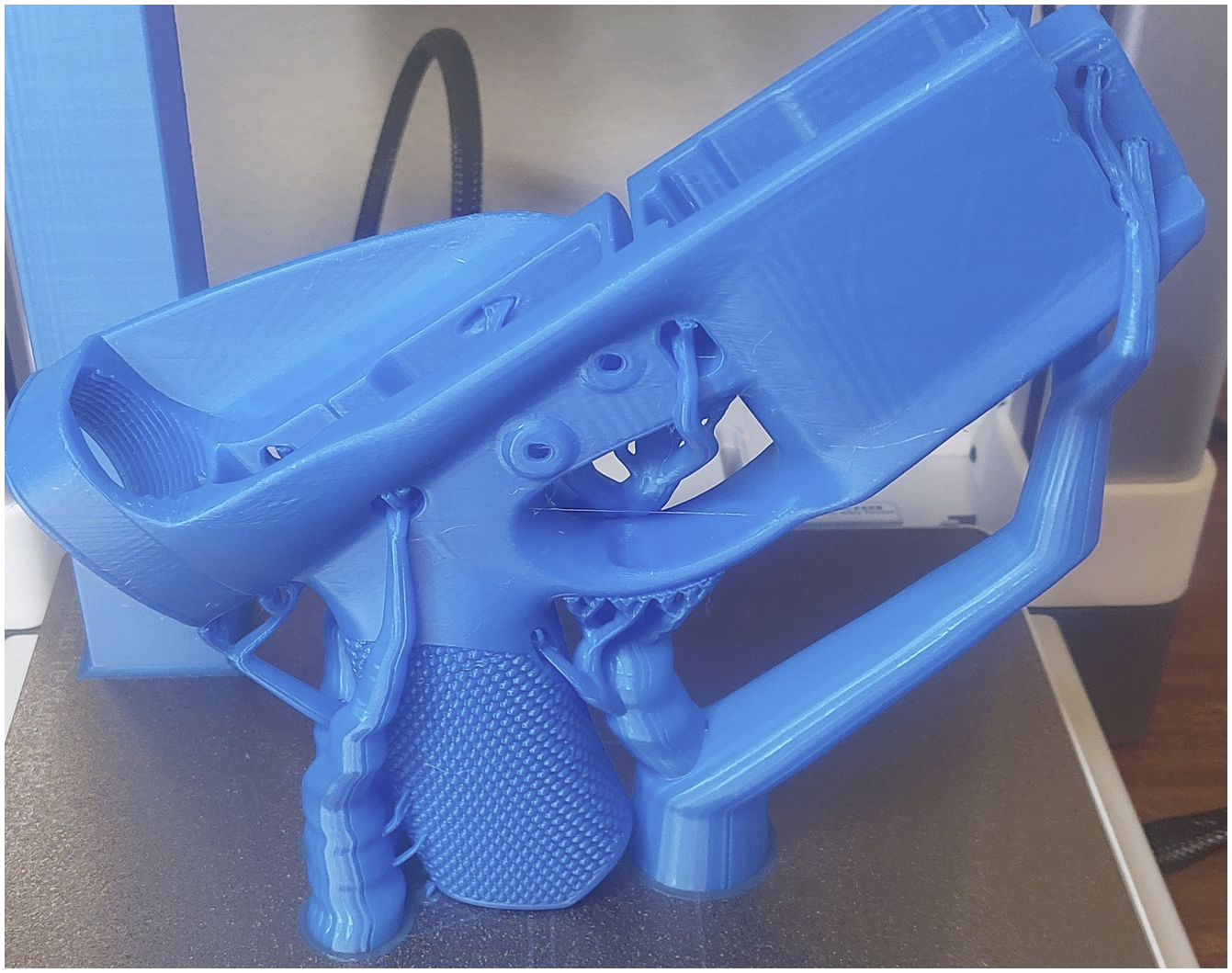

New printer, new filament, new build started
LOL, Not sure how into 3D printing you are, but some supports are referred to as "tree supports" so you aren't off base!
I haven't gone down that rabbit hole, yet. I'm familiar with the supports... and this particular case reminded me of a tree.
...this particular case reminded me of a tree.
The supports almost look "alien" to me. :unsure:
But they also look "natural", like the upper was "grown". Which technically, it was... :) Soy-based lowers, anyone? :D
So, guns really do grow on trees!
