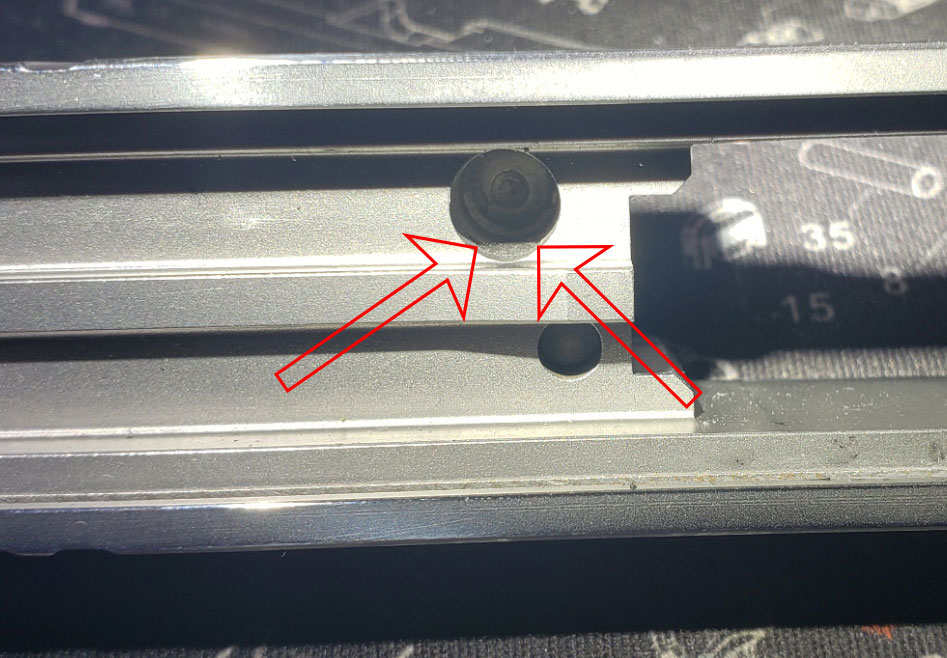

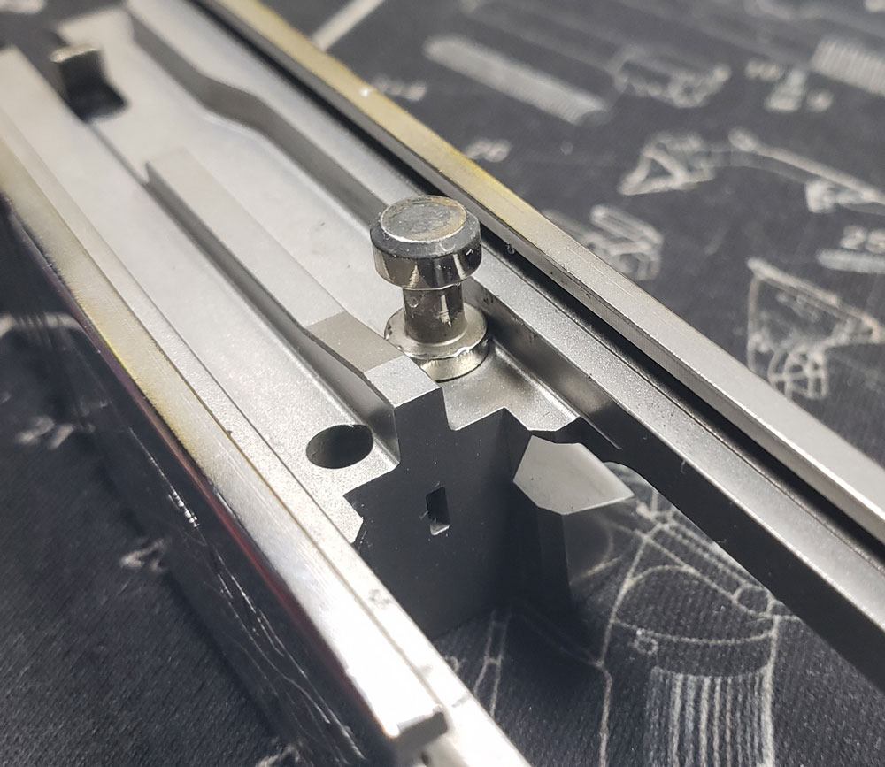

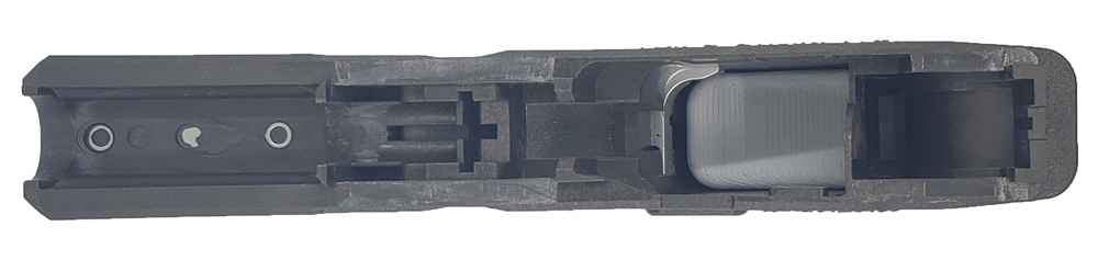

First step... insert the extractor and firing pin safety plunger, right? Except the plunger will NOT go into the slide. It drops in this far without any resistance and then comes to a halt.
It's not that it's "tight." It's BLOCKED. By this ridge (seen here at the bottom of the hole in the next photo below). It drops in freely a couple of millimeters and the runs into this machined flat spot.
The only way a plunger will go in there is if it had a "flat" or "facet" on one side. The hole machined into the slide for the plunger is not completely round. It's got a flat on the side towards the center of the slide.
Is it possible this slide is not a Gen 3? Requiring a different safety plunger? And as such... incompatible with... well.... a P80 build?

OK... I AM an idiot... or living in the Bermuda Triangle or something....
It just dropped in as it's supposed to. I don't see that ridge there anymore. It's gone! LOL! I swear!
I must have not been "holding my mouth right!"

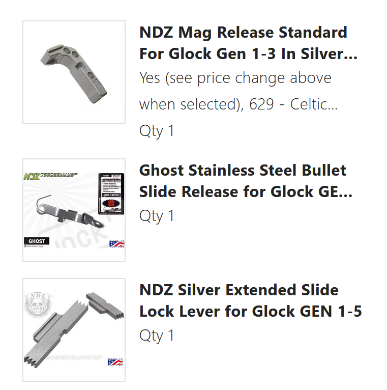

I will be interested in your opinion of the extended slide lock lever once you get her running. I've been looking at a few of those from NDZ but haven't pulled the trigger.
I actually prefer a standard length. But I couldn't find one in silver / stainless.
Just interested in seeing if it works and doesn't hang up on shit too much. The standard size can be a bear sometimes for these cobbled fingers. I also want the silver stainless look because it matches the stainless barrels. NDZ was sold out of that model about 6 months ago and I haven't checked back because it hasn't been a priority.

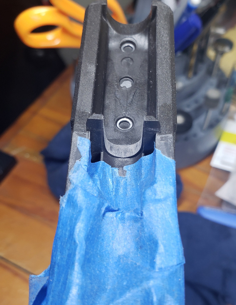

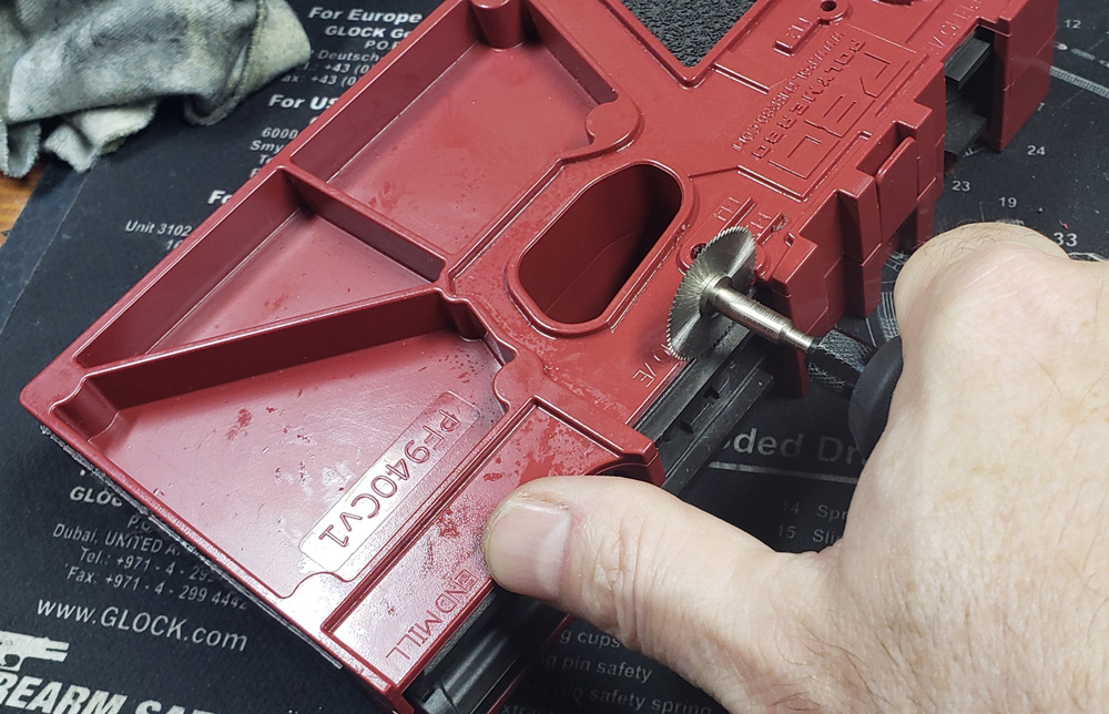

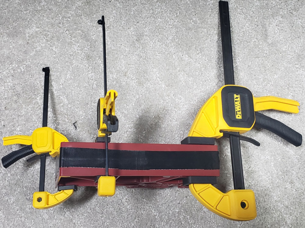

I just got through drilling the holes, removing the tabs, and the RSA channel obstruction. Am I the only one who gets nervous drilling the pin holes? So much is riding on that, it gives me a bit of anxiety. Funny... since my first build my pin holes have been perfect, so I don't know why I get nervous. But I think it's because intellectually I know how important it is to get them right!
I haven't polished any of it, yet. Took me 3 hours to do just this much. I'm getting faster. But nowhere near the "Biden P80 Standard" of 30 minutes soup-to-nuts! I still suck.
Here are some progress photos!

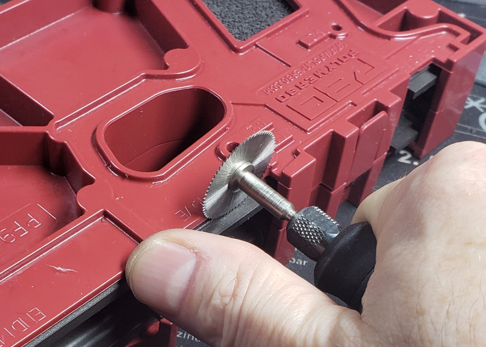

Clamped the jig shut and then taped it before going to the Dremel Workstation for pin hole drilling.

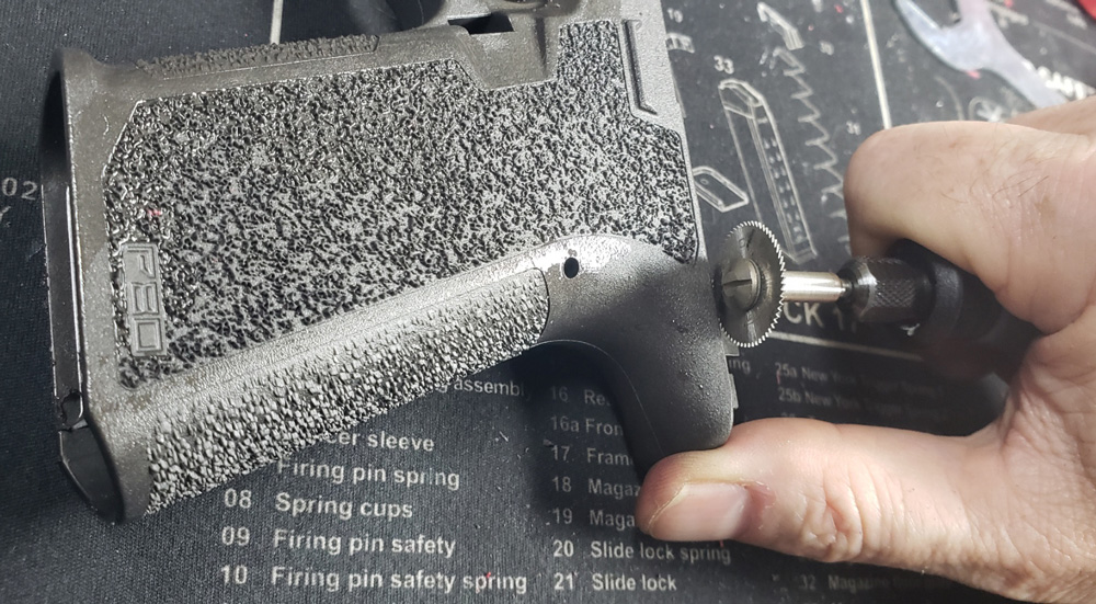

Holes drilled. Next are the tabs. I used my cutting wheel or "circular saw" again. The front rail tabs I did with the jig on and the larger diameter saw.
I did the rear rail tabs without the jig and used a smaller circular saw.
Then I finished the rail tabs with my Micro-Sander. Love that thing!

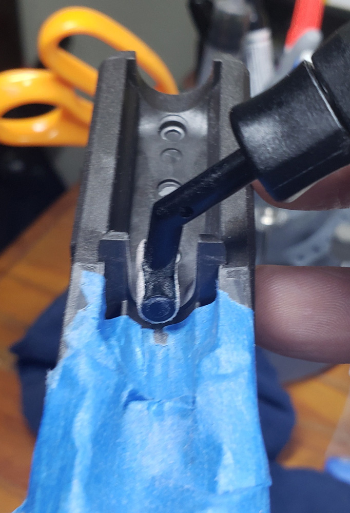

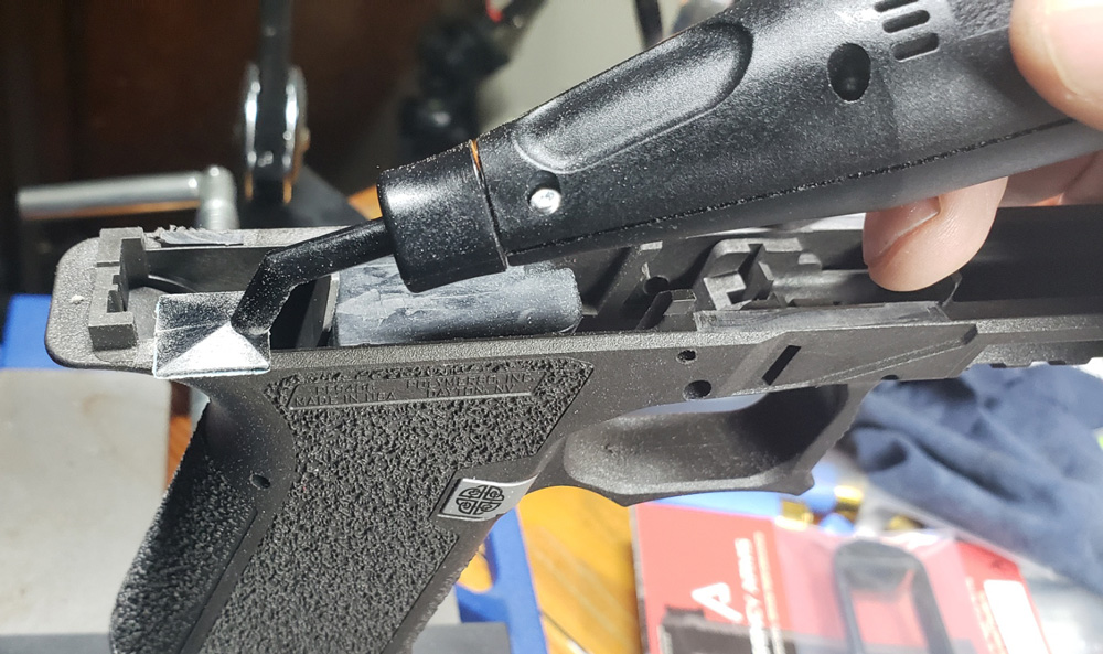

I removed the majority of the RSA channel obstruction with the Dremel and a coarse bit. Then it was off to the races with the Micro-Sander. Except it's not really a race. It's almost painfully SLOW! But that's actually a good thing, and it leads to an FTQ result!
Here it is, not quite there. But, look how cleanly the micro-sander cuts!

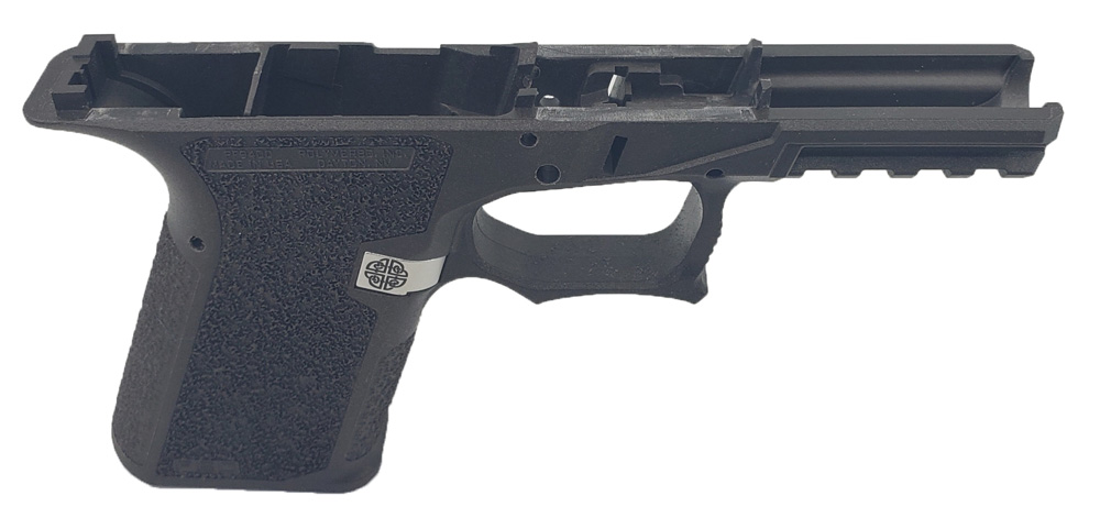

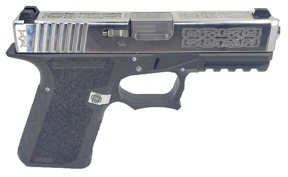

Here's the frame... "rough cut." I've still got a fair bit of polishing to do.
I'm digging the "Cobalt" frame color.
And here it is with the slide just sitting on top of the frame. Oh, baby!

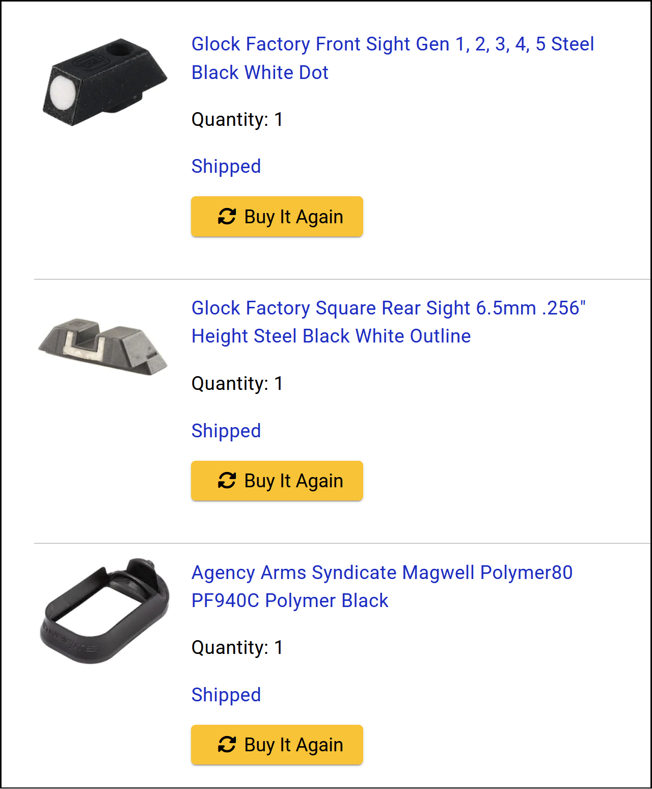

I also installed the standard Glock steel sights. The front sight overlaps the etching a bit. Not sure how I feel about that.
