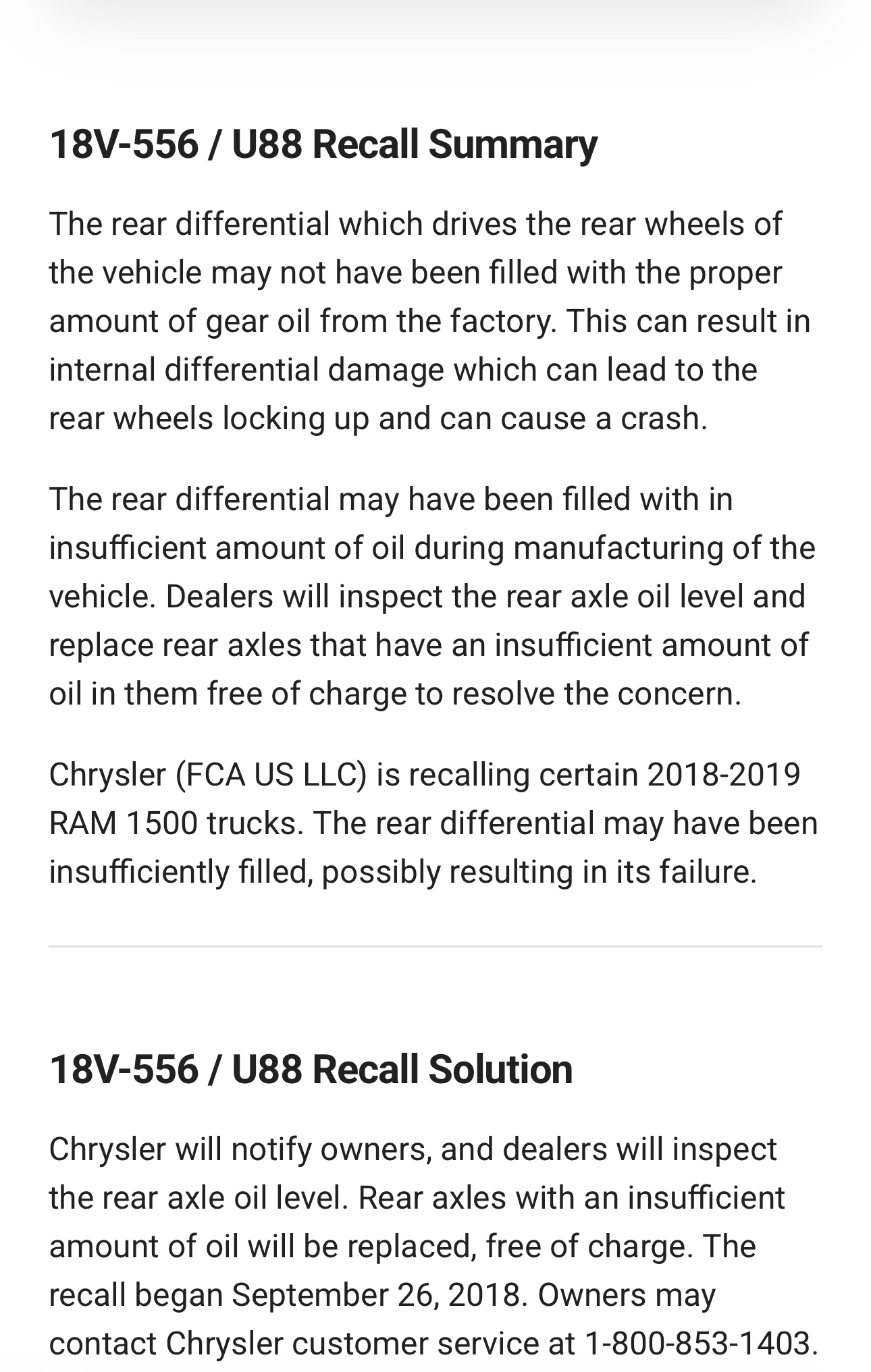

Without doing the research, I wouldn’t be surprised if there are many other owners suffering from the same fate on their TRX. Massive hp, heavy 4wd vehicle, big tires, stuff is going to wear. If the manufacturer did not put in durable enough components that were upgraded for a vehicle like this, things will break.
Did a quick search and it seems there are a bunch of TRX owners with differential issues. Not applicable to the TRX in question, below, but makes you pause and think this may not be a customer issues. How many warranties were denied because a tech said it was abuse but turned out the factory did not put enough differential fluid in at the factory.
