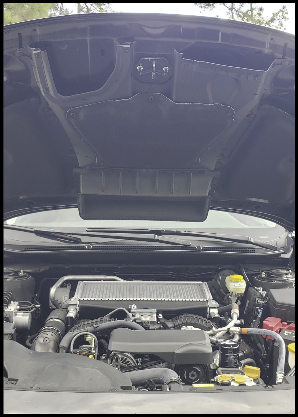

I like the setup on that car with the oil filter drip tray!
Yeah... only about a teaspoon of oil leaked out when removing the oil filter. Easy to wipe up.
Charge cooler is fed by a hood scoop?
Yes, but it's integrated into the front of the hood.

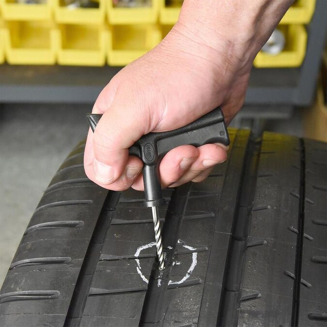

Don't know if you have seen these before but: Dynaplug® Pro Xtreme
Way better than auto store plug kits. Only good for nail and screw size holes but that is 95% of my punctures in the 10 years I've had this tool. If Dynaplug can't do it, you probably need a new tire anyway.

I don't like the plug kits because you have to make a big ass hole for the plug. This one follows the path of what punctured the tire, no enlargement required. You do have to pay attention to the path of the nail when you pull it out.
I've had a tire go 40,000 miles with one of these in and it didn't leak. Ideally, you should have it patched at a tire shop at the next opportunity. Plug and patch is supposed to be the best.

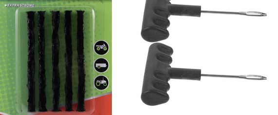

Maybe with the fancy kit bkbrno linked to but I'm talking monkey turds. They used to be brown, hence the moniker. I've probably used 100s, if not 1000s, of them in my lifetime, especially when I was an auto tech and tire jockey at a gas station. Nowadays, they are for near end-of-life tires that tend to easily get punctured by a screw or nail. Newer tires are more pliant and don't seem to puncture as easily.
View attachment 17857 View attachment 17859

The beauty of the Dynaplug is that everything you need to plug a tire is in one spot and the tool is no bigger than a medium sized screwdriver.
You don't usually have to remove the wheel.
The needle and plug is about the size of a 16d nail. You don't have to ream a big ass hole to get the plug in doing more damage to the tire.
It's quick and can be done on the side of the road.
If I catch the nail soon enough, I can pull the nail and plug it without loosing more than a couple of pounds of air.
It's made in the US of A
Nothing wrong with monkey turds, just this is a better tool that covers 98% of punctures
